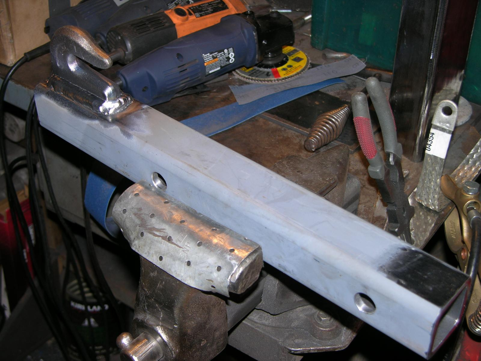

RFB, that'll DEF work better than any jumper cable clamp I've seen - also, even that type can benefit from the braided battery strap trick, that was especially noticeable for my MIG machines... Steve
   / Miller Thunderbolt AC only stick welder refurb questions #13
Novice here. That braided battery cable - a part of the braided portion is clamped between the live side of the ground clamp and the work to make a more perfect connection? Or???
   / Miller Thunderbolt AC only stick welder refurb questions #14
Bingo; what color kewpie doll would you like? Just kidding, I tried finding Jody's original tip, site's changed a lot since I last visited.
My small table has a corner I added angle to, mostly for vise mount - you can see the strap just behind the mig pliers, and the ground clamp just behind that. And yeah, the idea is that the braid conforms to whatever uneveness there might be on the table OR the clamp. Works well on the relatively thin angle OR my 3'x7' x 1" thick bigger table.
I also take the vise off its swivel base and shine things up once in a while, since quite a few jobs I just let the vise be ground - BTW, the piece in the vise is one of a pair of inserts I use on the loader bucket where I have 7 different 2" receiver locations to choose from... Steve
