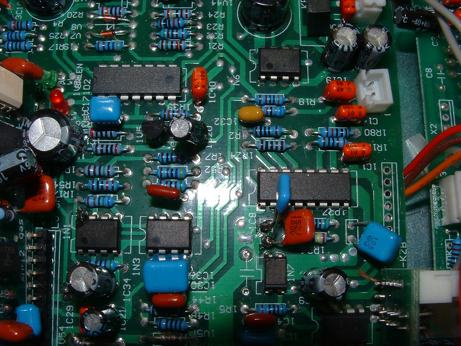

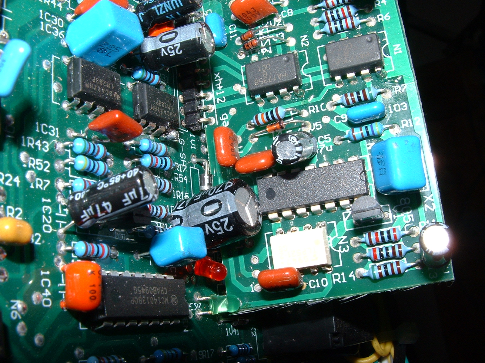

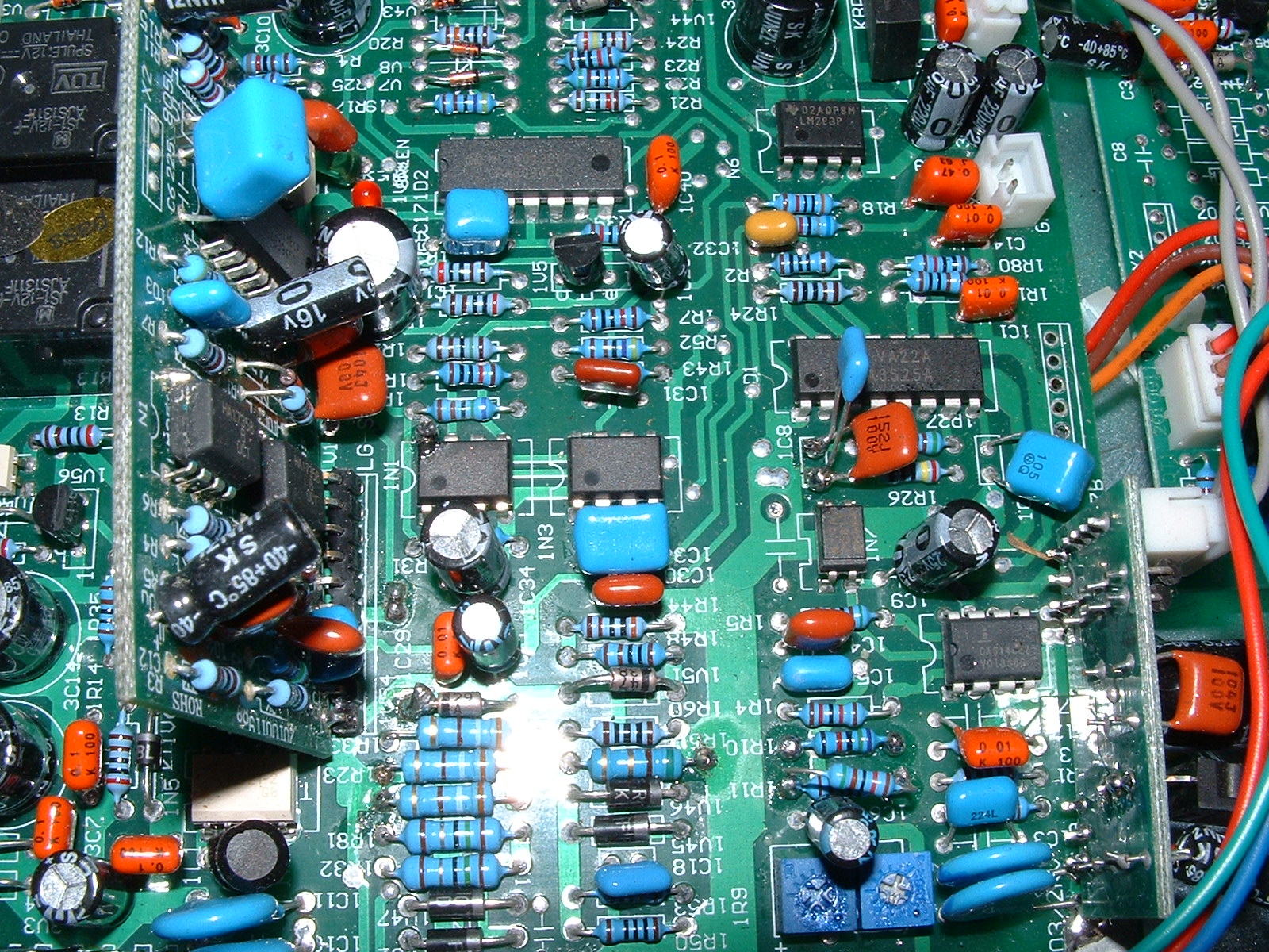

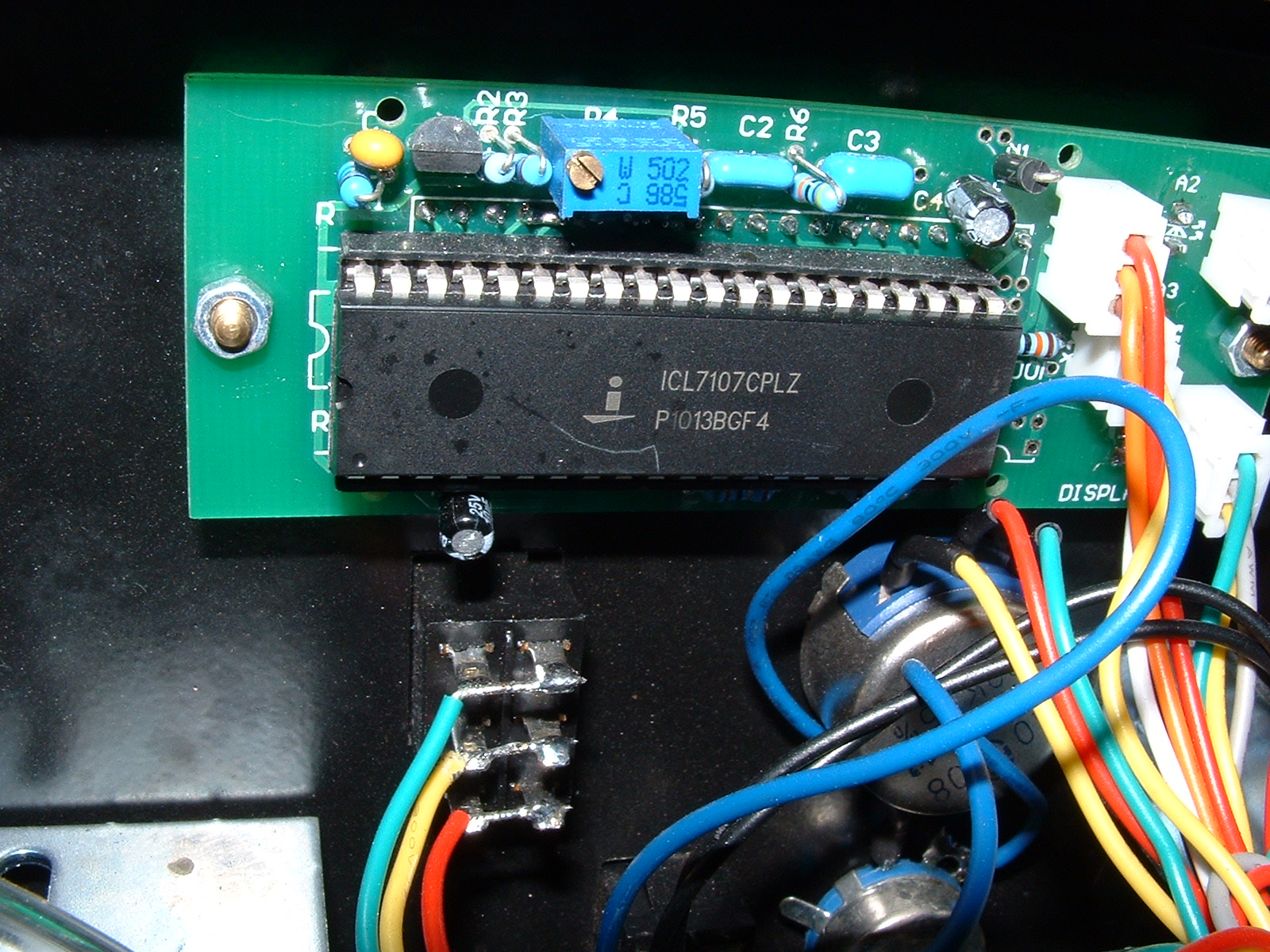

With the question about parts and kinds used, I thought I post some pics from a PowerPlasma 60 unit that I have. Pictures and lighting aren't great. I took them in a hurry to get them up.

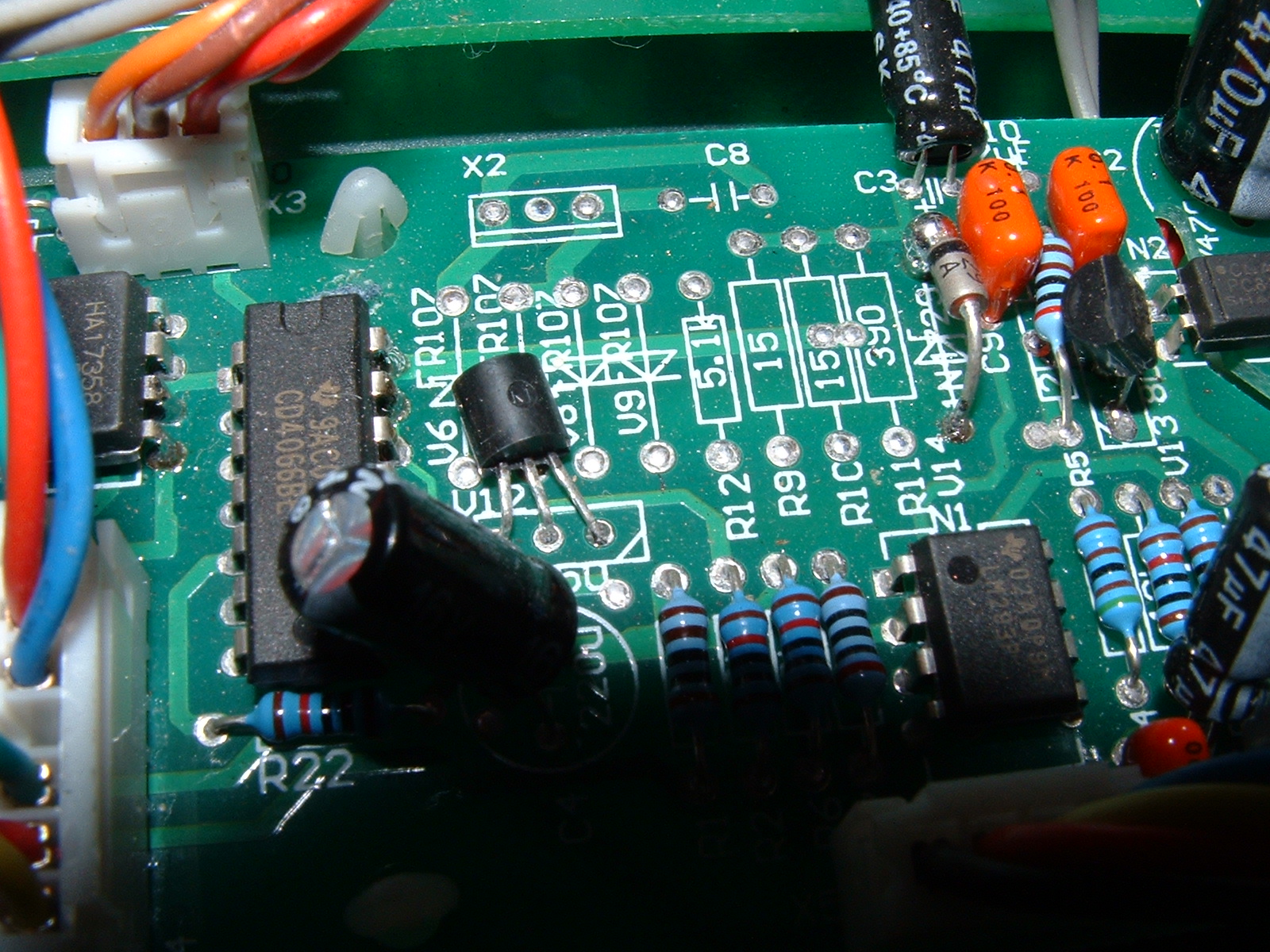

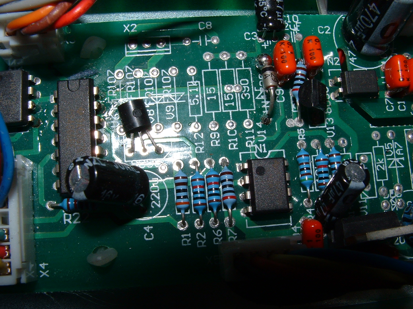

Here are a few more:
Mark, sorry, I think you did yourself a disservice by posting those pics. When I look at them I see very crappy workmanship. Capacitors soldered on top of capacitors, everything looks to be inserted by hand and a lot of hand soldering, areas of flux still on the board (will lead to premature failure). PCB assembly and soldering is one area where "hand made" is not better. This PCB would not be acceptable to any respectable electronics manufacturer/assembler.
I think you've made our case. Sorry about that.
