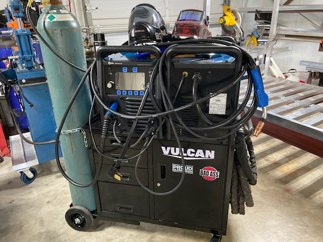

Can't go wrong with a Miller. I had a old Millermatic 200 Mig I bought over forty years ago for $1375. I recently purchased a new MillerMatic 255 strictly for aluminum mig welding. I liked it so much I sold my old 200 mig to make room for a second MillerMatic 200 for metal work only. I sold my old original MillerMatic 200 mig for $1300 over 40 years from the original purchase date!! I had multiple buyers after it. That should tell you something. Parts and supplies are everywhere for Millers. They pretty much are the standard for competition.
