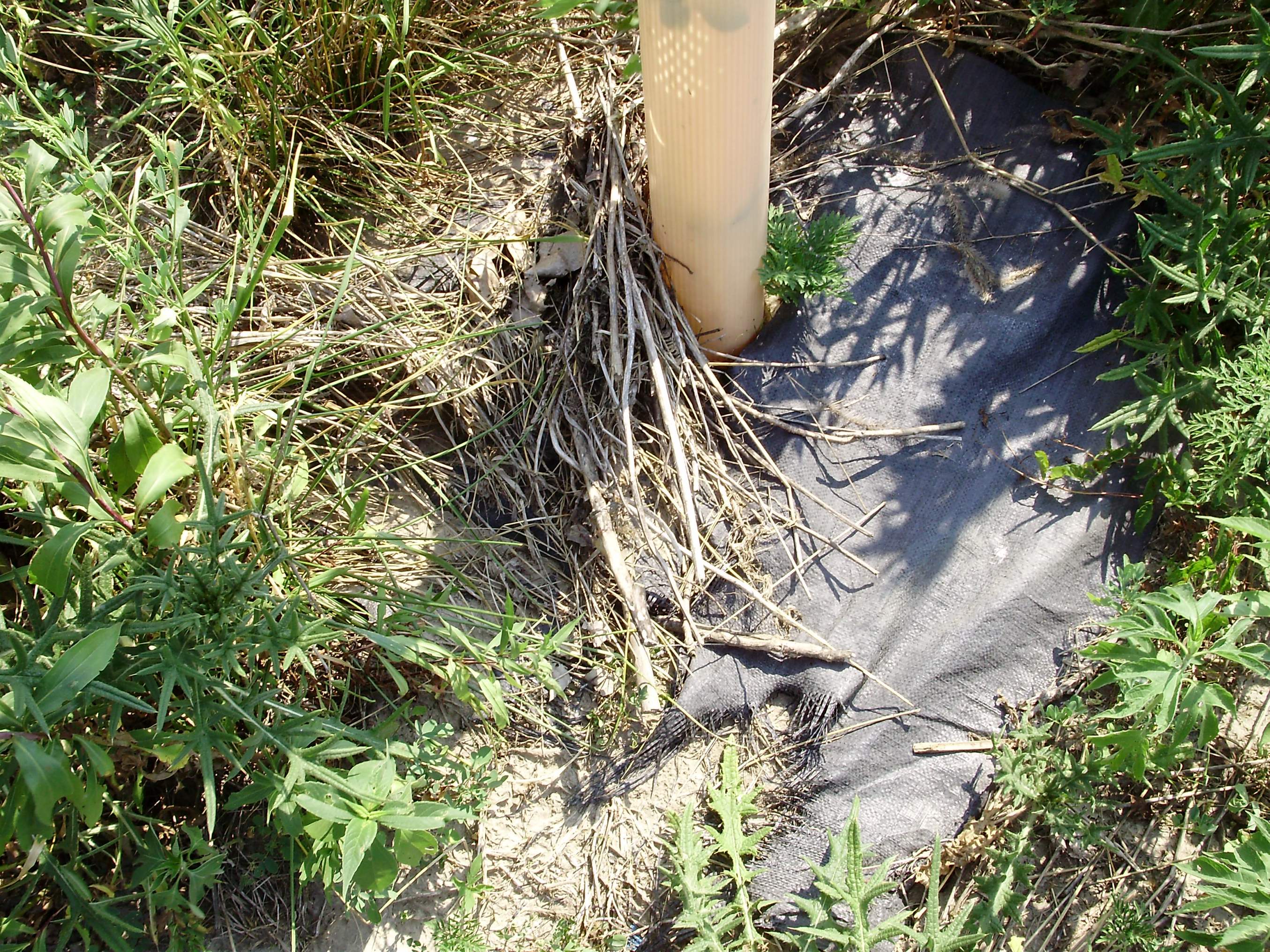

I did go with the tubex, they were more but from Tubex Tree Shelters, VisPore Tree Mat, Rigid Seedling Protection Nets/Tubes They have the rounded/flared top to help keep the trees from rubbing.
I researched a ton of tubes and thought these were the best. Many of the trees i bought (from lawyer nursery) were larger (3-4')so I wanted to make sure they were protected. The blue-x are so-so, cheap have held up but I would not trust them for the trees I spent more money on.

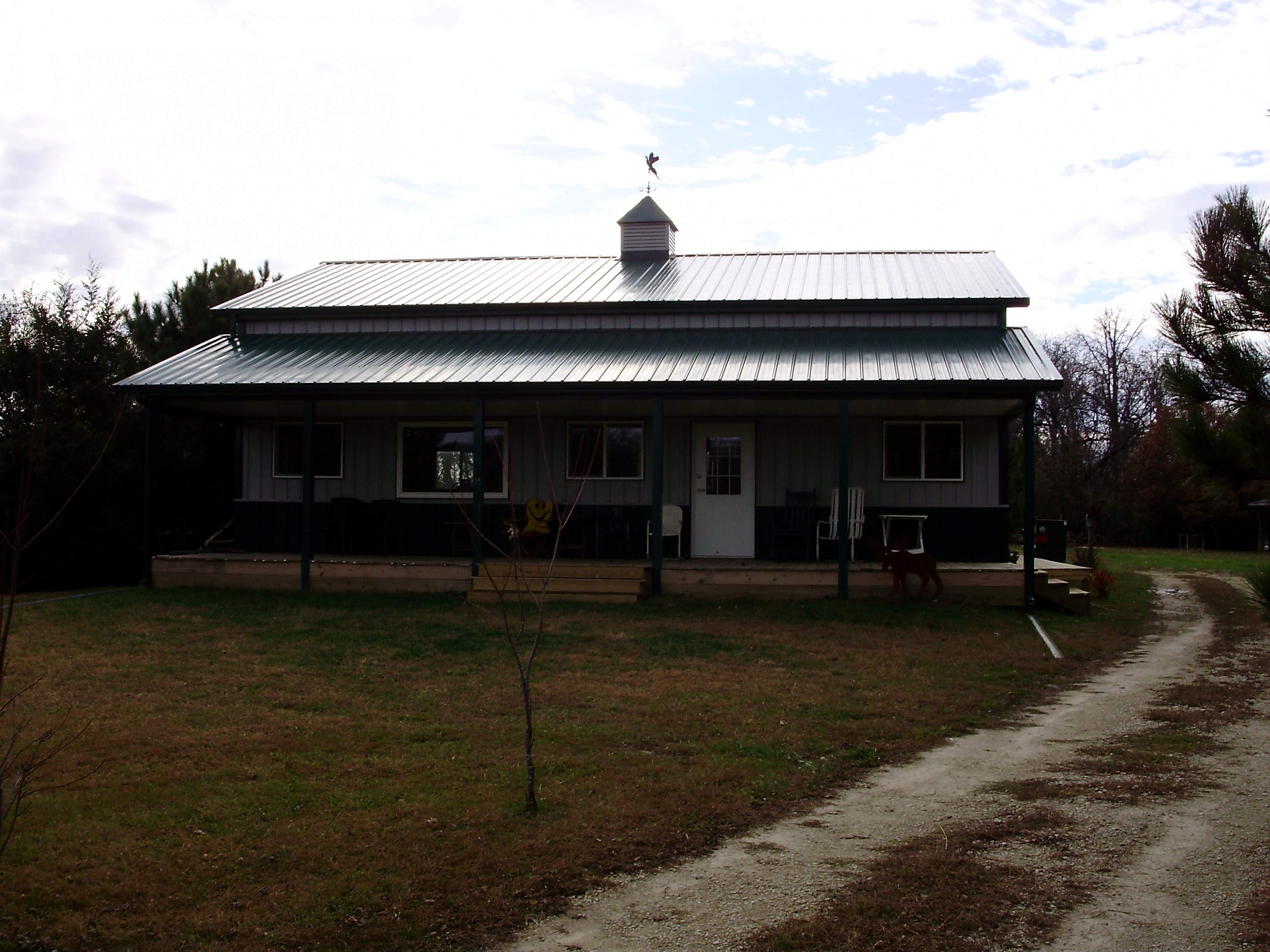

The same type of pole building house I plan to build.

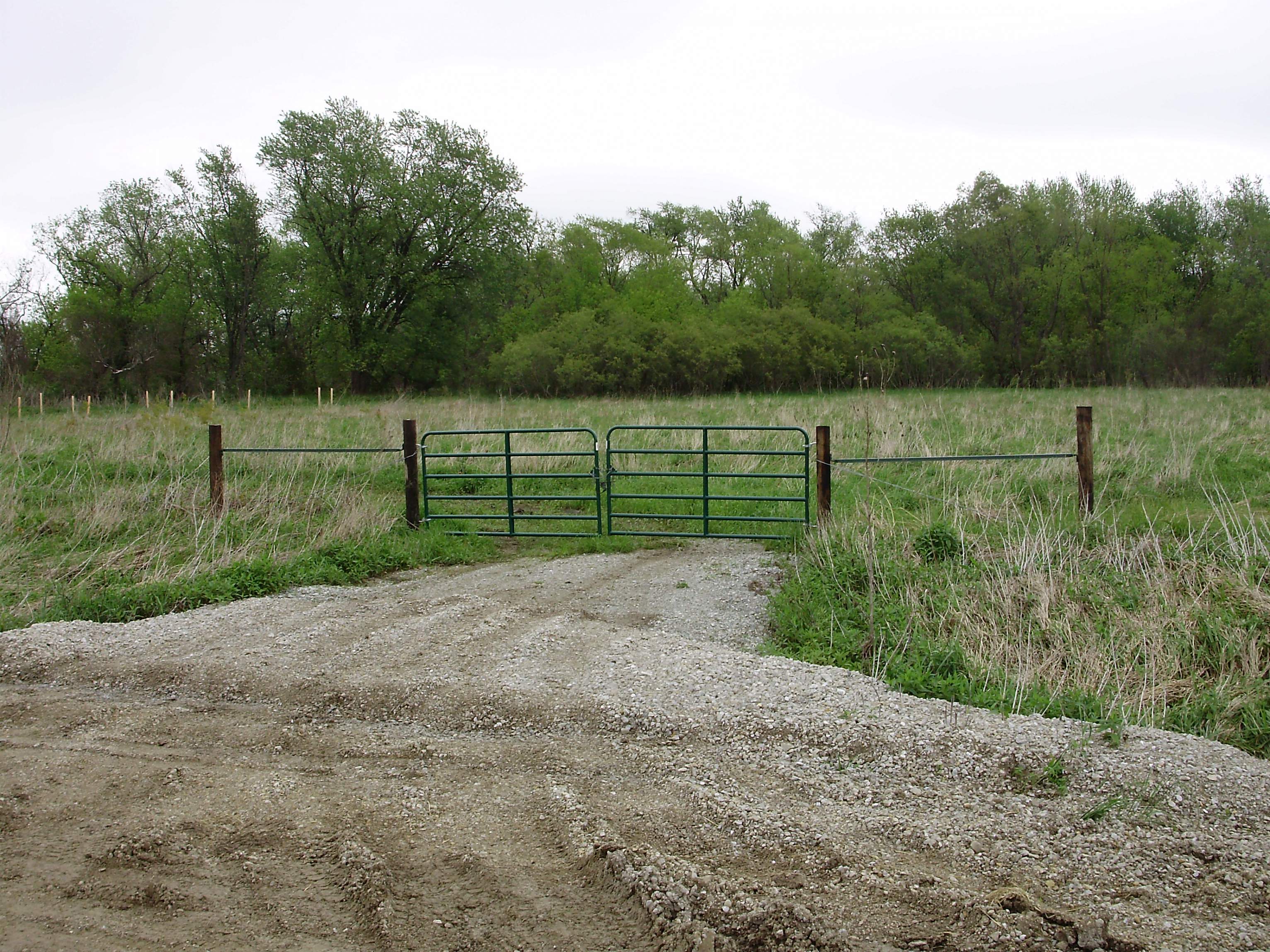

My wife and I built this gate after learning how to do it on the internet.

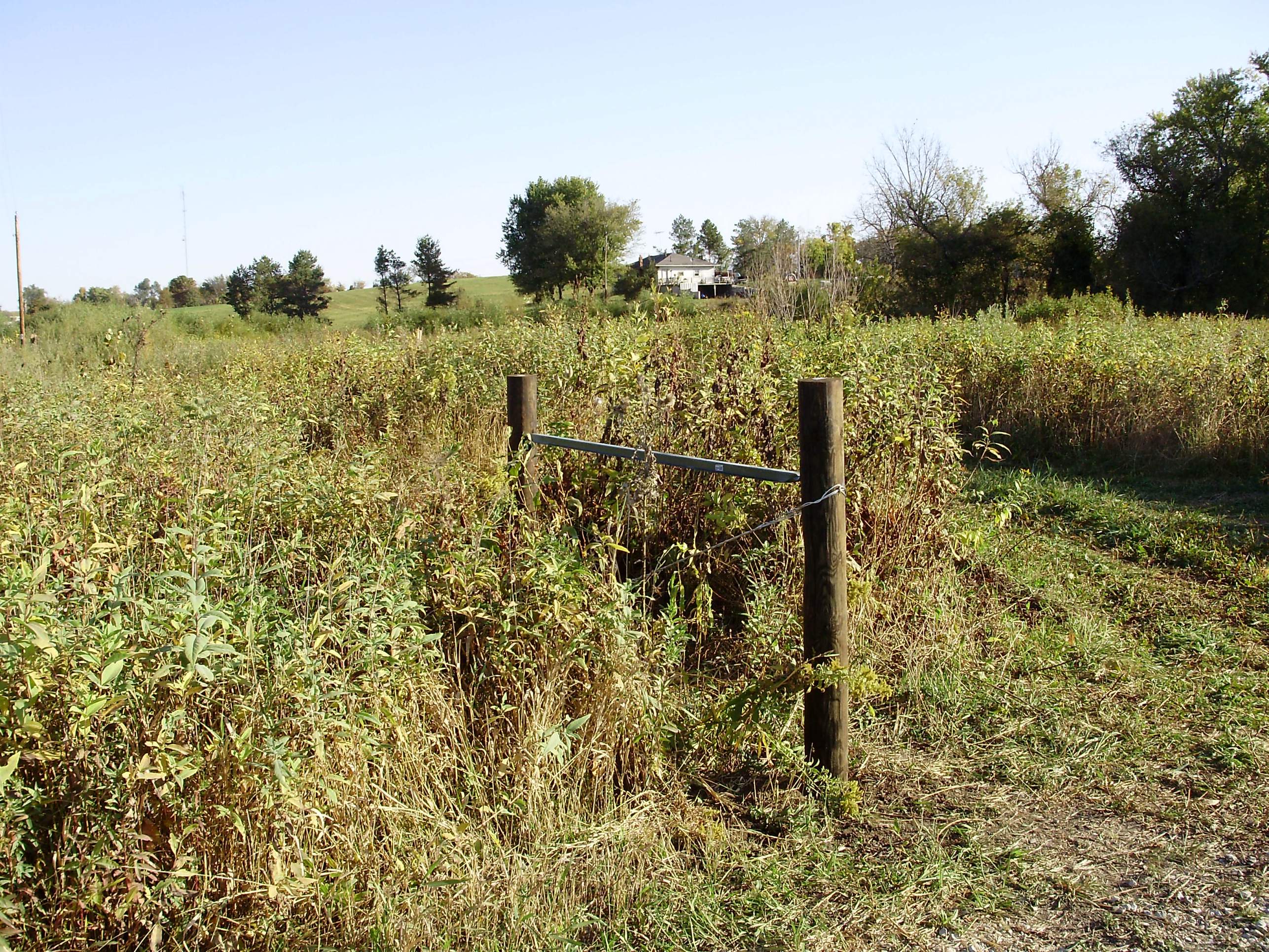

This is the first two post that my wife and I had did the year before, This is the gate that I have a picture of at the top of my website.

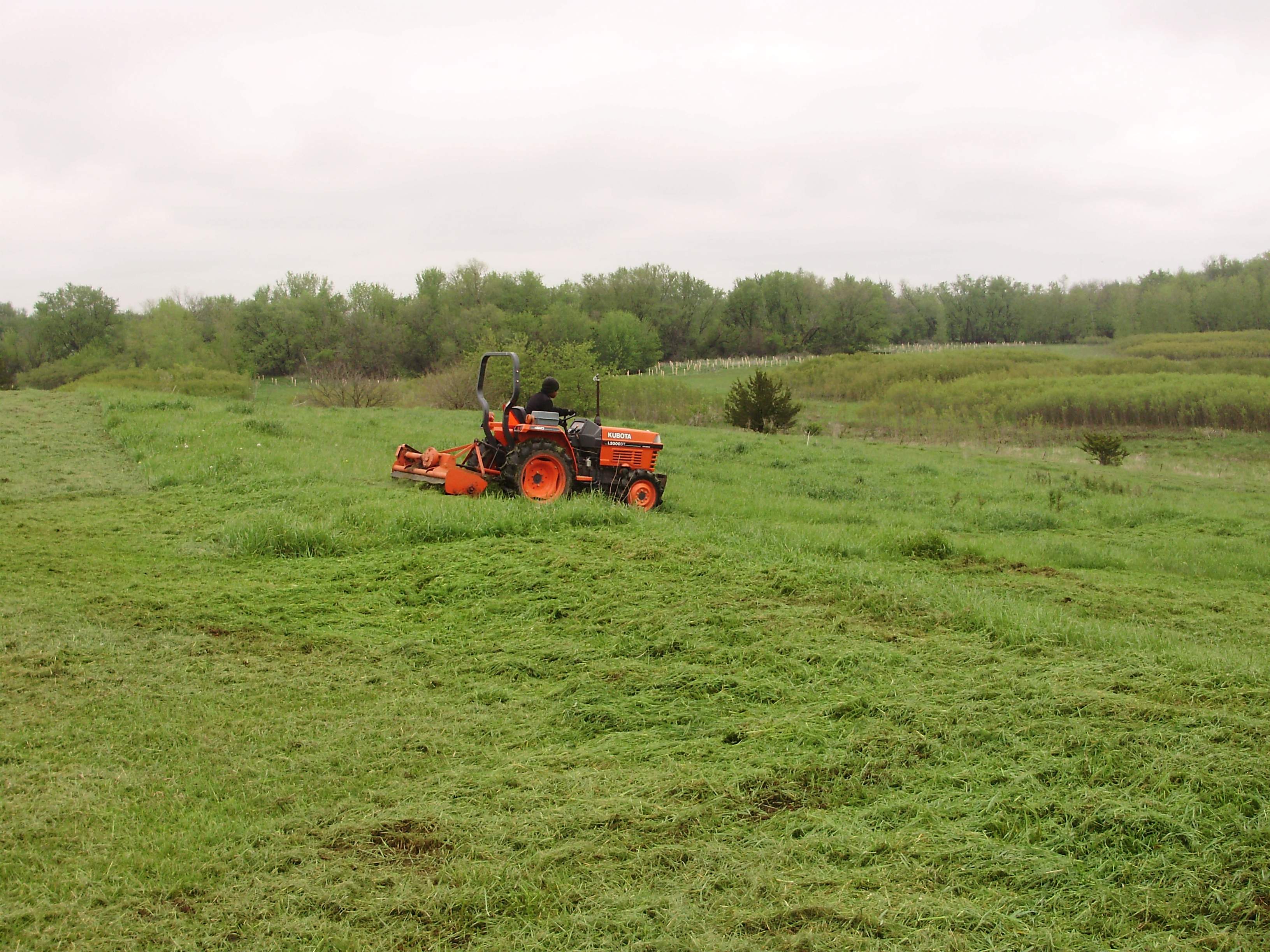

My wife Niki mowing a strip for the fence builders.
My wife and I arrived at the farm at 8:00 am before everyone else and the first thing we did was cut the barbwire fence where our main entrance gate was going to go. I then had my wife start mowing a strip where the new fence was going to be.

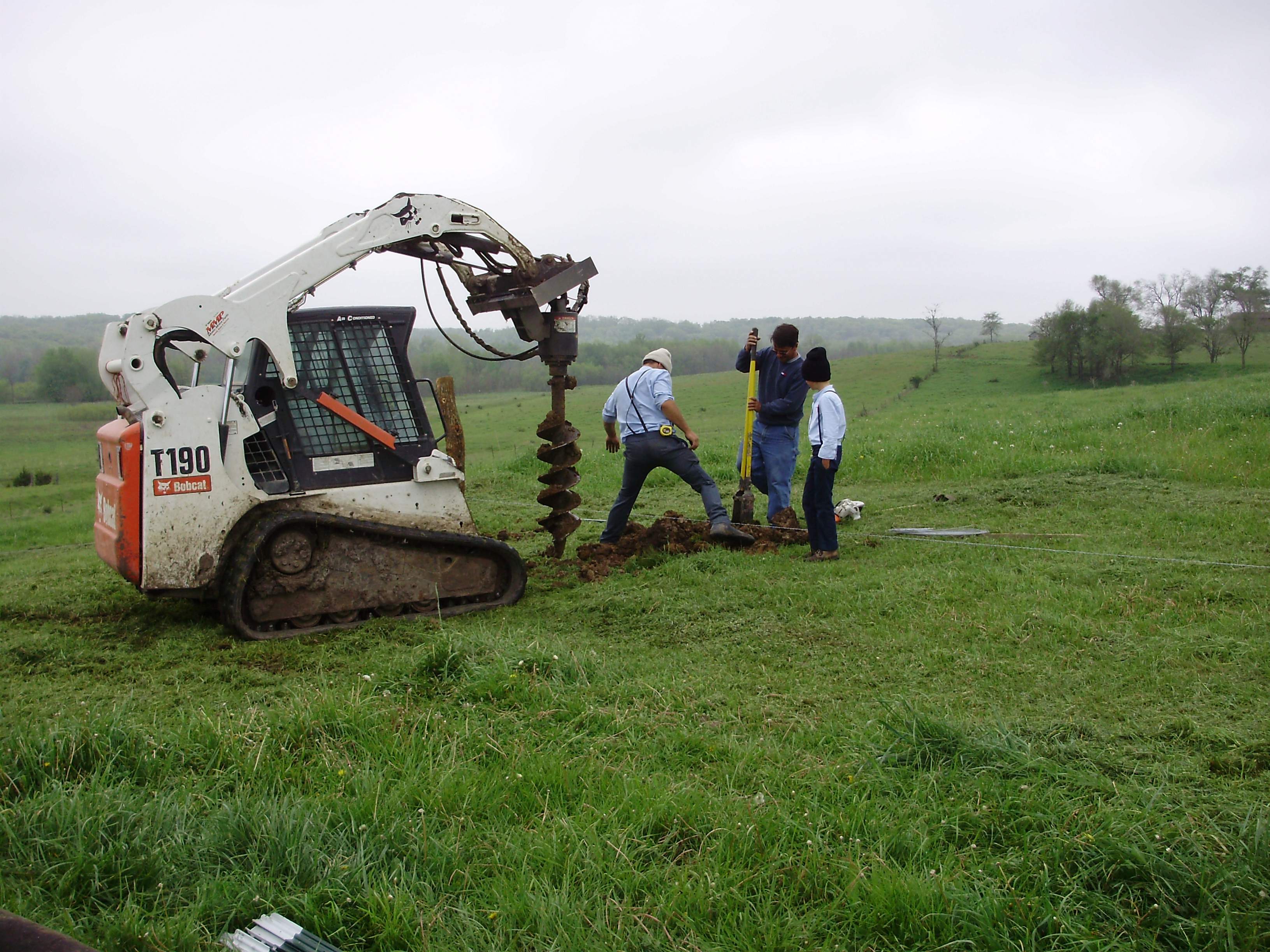

David our Amish fence builder with his driver and son, digging the holes for the post.
David and his crew arrived at 9:00 and after unloading the first thing they did was start digging for the wooden post. They set the wooden post first and then the metal T posts, they then built the H configuration with two hedgepost and a metal brase with # 9 wire to secure the corners and on top of the hill. The wooden post are Hedge post, also know as Osage Orange. It is a very hard and rot resitant wood that will last many years. It is sometimes called Iron wood.

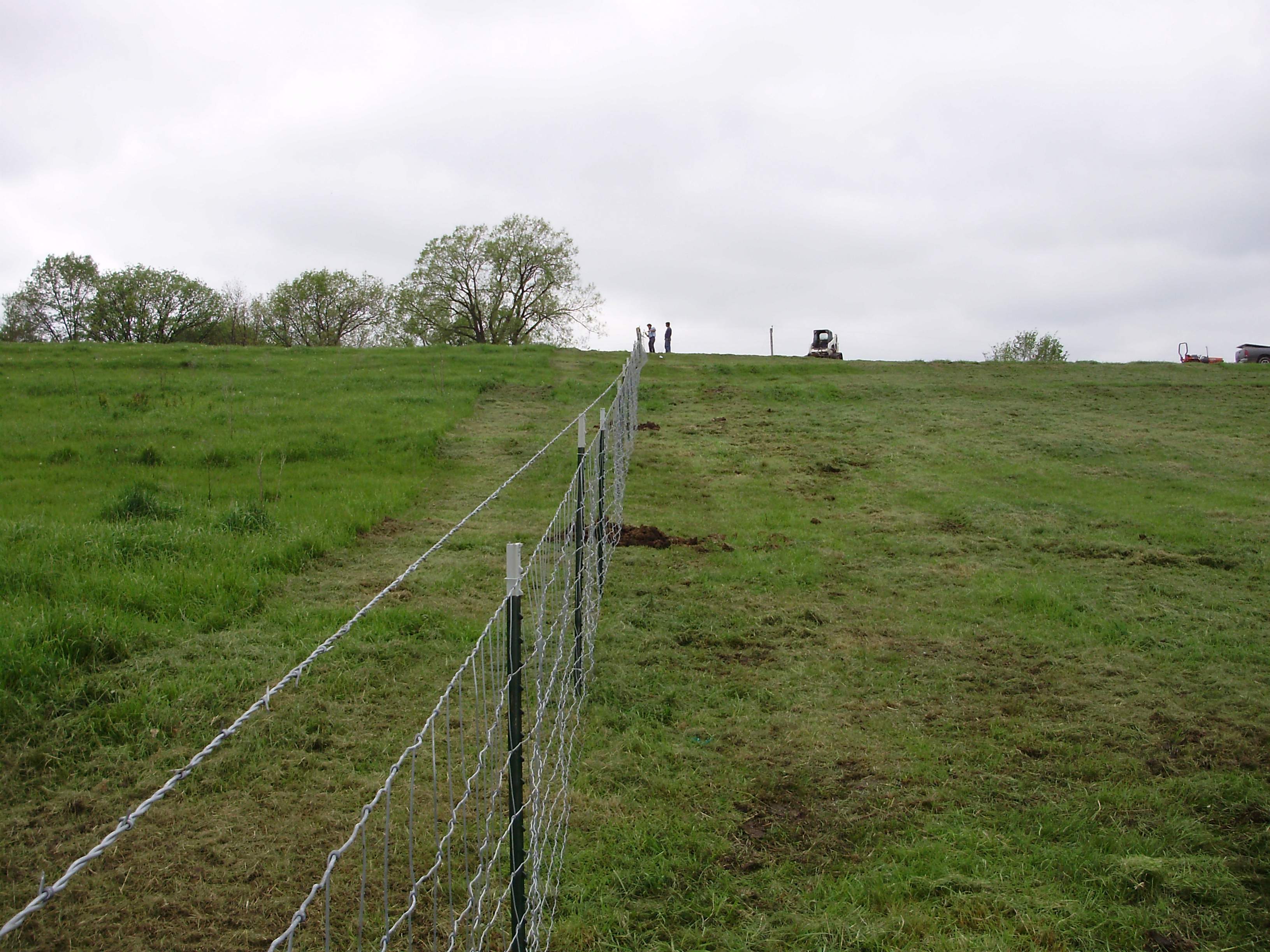

This is a good picture of the fence how they had to brace it at the top of our hill. This is done to make the fence stronger so when they stretch the fence and get it tight the post don’t start to lean over time from the pressure of the tightly stretched fence.

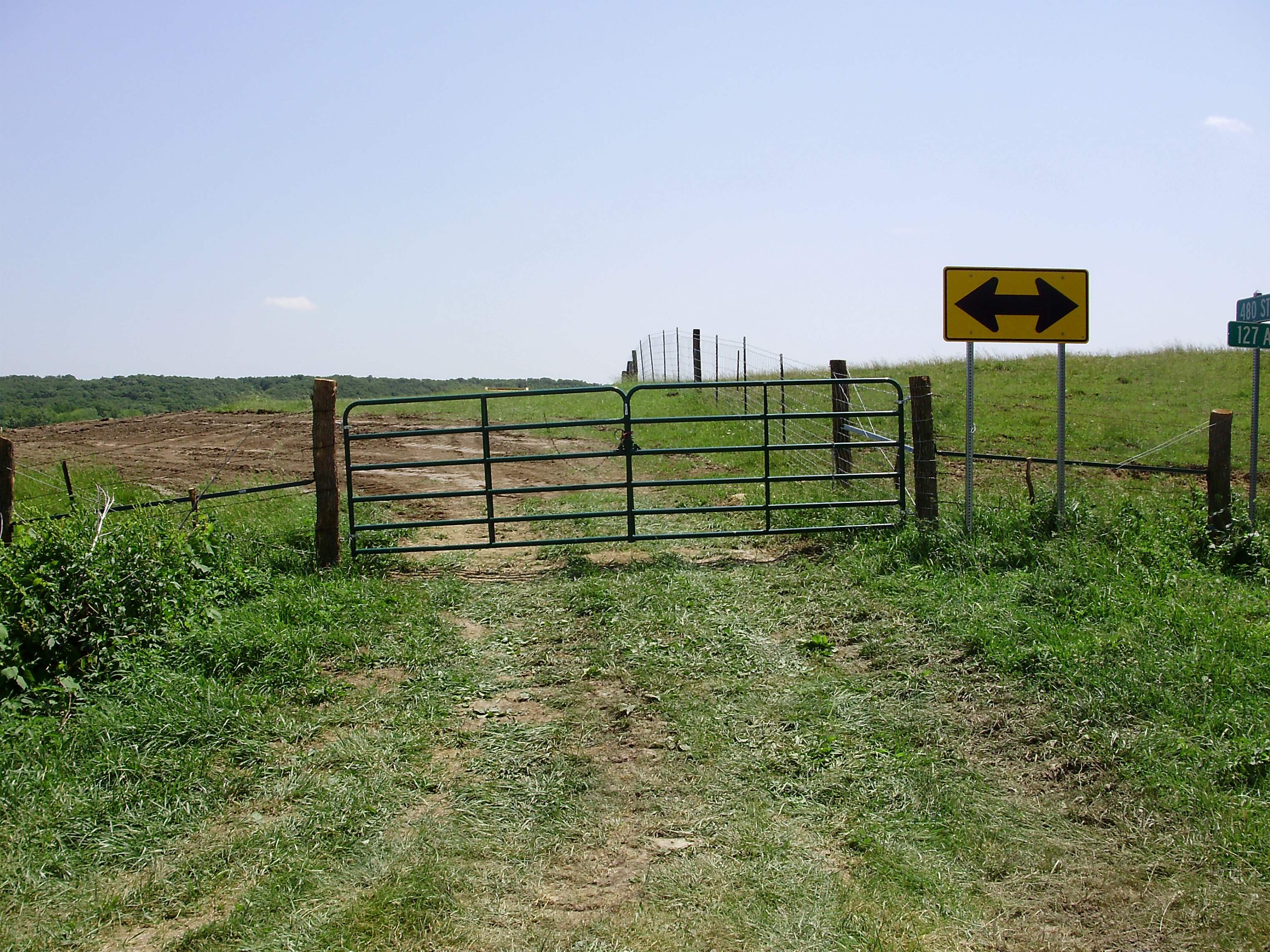

This is a photo of the new gate and fence, now looking at this photo, maybe I should have called the farm The Double Arrow Ranch
