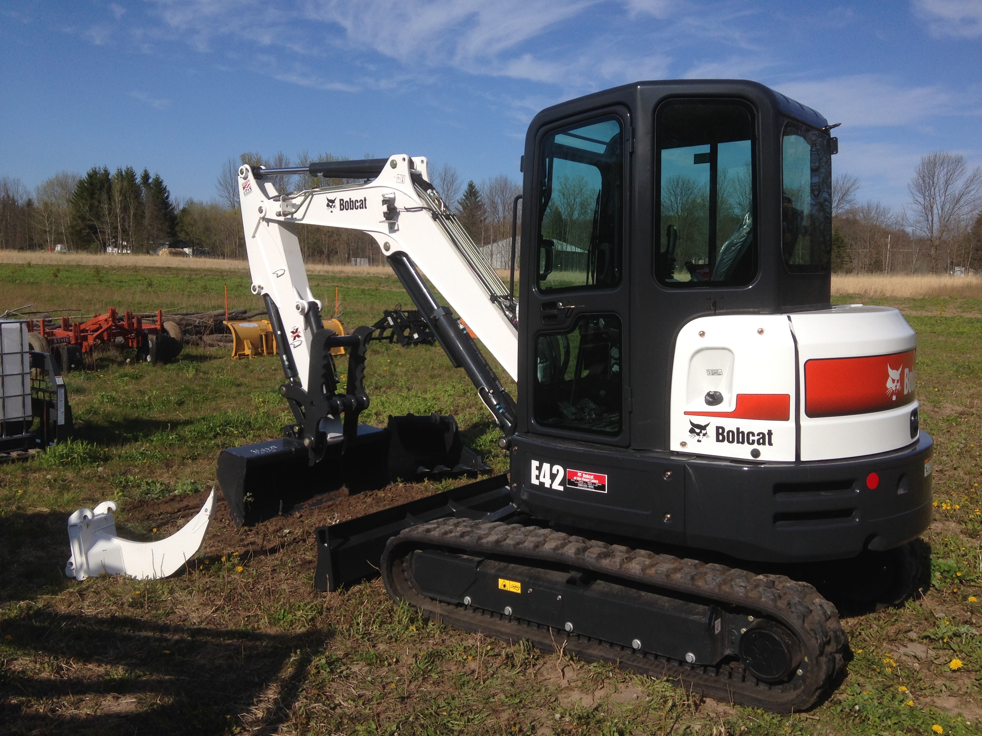

Some places sell rippers with teeth like coarse saw blades. Would they be any better than a regular ripper in breaking roots around a stump? Is there an actual sawing motion pulling the ripper though roots?
/ Mini Ex angle blade #12
I guess there could be if you wiggle the levers correctly .

Thanks for all the good advice. They're going to give me a price break on the ripper so I'll go ahead and get that. Stump removal is my main objective right now. I think I will look for a 36" bucket later on if I need a bigger bucket. Hopefully I can find a used one.

Thanks, the first link isn't quite what I'm looking for and I had the second one already - that's more what I'm envisioning, except I'll probably do the inside edge of the ripper smooth to avoid stress cracks, then ADD teeth out of AR plate "dominoes" with the cutting edge beveled with plasma for more aggressive teeth than just square cut - the "dominoes" will be overlapped maybe 3/4" so each "tooth" sticks up, teeth about 1/4" wider on EACH SIDE than the body of the ripper.
Otherwise very similar to the second link, but DIY cost should run maybe $200-250.
Thinking when I build my thumb I may make extension "wings" on it for a wider grip when using it with the single ripper, so I can have better control when moving/stacking entire trees with just the ripper and thumb... Steve
