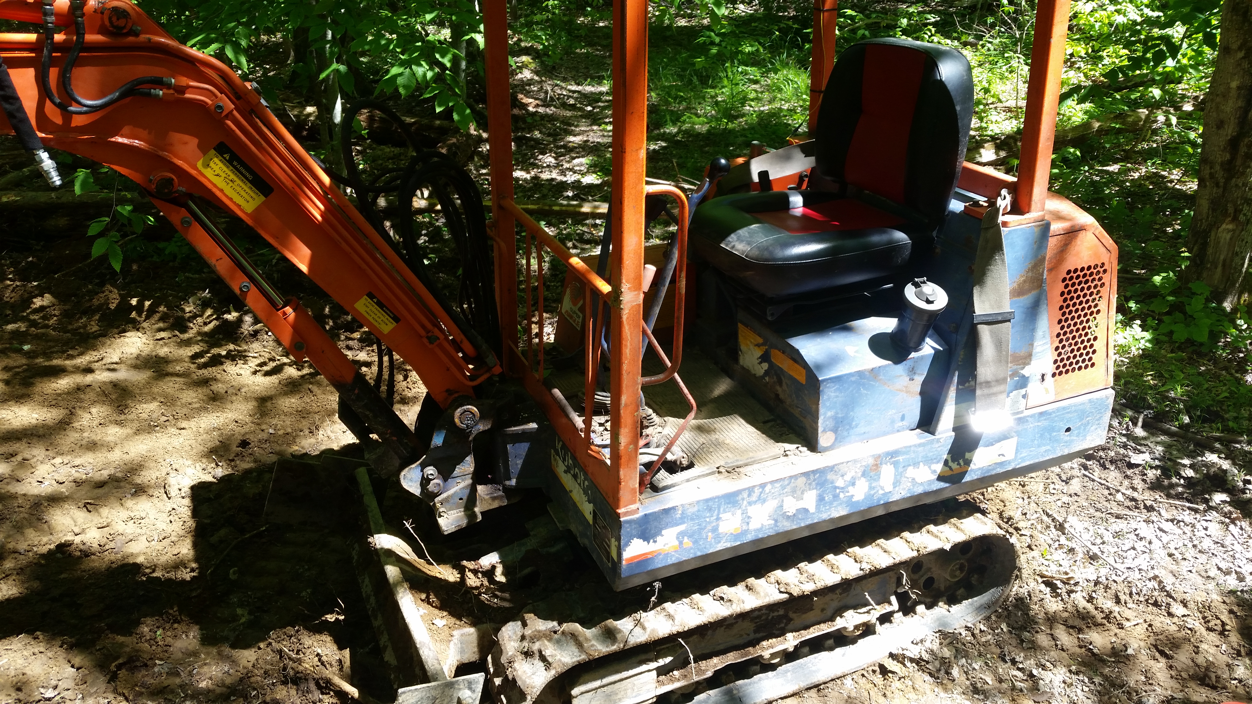

I also own a mini ex and use the blade quite a bit. I pushed about 90yards of stone with it to make a driveway through a swamp this summer alone. Some of those pushes where 75ft long. One thing i built for my blade thst you almost never see on mini blades is side wings. It makes the blade act more as a box blade. I built them just to push stone but they have been so handy i may leave them on. There simply a piece of flat stock thats bolted on the side of the blade.
They look real handy!
