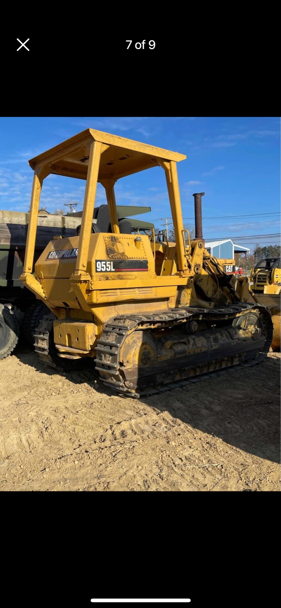

I didn't say skid steer, I said track loader. Cat 963, Dresser 125, John Deere 650. These are not skid steers. These machines have steel tracks and are excavation machines. They're small, 18 to 24 thousand pounds but with the right operator will bury comparable size track hoes.
I’ll take that bet again. I had one for about a month and I sold it. If it was a newer rear engine joystick machine it might be a different outcome but these front engine machines that are actually cheap are dinosaurs. An excavator will burry these.

In my part of the world, nobody, uses those old style tracked loaders. They can't do what a dozer does, travel way to slow to do what a loader does, and have a very expensive operating cost. With that, they do land clearing better than a dozer, and if light woods, faster than a hoe. The couple times you will see them, its a 40 year old machine that a guy bought to clear a lot, and plans to park in the back to rust away when done.
They dont do well in wet areas.
   / Buying an excavator with resale in mind #23
My old D5 that weighs about the same as the 955 would grade vastly better than the 955 could do. That’s the leading reason I sold my 955. Honestly I could do more work with my skid steer than the 955. It was just too slow and clumsy.

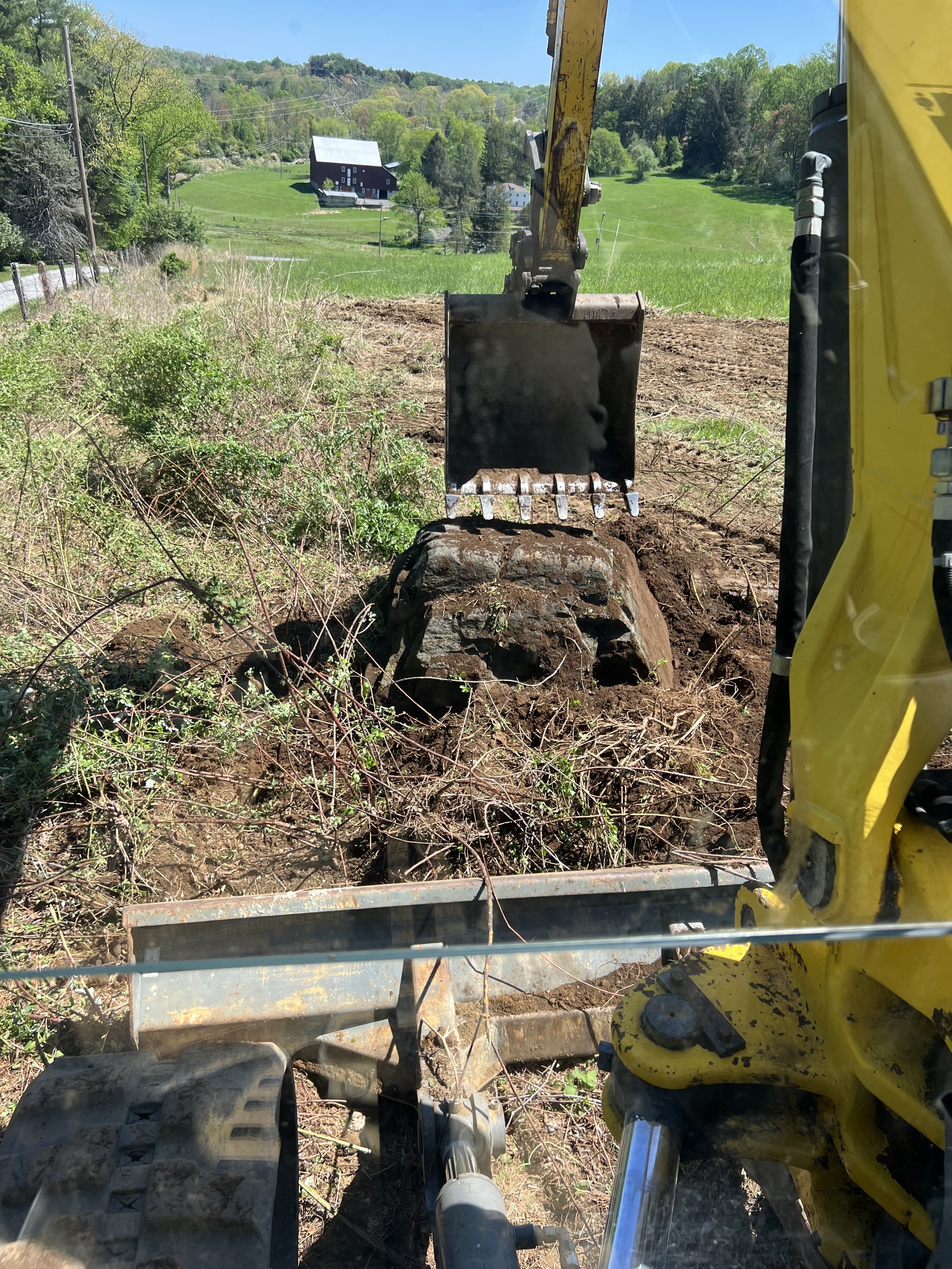

Unless you are just sold on a small track hoe, I would seriously consider a small track loader. With a 4 in 1 bucket it will do anything a track hoe will do and more. The only thing it won't do is dig a narrow ditch because the bucket will be wider than one on a small track hoe. Try to level ground after you have dug up your boulders and trees with a track hoe, no matter the size. Comparable size machines, the loader will should cost less.
I just did this with about a dozen boulders. If the excavator has a blade (mine does), they do an excellent job of leveling ground
