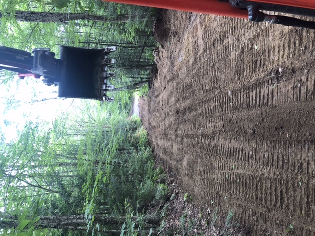

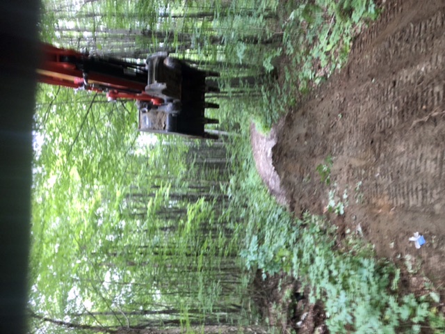

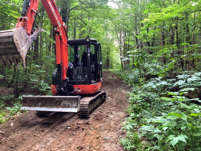

I have a Kubota KX040-4 with an angle blade, while not a dozer it will push an impressive amount of dirt.
