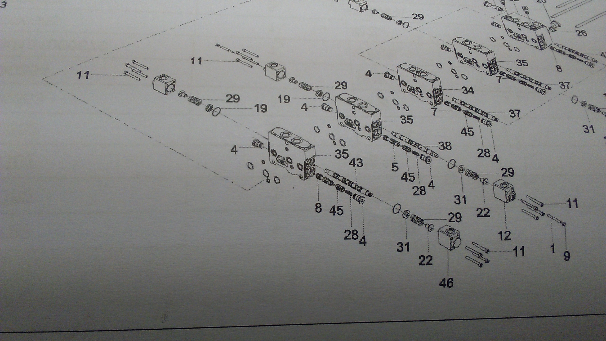

   / Mini Excavator Hydraulic Problem
#37
It's been snowing and raining so haven't worked on it til today (Need a taller shop).
I attached a diagram - the valve I'm working on is on the left. I refer to the part numbers here -
I was able to pull out plug 4 and the small spool on the relief valve 45 all looked OK.
Then I pulled off the cover and seat and spring 22 and 31. I could not budge the spool 43! Pushed and pulled on it and nothing. do I need to take off the other hoses? How aggressive should I get? Obviously my problem area..... Do I have to take off the other cover (same cover as 46 but on opposite side)? To get at that other side of the valve body I might have to take most of the hoses off...
thanks for any advice
VG
   / Mini Excavator Hydraulic Problem #38
usually the spool will move, its double acting so nothing should be holding it, you could take the spool next to it and see if its also tight, had a bobcat 846, the spool was stuck, turned out it sat with water in the valve and solid, took a bit of force to free it
#39
This machine is only 2.5 years old and 350 hours so i wouldn't think rust? I didn't want to tap on the spool with a rubber mallet until I asked someone....I sure could try another spool to see if it comes out, but they should be free moving...this one isn't and that is my problem. will i damage the spool or body?
vg
   / Mini Excavator Hydraulic Problem #40
I would tap the spool to see of it moves. If it moves in and the spring doesn't push it back than you have to take more apart to get the spool out on the other side.
If you use some sort of soft metal as a punch as you tap the spool you probably wont damage it.
Is there some way to use hydraulic pressure to push the spool out on the port of 46 (from opposite site)?
