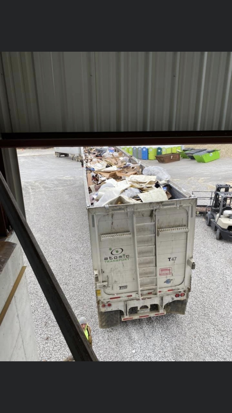

Here’s another pro backhoe moment I saw on Facebook. It’s a trash transfer facility. They dump trash off smaller trucks and dump it in open top semi trailers. They push trash off the edge into the truck with the skid and organize it into the trailers with the mini. The other facility uses a backhoe. The backhoe does the job just as good with one operator, one fuel bill, and one machine payment. The CTL can’t organize the trailer so it’s useless by itself. Using the mini blade would be painfully slow to push. And that facility just opened. Look how many skid marks are on the concrete already. The tracks couldn’t last long doing that. IMG_8158.JPGIMG_8157.JPG
