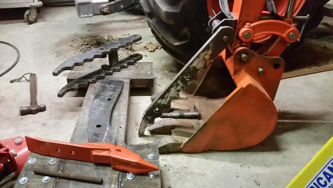

frost ripper1.jpgI read somewhere that it is better to have overbite for the thumb, I went with flat jaws not curved, one is cut out but having issues with my cutter, also got distracted making a frost rippertmb3.jpg

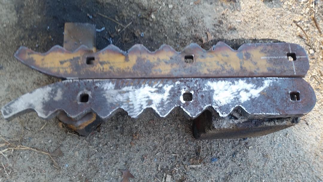

finished cutting, they need cleanup, and have to take the temper out of the end so I can make the square hole round.need cleanup.jpg
