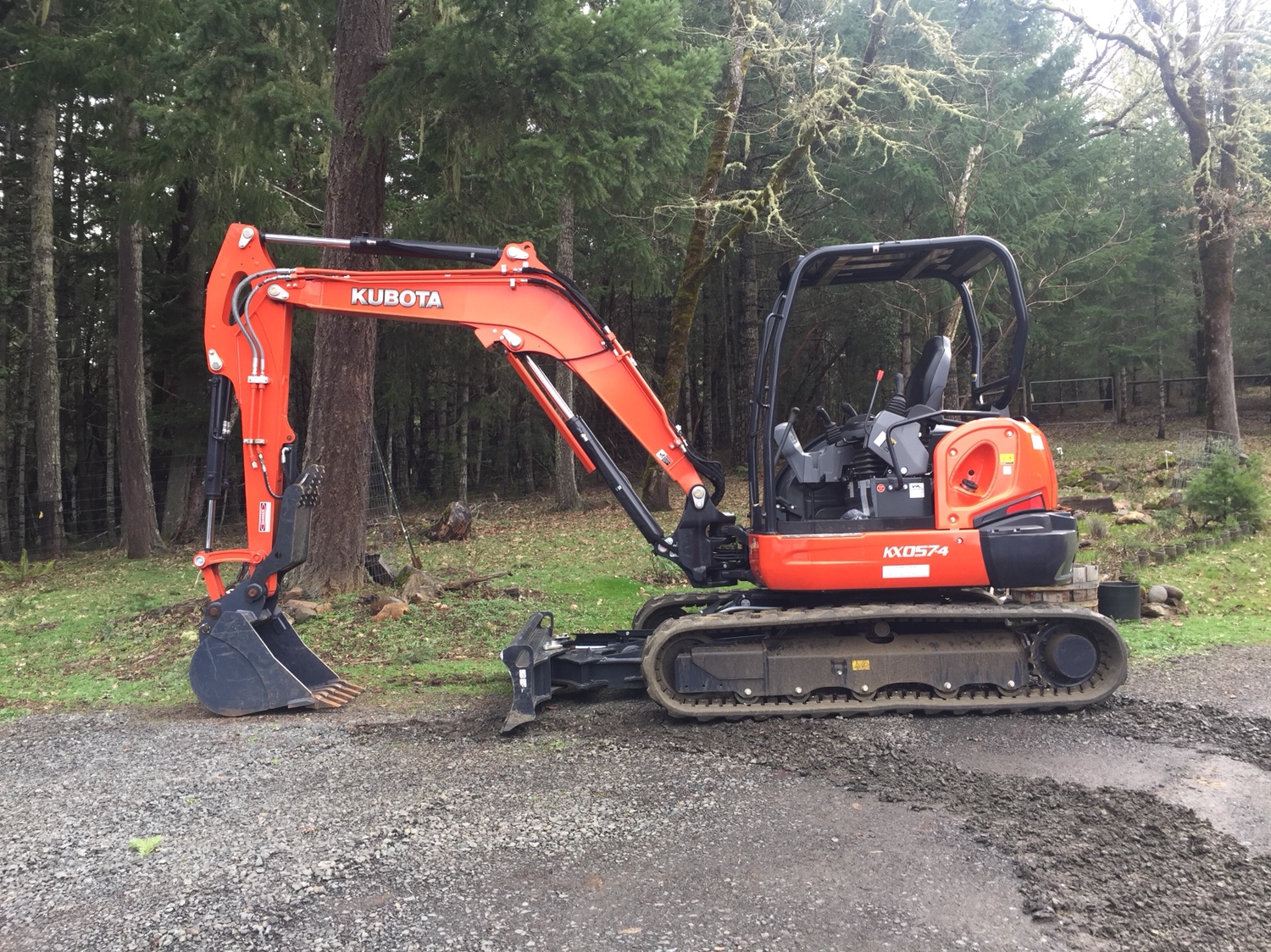

I bought mine for the exact same reasons you have put forth. A Kubota KX-71. Didn't want a cab, and this fit my budget and needs perfectly. Decided to go new, 38K out the door, hydraulic thumb, quick attach, ripper tooth, 24" bucket, 36" grading bucket, and standard 2 way blade. I Love It... Looked hard at the KX-91, but couldn't justify the extra 15K with 6 way bucket. I have put in maybe, 2 miles of trails, dug up countless stumps, and graded off a couple of areas. Mine sips diesel at full throttle, and is incredibly quiet at that. Also, didn't need the zero clearance, so that saved some money. My game plan is to keep it a few years, finish all my projects, and sell with probably less than 300 hours on it. Figure I can't go wrong...
