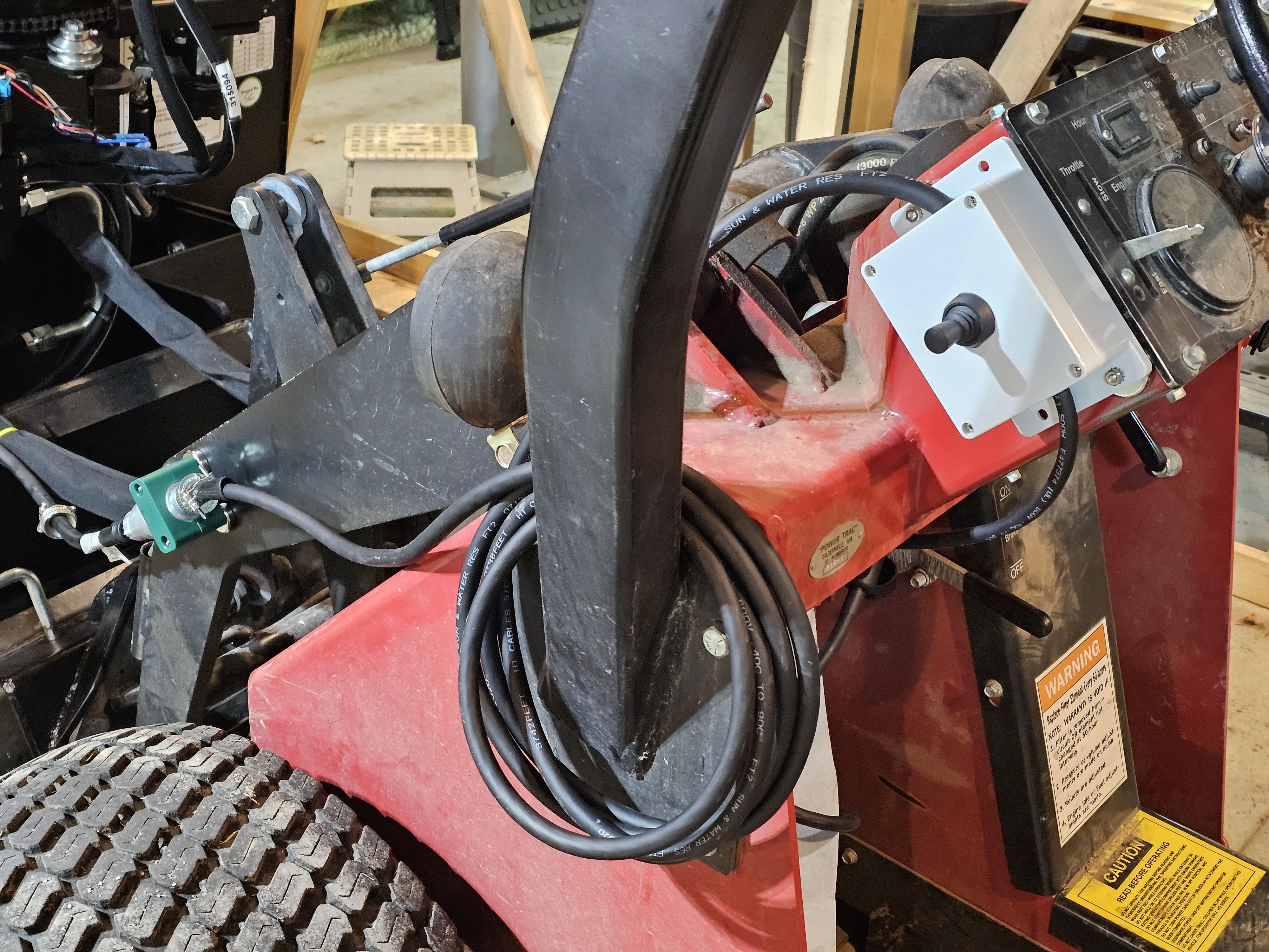

  2. providing electric-over-hydraulic joystick for chute control
  3. providing electric power for electric-over-hydraulic joystick
(1) was acomplished by welding PT female plate to mini-SS male adapter (mini-SS adapter).
(2) was accomplished with electric-over-hydraulic joystick. (I really like the temporary/seasonal aspect of this!)
(3) was accomplished by adding a 12V outdoor-graded outlet (cigarette lighter). [At the recommendation of a friend who knows automotive wiring, there is a relay involved.]

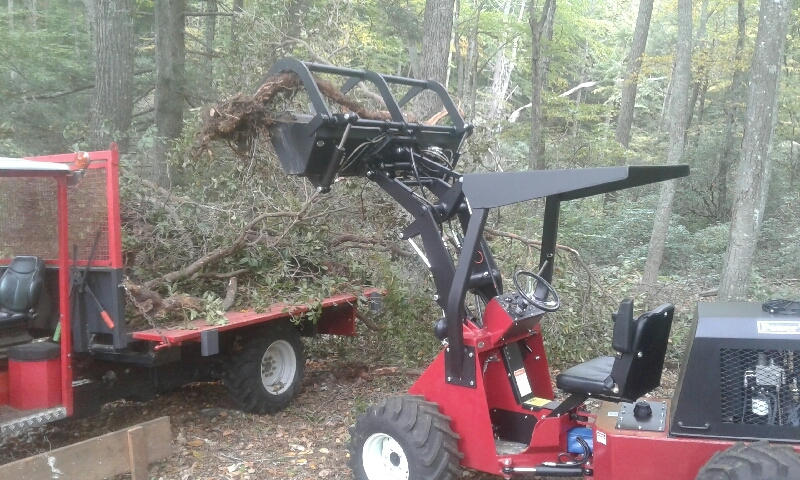

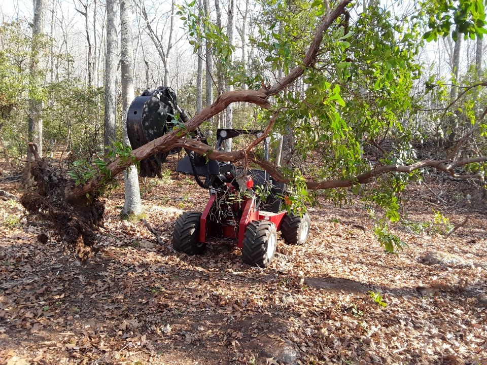

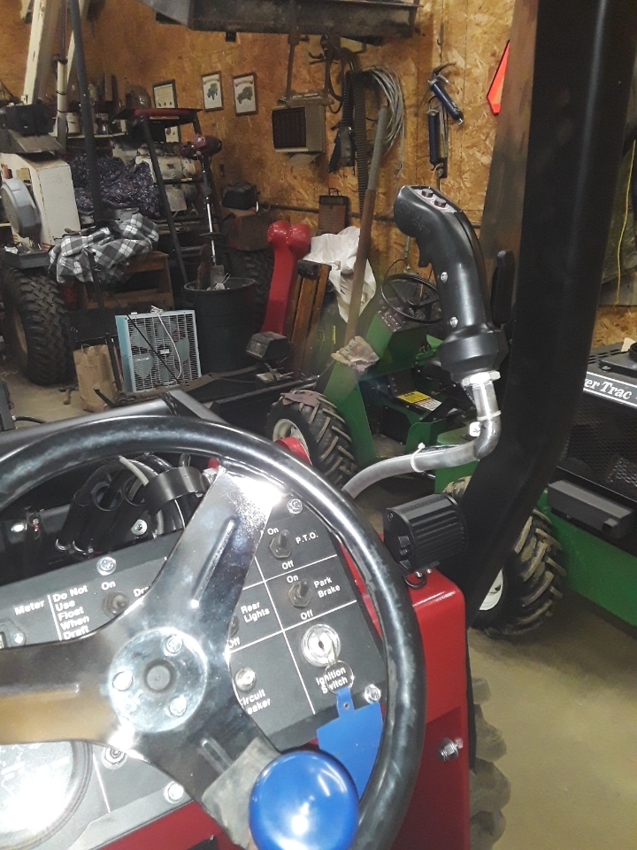

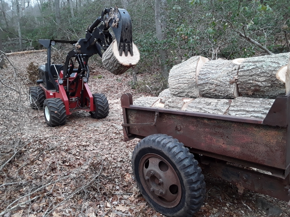

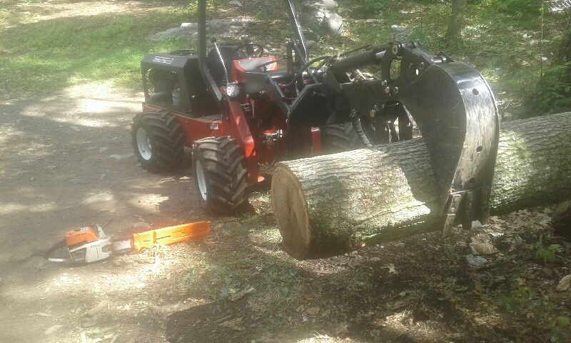

Nice job, now you need a plastic windshield/cab. I took off the loader control lever ball and installed a joystick style with a trigger switch for index finger and 2 thumb buttons. I use this for so many attachments and it is most ergonomic and quick. The trigger works my 4n1 bucket, grapples, front mini hoe, tree shear. The thumb button works the rotator on a log grapple and to rotate the tree shear. Over the years it is well worth the effort.
   / Mini skid steer snow blower with PT-1430
"... I took off the loader control lever ball and installed a joystick style with a trigger switch for index finger and 2 thumb buttons."
I wouldn't mind seeing pics of this on your tractor...
   / Mini skid steer snow blower with PT-1430 #6

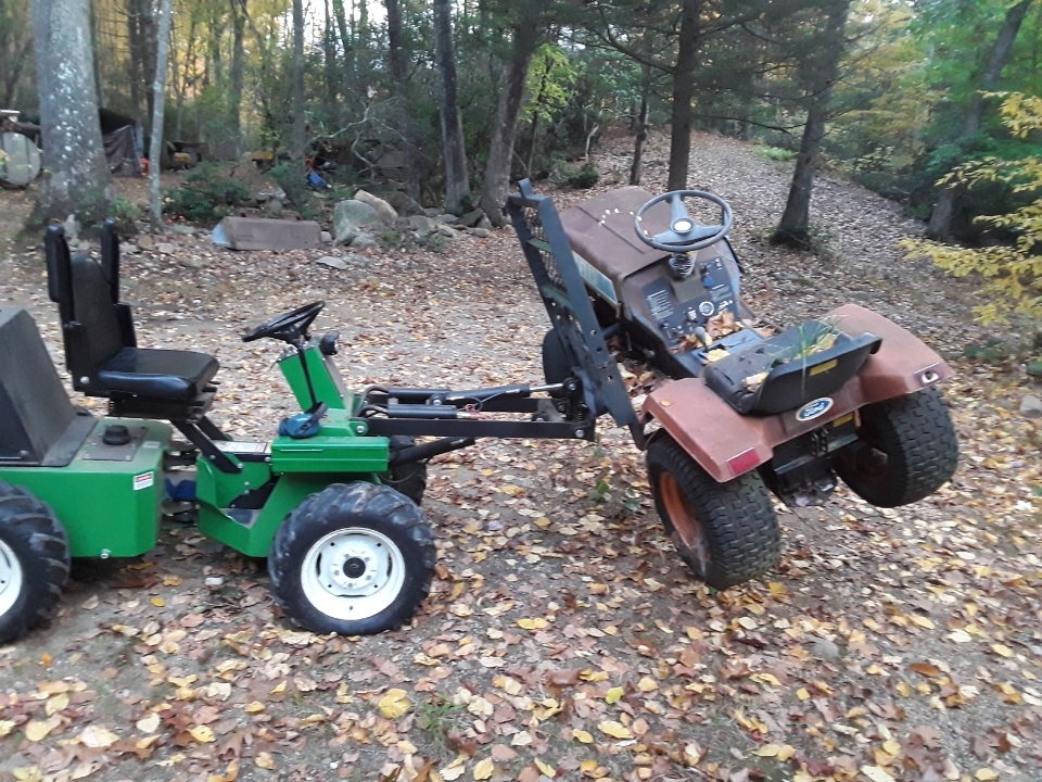

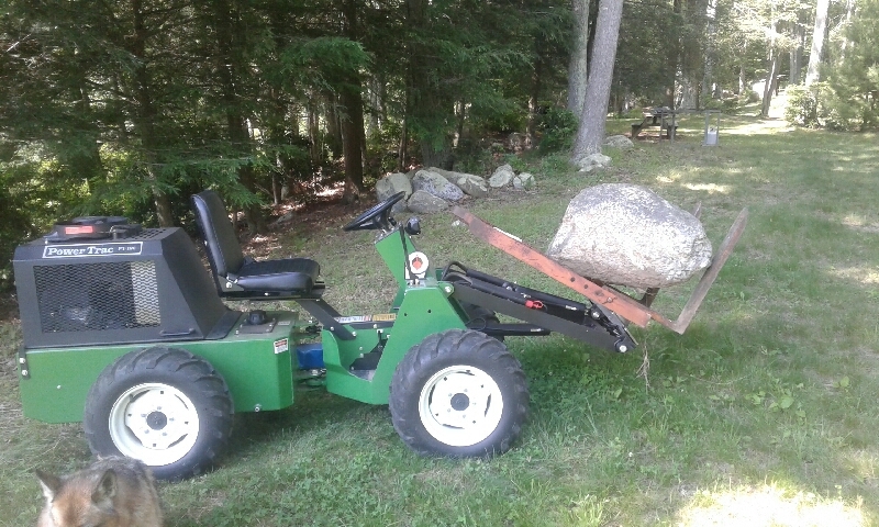

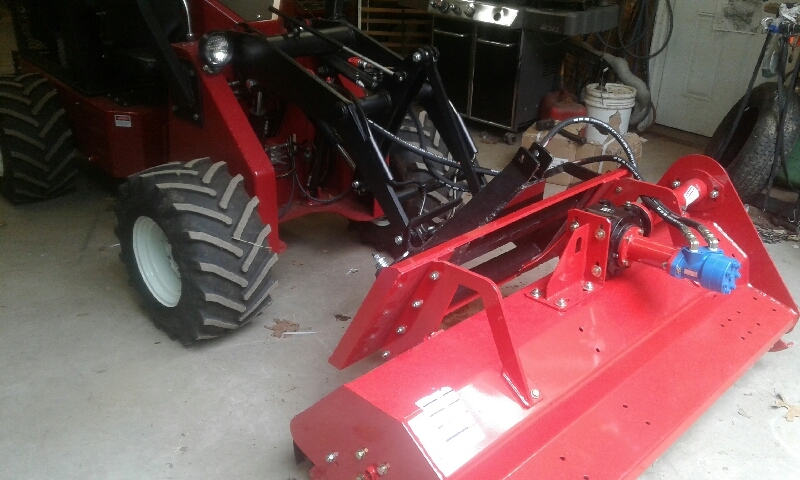

Here are a few, you might want to look at my past post too.
   / Mini skid steer snow blower with PT-1430 #12
That looks like an excellent permanent installation! 👍👍
Thank you. That pic of the handle is on my 1460. The lever needs to be cut to the proper length, threaded and bent so it is comfortable for the operator.
