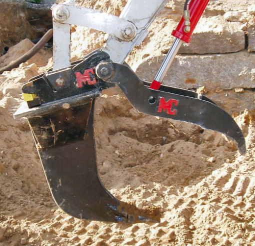

ALternatively, what I would really like is a digging claw in place of the bucket. It would be useful to really break up the soil. My property is on a slope, and the contractor leveled the area for the house almost completely (it seems) with various sized rocks, so digging any holes is a PIA. The minihoe helps, but it seems a claw digger would do a better job of worming between rocks and yanking them loose. The ultimate might be a combination digging and grapple if I can figure out what that would look like.

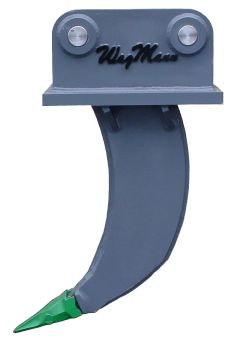

How about something like this.

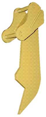

Here are some more pictures.
/ Minihoe Attachments #8
yep, exactly what I was thinking.
I have some mild 1/4" steel plate that I could make into something like this, but I am thinking that it won't last long in this application, should be some hardened steel.
