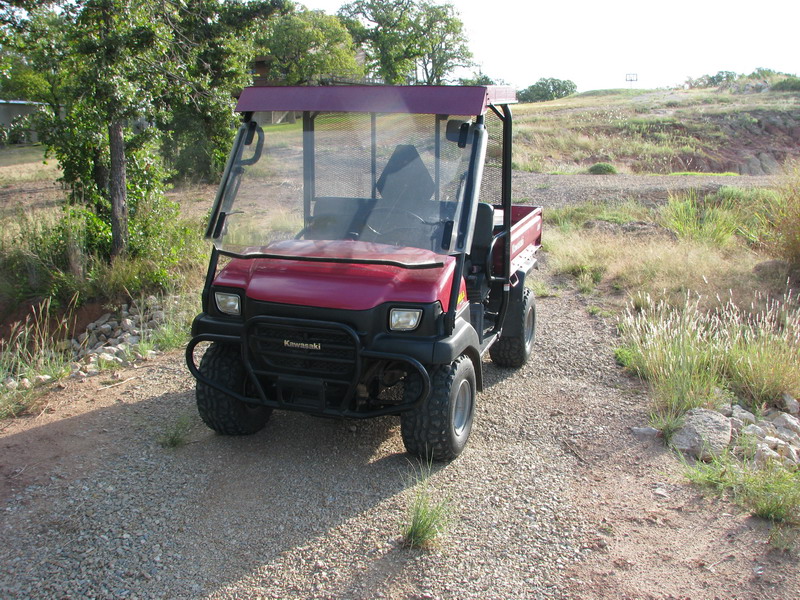

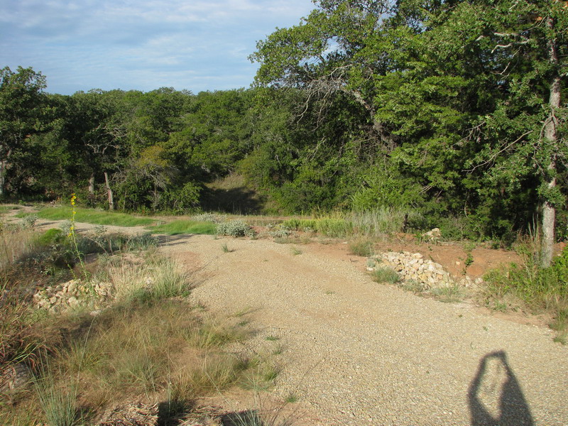

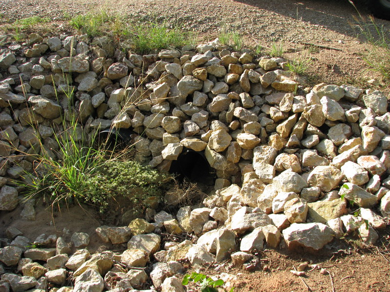

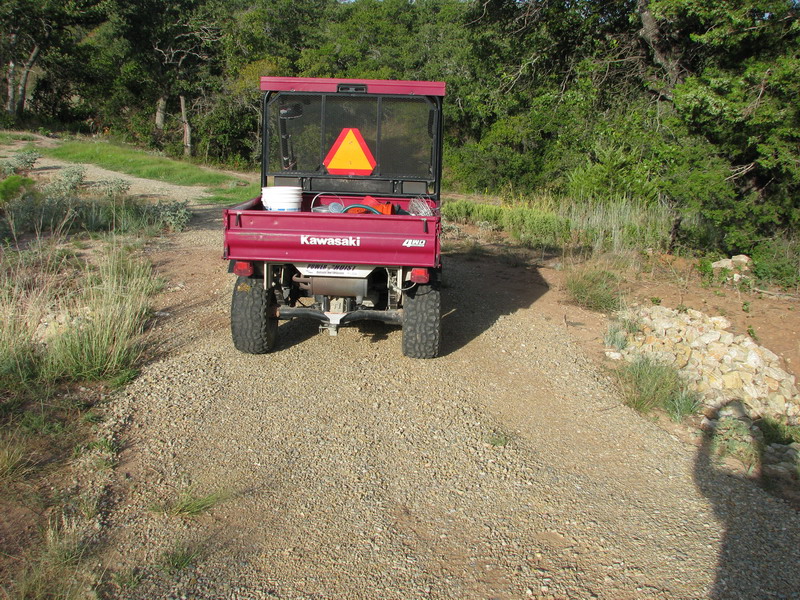

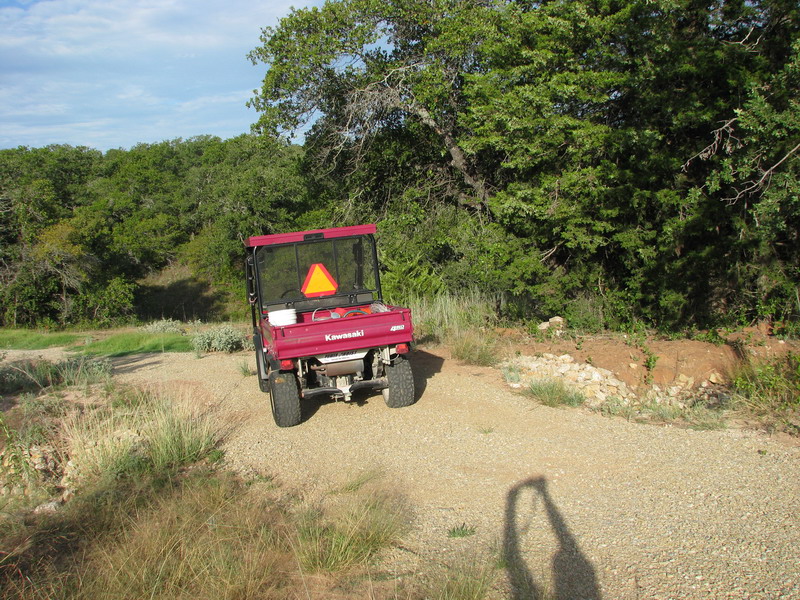

Here are the photos I took this morning. This is 2x20'x12" culverts. Please excuse all the grass and weeds. I'm letting them grow because of the wildflowers. . . That's my story and I'm stickin' to it.:)

Jim your pictures made your argument for the wider culvert very impressive. I guess the backslope just eats up more than you would first think. The case of the incredible shrinking culvert!:eek:
