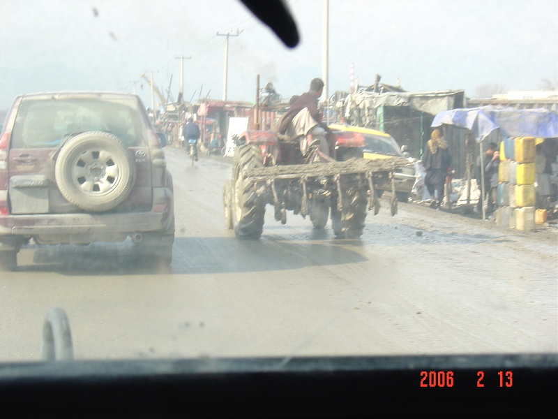

In Southwest Asia tractors are used on the public roadways a lot. They almost always have mirrors. Most tractors have vertical exhaust. They usually clamp the mirror to the exhaust stack....
If you look closely you can see his mirror clamped to the exhaust about six inches below the top. :)
