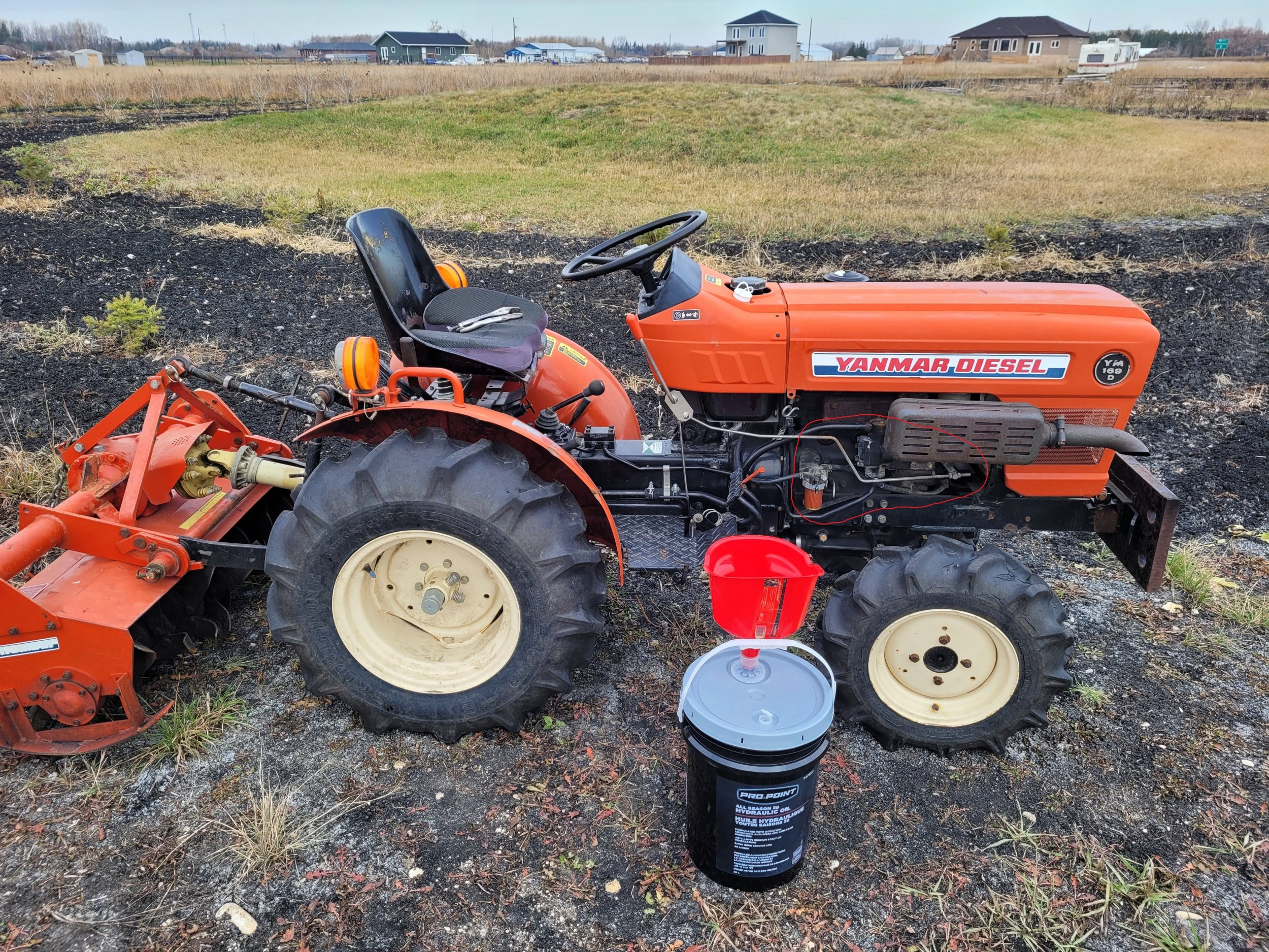

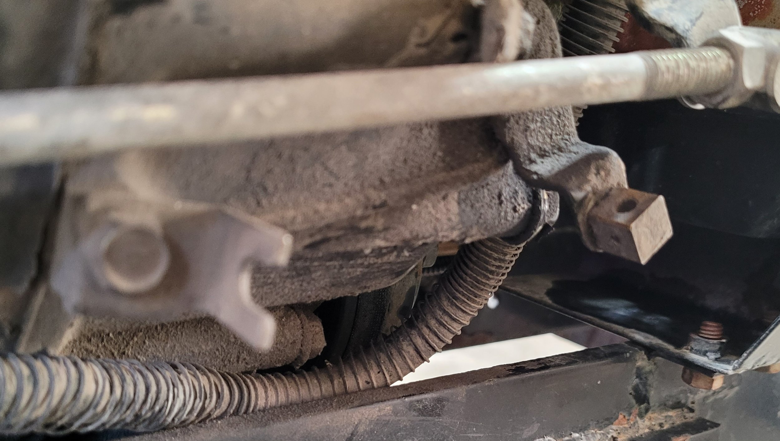

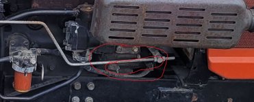

Hey everyone!
Anyone else with a 169D, or someone that would know.
Attached a picture of my tractor, and a zoomed in picture. I think I am missing the governor spring, but I can't find any pictures of this area online.
If you have a 169D and can attach a pic of the same area, or if you know what part I should be looking for please help me out!
There is a ushaped flange/bracket and a block with holes in it that rotates. Seems like a spring would reach here.

Ok, not trying to be dumb on purpose, I went through each diagram multiple times, couldn't find the diagram highlighting this area.
But I will keep looking.
I noticed when rototilling it will just give up, and won't recover even if you manage to clutch before it stalls. It will just sit and idle even though the throttle is full open. So I shut it off and start it again, and it starts to have full power again.
Or it takes quite a long time to recover. Also won't idle lower than 1000, which some times you can get it to recover by pushing the throttle back up, other times no.
Edit:
So it looks like the engine stop device? And there is nothing between the lever with the rotating box, and the flange/bracket?

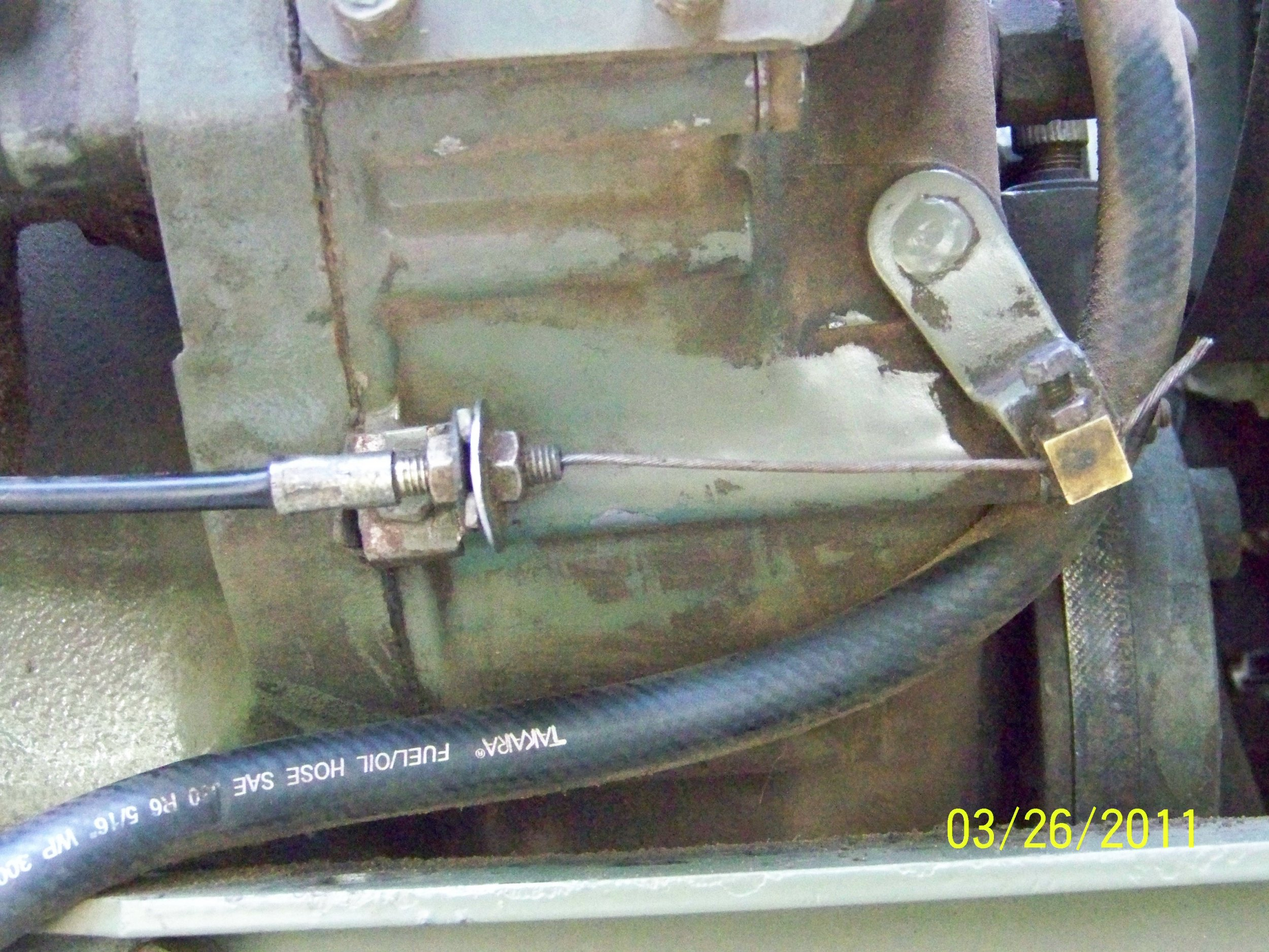

I don't know where you are located but if you look at figure 40, item 10, you will a stop cable that anchors on figure 31, item 7. The end of the cable then hooks to item 2 on the stop devise. You have got items 7 and 2 showing in you last picture. The stop cable is not shown on the US sold, that is why I wonder where you are located. Make sure item 31 is all the way forward. Referencing all this in the 169 parts manual. Here is a picture of my old 2002D with the same setup.

Thank you! I am located in Manitoba, Canada.
Is there a Karma/Reward system?
This looks like it would work exactly like the shutoff cable on my Case 1070.
Pull it and it shuts off the fuel. So if that lever is moving on it's own. It is just randomly restricting fuel.
Which _could_ explain most of my problems!!!!!

I think Winston is right, that lever is for a stop cable. A feature that may not have been on your Yanmar.
I have two Yanmars from the same era, plus once had another, and all look like yours - an unused empty bracket and lever. I always wondered what that was for.
