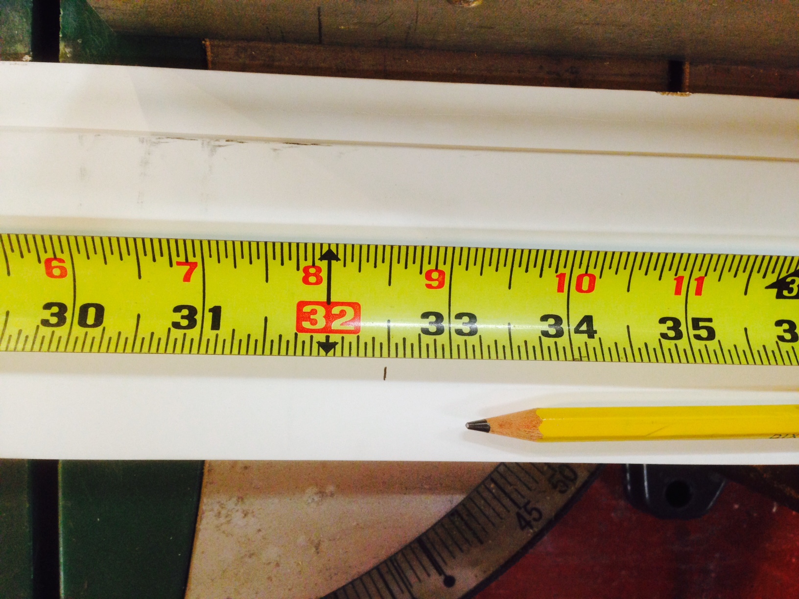

Never had a laser miter saw. I use a regular pencil that leaves a mark about 1/64" wide. Then align a left leaning tooth with the mark. Depending on fit needed I leave the mark or take the mark. Important with hardwoods and fir and stained trim, not so important with softwood and paint/caulk.
