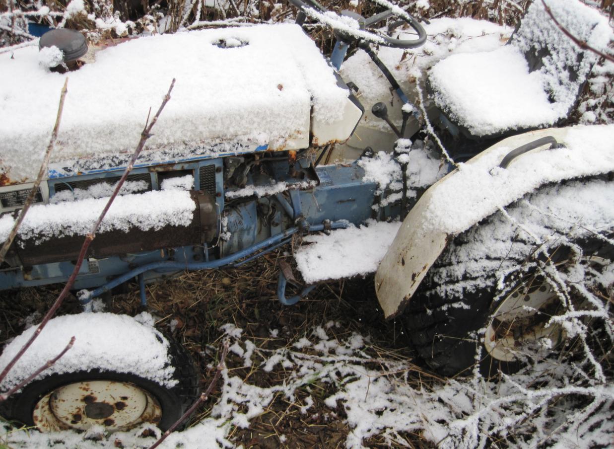

Here is another picture I took when I was there last week to see it. This was about a year after I took the first picture I posted.

I'm stepping out on a limb a little but I don't think the IH relationship came together until the Mitsubishi 160 and 180 models came out. 284 could probably give a better answer. If the snow picture is the later one at least they put the breather cap back on. Tell the guy you have 5 one hundred dollar bills.
I but the breather cover on after I saw the tractor the first time about a year ago when I took the picture in the first post..No idea how long it had been off before that. Kind of dumb that it needs to come off to open the hood, just asking for people to set it aside and not reinstall.
