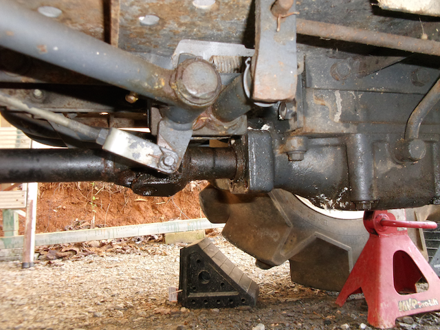

D1300FD Mitsubishi
Mitsubishi / sutoh/ beaver/ D1300FD

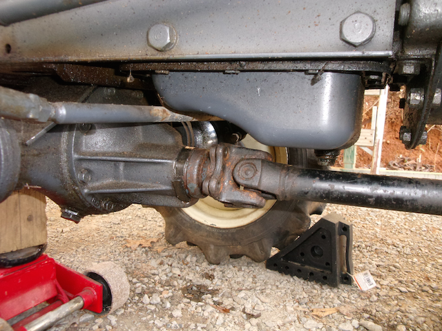

leaking at the drive shaft seal on the gear body. (drips about a quart over night).
?1 how to properly remove the shaft, I removed the 4 bolts on the back, & the 4 bolts on the front u-joint connector. Looks like a raised ring inside and a nut that is even higher, so to remove shaft - ...
?2 where to get the oil seal replacement, once I do get it off.
thank you (in advance) for any replies.

first how to remove shaft, since it has no spline/play, ?loosen axle?
second where to get replacement seal.
seems that there should be a list Somewhere that cross-references useable parts
any ideas?

called Valley, seems ya just gotta force it off (the drive shaft)
I have photo copied manual for 1300, but it doesn't show much about repairs. the photos are non-useable.
thanks for the answers ; :thumbsup:

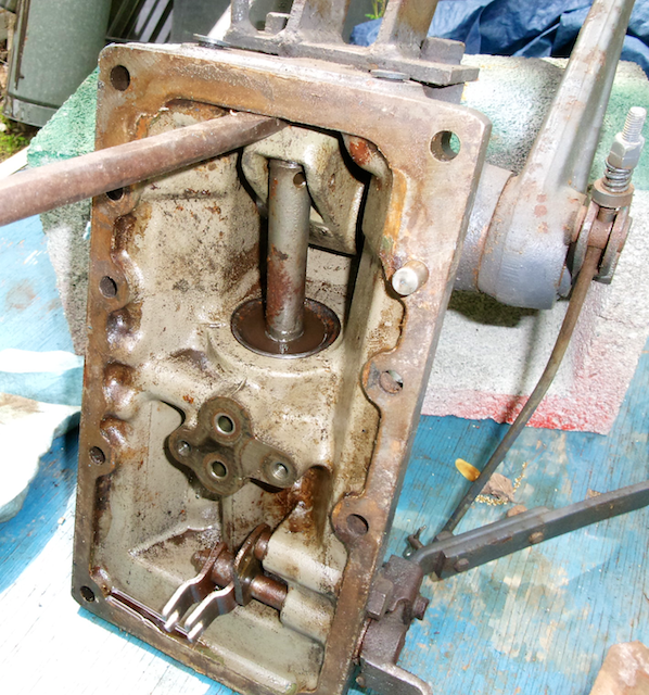

2000-05-07 at 02-13-42.png2000-05-07 at 02-13-53.png2000-05-22 at 04-13-31.png

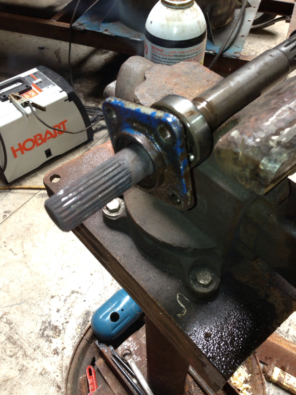

the two issues I am having Real Problems with are the 'how to properly remove the shaft' and how to un-lodge the piston that seems to be jammed with debris or rust. soaked it with penitent 3 days. any ideas on this one? can't get to it to pound on it much, and it is all the way 'up' so can't remove the shaft either.
thanks for the replies, they have been helpful.

If you are talking about removing the front drive shaft on a Beaver, I just accomplished this about 6 months ago. We removed lower housing below the trans. With the shaft still attached. Just unbolted from the front diff.
Then applied LOTS of heat. It's splined, no magic. Just really tight. If you need any insight, just ask.
Chuck

On the few larger model Mitsubishis I've had apart, the piston rod is a separate piece from the piston and just "sits" against the back of the piston and attaches to the rockshaft crankarm with a pin ( looks like you've taken that end loose). Have you tapped on the rod to see if it will come loose/out and give you more room?
You can also try removing the lift arms from the rockshaft and slide the rockshaft out. The rub is, there is probably a set screw on back of the crank arm ( assembly that rotates with the rockshaft that the piston rod attaches to) that will have to be removed. If you can't get to it, the rockshaft won't slide out. If you can get the rockshaft and crank arm out, it might give you more room to "tap" on the piston to break it loose? The rockshaft probably has a "dimple" on the ends that corresponds to a mark on the lift arms so you know how to orient them on the splines when they go back on. If not, be sure to scribe the arms and shaft to locate them properly later.
