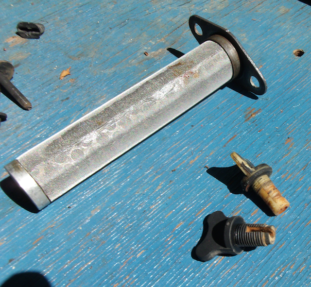

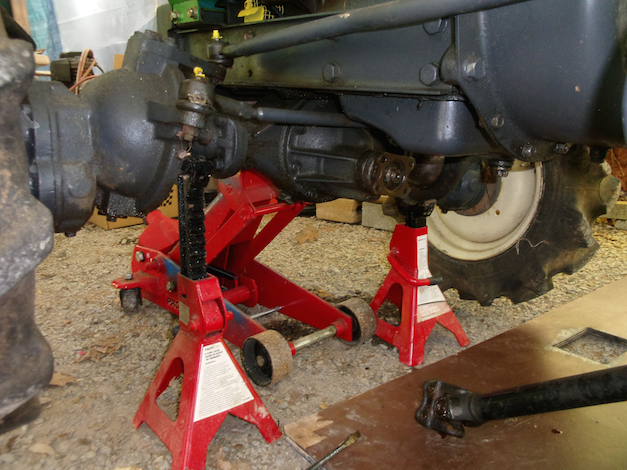

:confused2: the drive shaft is a real treat; 1. the shaft will NOT come out with out damage Unless you tilt the front axel up to the max on one side, this give the little extra distance that lets the shaft fall out. 2. the splines were rusted/ ceased and took heat and a big hammer to separate. 3. yes the transfer case Must be removed to access the seal.
all that for a $5 part. If you do this, be certain to also flush very vigorously the bearings and housings, an amazing amount of sludge and grime is in there.
B.T.W. remember the other gaskets: the seal, the seal bracket gasket, the transfer case gasket, the shaft cover two gaskets, .... and where most of the moisture comes from? past the shifter, right into the transmission = referb the shift boot.
I also rebuilt the hydraulic fluid screen, from a 6x4 210 mesh stainless steel screen.
