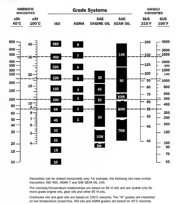

I don't know about the D1500 specifically, as you have doubtless noticed...My D1800 (Which I strongly suspect may be the same machine but with a larger output engine) has common transmission and differential lubricant. When you say upper and lower plug, do you mean on the top on and the bottom, or in separate areas of the housing? If there are separate drain plugs, I expect they are separate reservoirs. (Not always true, but possible.) At least some Mitsubishi/Satoh tractors did use separate reservoirs, I understand. I like to run differential oil in differentials, the EP additives seem wise to me in old, likely abused machines, or brand new ones.
If they are not separate reservoirs, in my own machines I run the JD303 equivalent UTF. Believe it or not, once warmed up the differential oil, UTF, engine oil, and gear oil are all quite close in viscosity.
I think the only real trouble is that until it has been worked around and warmed up by the pump, the gear oil is very thick and doesn't like to flow, while hydraulic fluid will flow better before it is warmed up.
The JD303/equivalent lubricants are designed for this application, so seem a good choice.
Make sure to grease everything for which you can find a zerk. The steering box also is lubricated, and are sometimes known to corrode, causing an expensive failure inside. Worse is if water has gotten inside and then freezes. There is also a grease point/points underneath the tractor where the front axle pivots. I use a moly grease, but that is because I am lazy and forgetful: the moly grease is specified for my motorcycles, and doesn't do a worse job for the tractors, automobiles, U-joints in all applications, machine tools etc. This lets me keep a pair of grease guns (a tiny one and a normal one) ready to go, and it can be used on anything requiring a grease gun. I've gone to 5W-40 synthetic engine oil for the same reason: Bikes, boat, cars, tractor all run the same engine oil, so I don't have to remember if I have enough on hand to change the oil in the _____ or not. 15W-40 or even straight weight in the summers have a lot to recommend them, too. As I recall, my D1800 uses a Napa 1334 oil filter. The air filter is the generic cartridge unit, number 2276. If you are able, if these are the correct part numbers, post that info up here, so the next person with the same questions has a single-source reference.

This can be highly debatable depending on who gets involved. I'm convinced that if you pretty much run *any* oil lubricant you'll be fine. Personally, I've never seen anything fail because of the "wrong lubricant" but I'm sure instances exist and I suppose it probably boils down to a matter of longevity in the end. The bigger problems originate by not having any lubricant at all or getting water/dirt contamination leading to rust/wear and their other associated consequences.

As is normal, I agree with Ilikeyourtractor. Clean, well-filtered, and uncontaminated oil is more important than the particular details of what it is normally intended to do. Clean ATF would be much better in your system than water-contaminated hydraulic fluid or differential oil.
