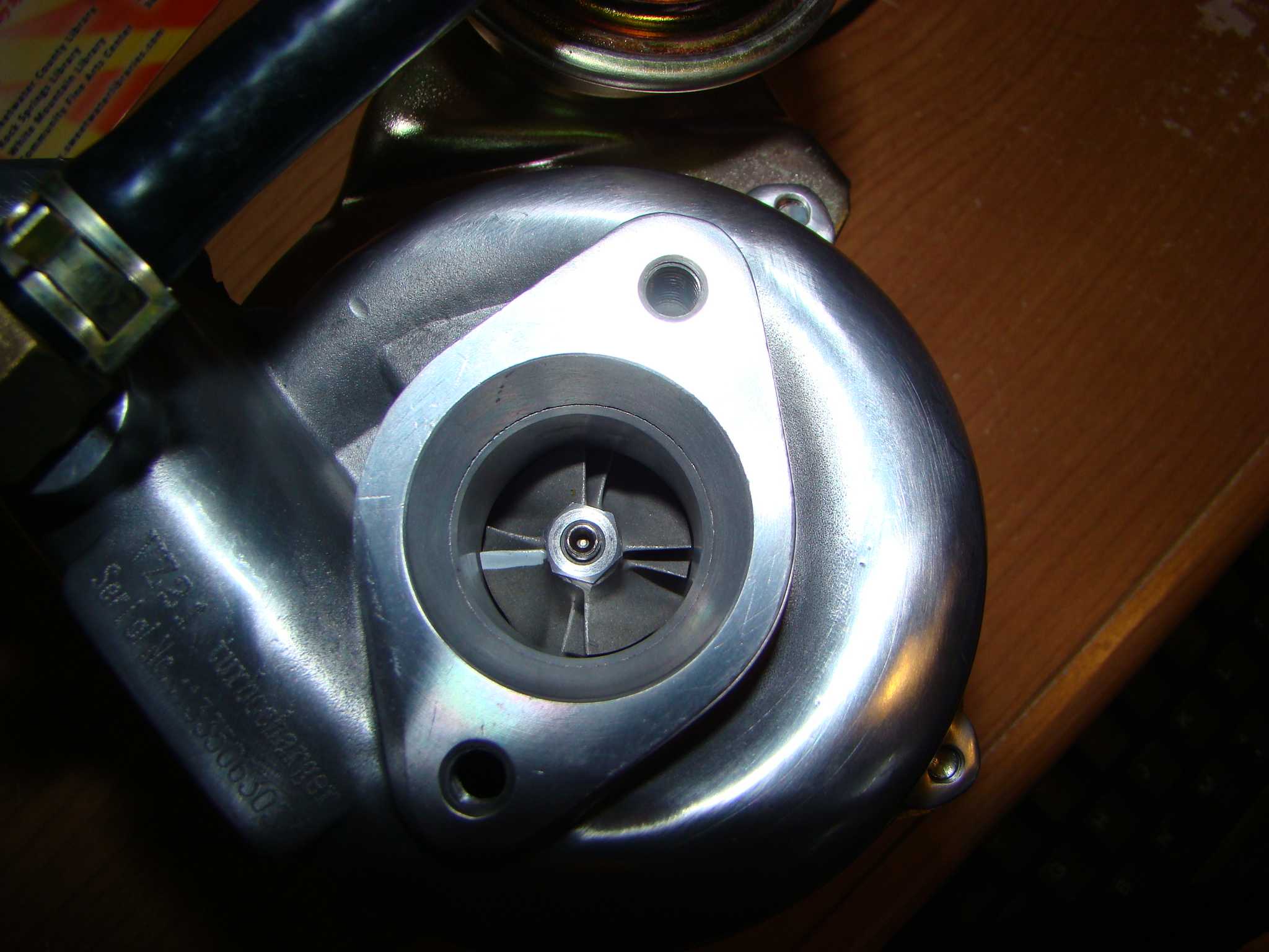

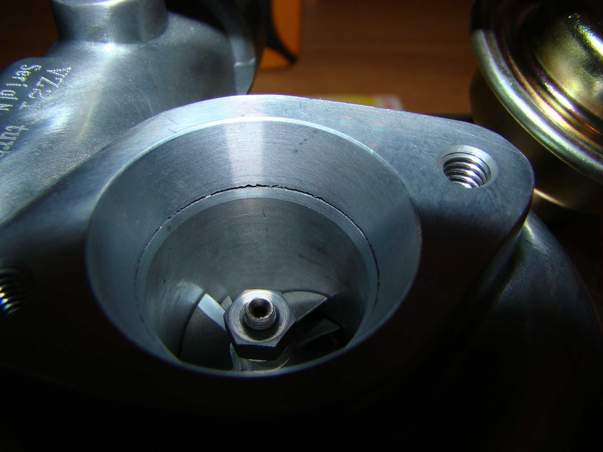

Got the smaller turbo today but looks like bad news. There is a cicumferential crack around the compressor inlet. Not sure how deep it goes, but I'm thinking it may allow leakage from the volute back to the inducer which doesn't help me get to where I want to be along with who knows what other problems it could cause. This will push the project out at least another week. I hope the seller doesn't shrug it off as "normal" otherwise we'll have a problem moving forward.

Here is the reply from the seller:
The compressor housing is a 2 pc design that "crack" is the seam of the two pieces. It is pressed together inside and has a good seal. There will be no problem.
Guess I'll find out...

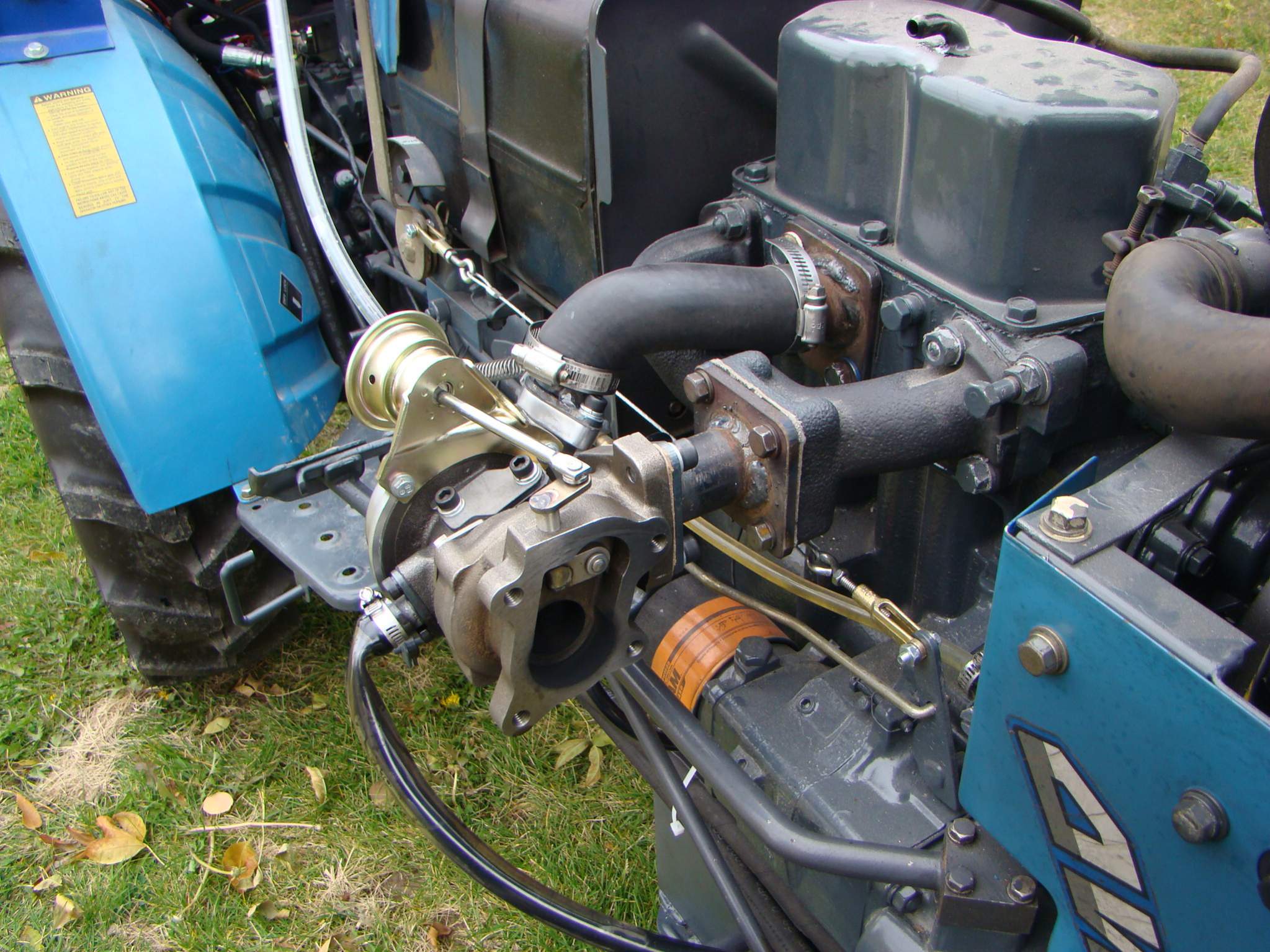

I should have some results late tomorrow. I had to go do some other things that caused me to pull off of this project. I have the exhaust side connected and the flanges ready for the intake. Now I'll need to find a hose at Napa that will connect up to the compressor discharge and the intake port on the head. Ideally I'd go hard pipe all the way but for now this is quicker and easier especially not knowing the outcome. I lost some time also working on the oil supply. This turbo uses a M8x1.25 threaded inlet for the oil supply and finding something that will work as an oil fitting on short notice isn't easy. I ended up getting a female 1/8" NPT to flare adapter fitting and machining off the flare threads and putting a M8x1.25 thread on its side. Now I can at least put a 1/8" NPT hose barb adapter on it and get some oil to it with a hose for now. If you search for VZ21 turbo you can find places that sell the correct adapter, and I would certainly get one coming once I know this works if I ever had to do it again.

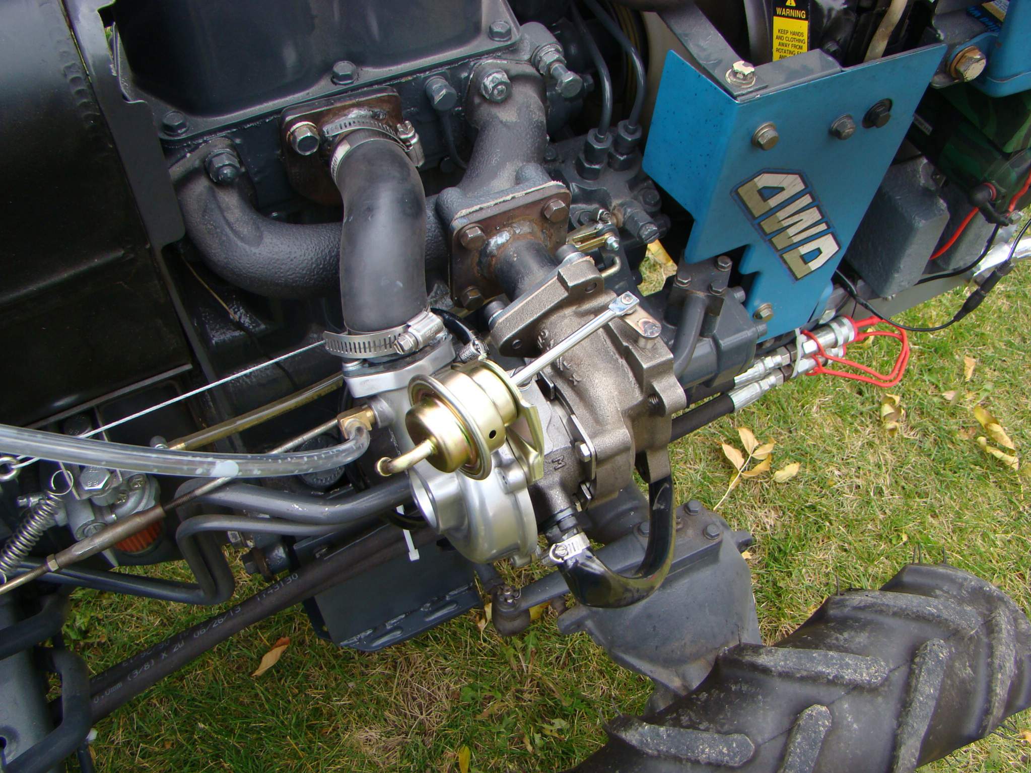

Here are some pics and a link to a video of the first tests. I guess the results are mixed - yes, it will build 5 psig boost at full rack under load so I suppose I accomplished what I was looking to do. I was hoping to do this more in the 2000-2500 rpm range but I'll take what I can get. Bottom line, in my opinion, is the turbo still appears to be too big and/or the turbine wheels are incorrect not that I expected it to be perfect, especially with this "trial-and-error" method I chose. I'm going to leave it on but I still have a lot to do before it's finished:
1.) The intake hose is resting on the exhaust manifold so I'll need to hard pipe it over or reroute the hose, or a different one. This will eventually require making a cut-out in the hood so it will close properly.
2.) Definately need something more robust for the oil supply and returns
3.) Need to install the intake filter and exhaust pipe (first task)
4.) Mount the boost gauge
5.) Paint up the piping
6.) Other things I can't think of right now (oh yeah, a turbo sticker in the end :))
For clarification, the video shows the tractor in 6th gear with the brake on and me letting out the clutch to put the engine under load to build boost.
