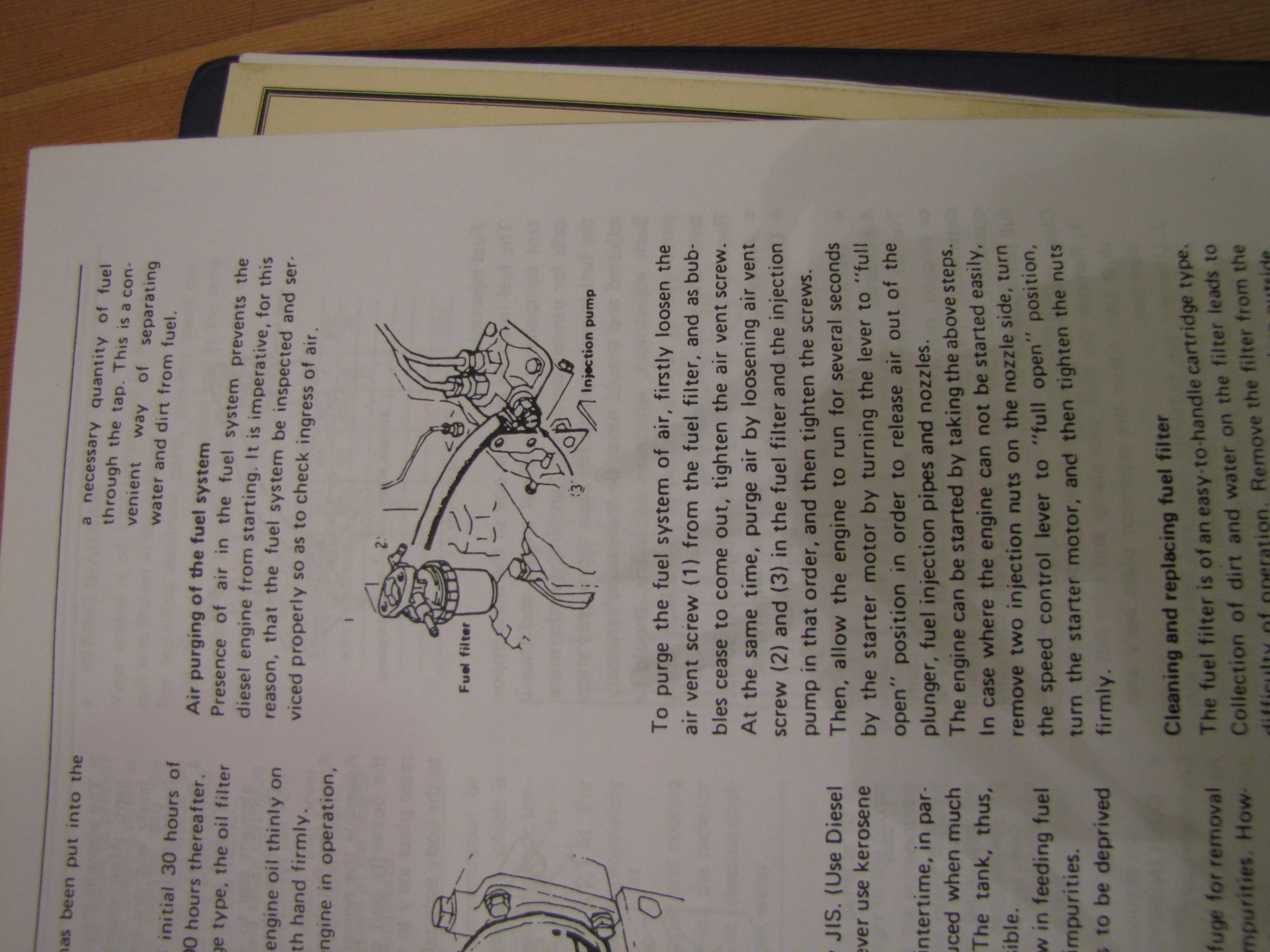

Hello I'm new here, hope I can find help. I found Diesel in crank case. both cylinders were trying to fire, so I think I can rule out a a busted cylinder. will fuel pump let fuel pass into block?
   / Mitsubishi mt372 #2
You might get a quicker answer in the Mitsubishi/Satoh forum. Generally though I think a lot of diesels have an oil seal in the injection pump. If it goes bad, diesel can get into the crankcase.

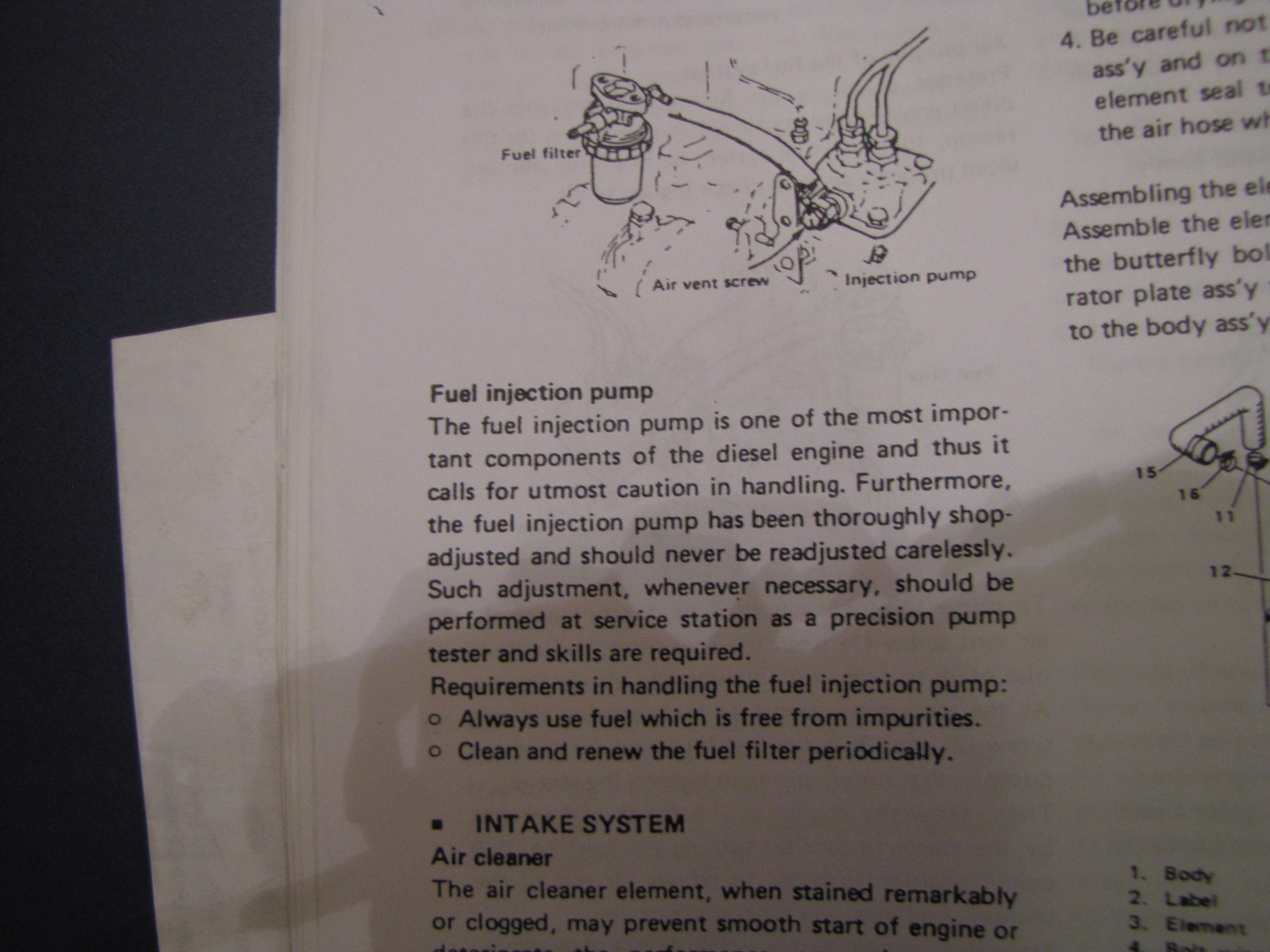

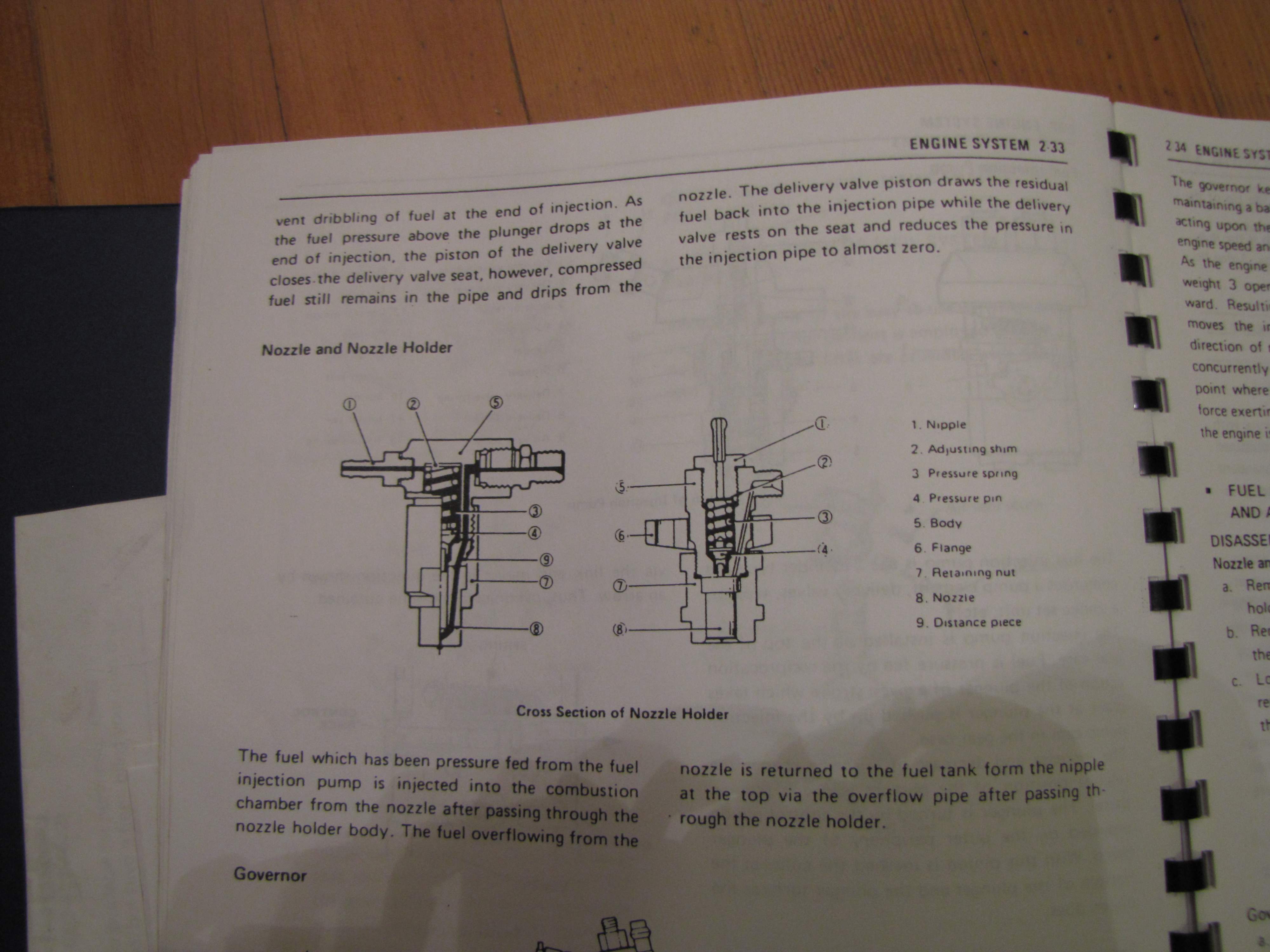

   / Mitsubishi mt372 #5
Your hypothesis seems like a good one. If you don't have a manual here are a few pertinent pages about the injector pump. They are photos of my manual, the best I can do. IMG_2035.jpgIMG_2032.jpgIMG_2033.jpgIMG_2034.jpg

Thank you Skylarkguy, I'm on my iPhone now and can't read pages, later I'll check it out on my laptop. Is there another way for fuel to get into crank case?
