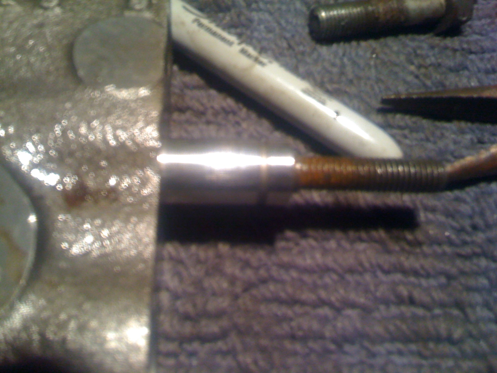

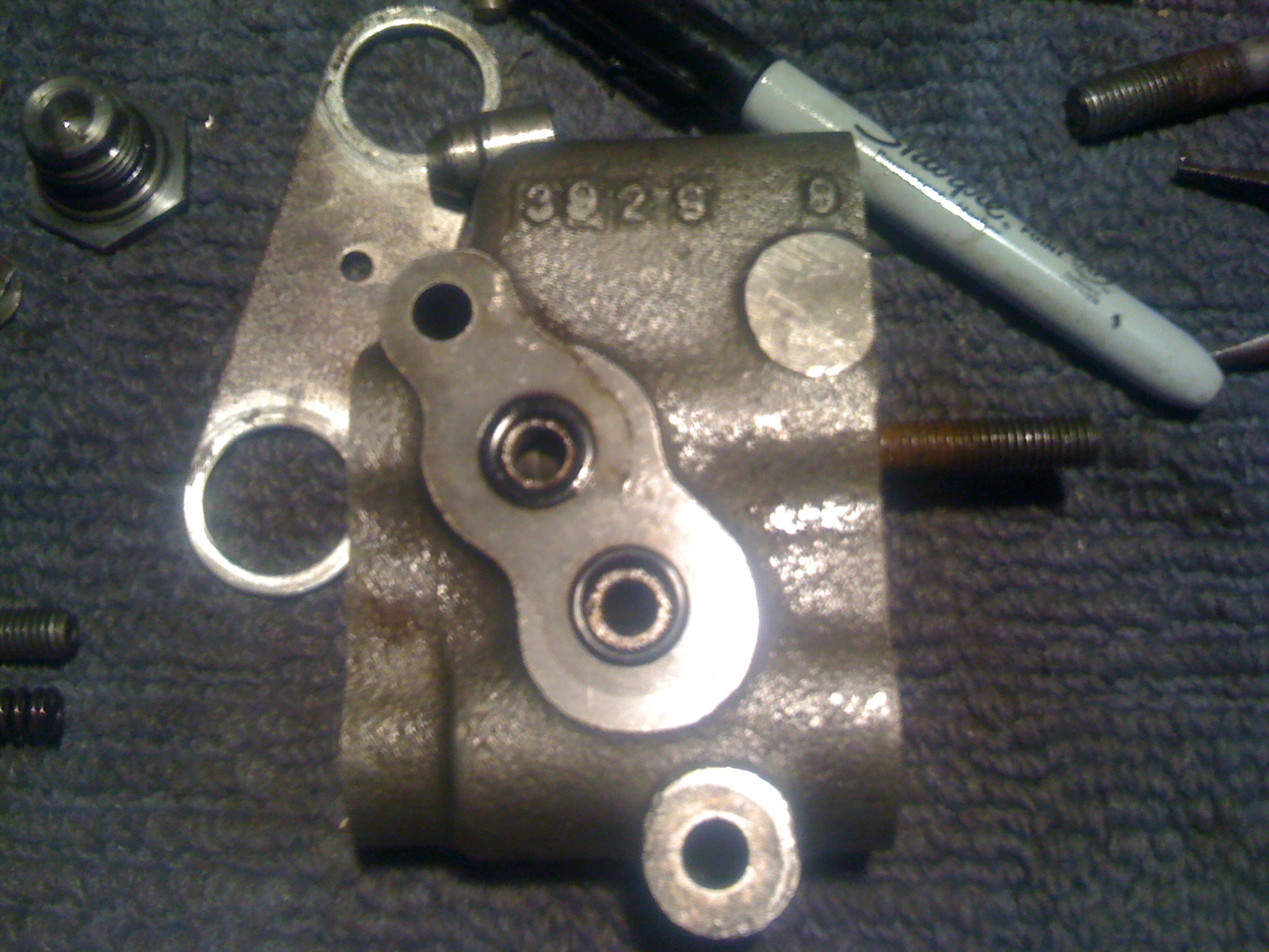

I rebuilt as best as I could with new o rings, still no fluid going into the cylinder. I have fluid coming from the pump with a really good flow, I am just wondering if even though the flow rate is good, if it is not putting out enough pressure charge the cylinder. Attached are some pics. I am wondering if some seals are missing from the internals on this bad actor.
What you see in the pic are the main plunger in position and another with it in the out position. Seems there is a slot there for some type of seal, or is this for allowing fluid to pass through the internals of this valve.
If anyone has any ideas on how to get these hydraulics working I am all ears. Thanks.
