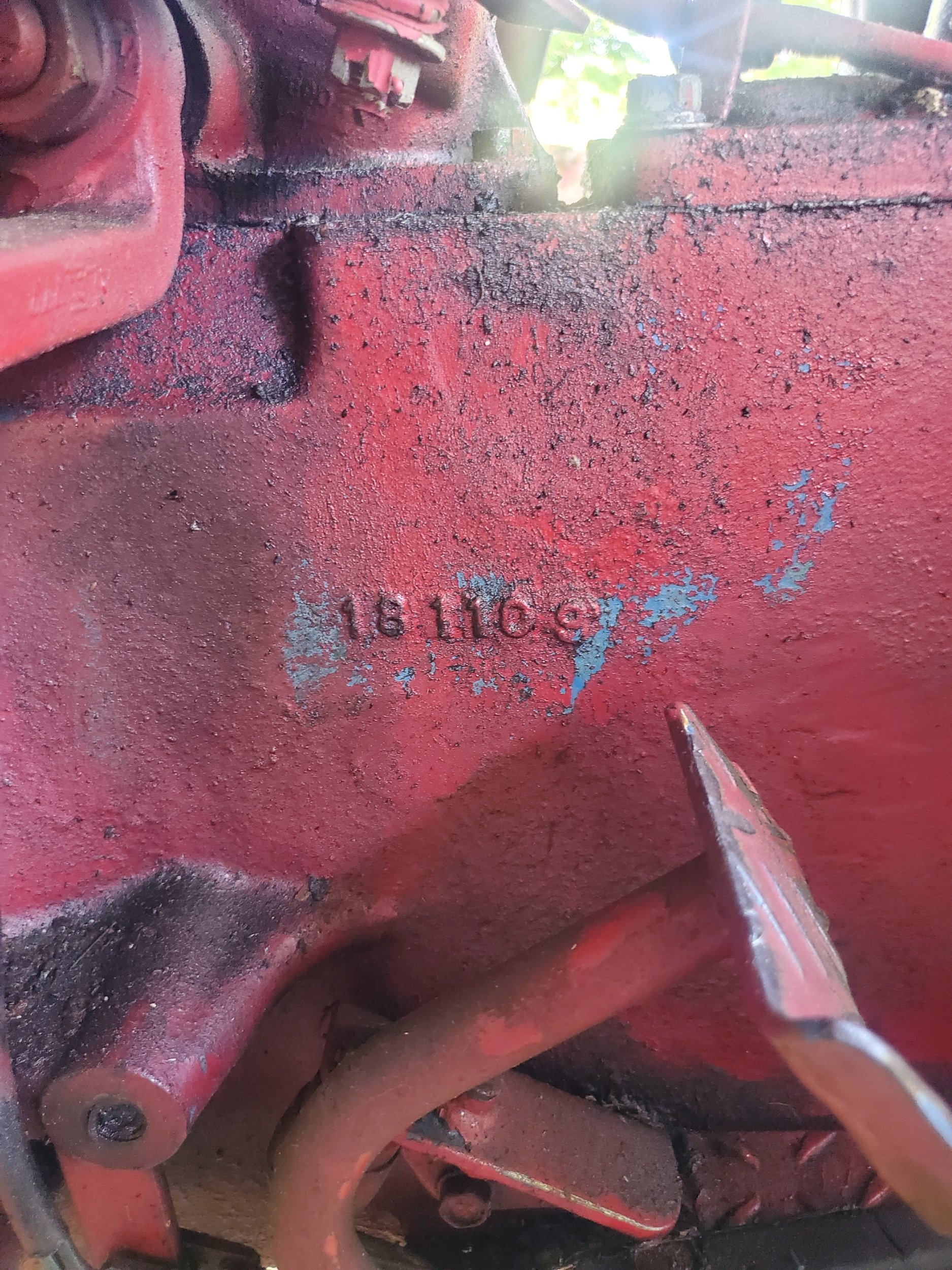

I have a Mitsubishi Satoh s630 bull and I can't find any replacement parts. I need a clutch kit. The motor is KE130. Help!!??

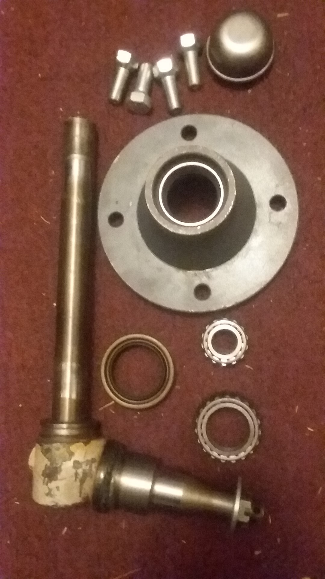

We are repairing 2wd front spindles. The pictured spindle is for a D2350. This is a new axle shaft with tapered roller bearings, seal, wheel hub, axle nut, cap, & bolts. This is not a welded broken axle shaft. If you have a broken axle contact me at parts@sheaftractor.net.
