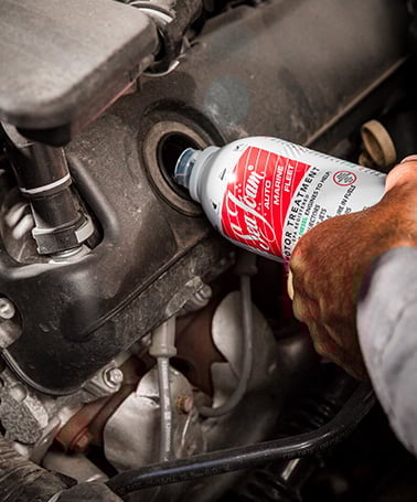

I don't have any drain oil but if I did I would
add a quart some sea foam for every 5 gallons
of diesel I put in the tractors tank and wouldn't
be afraid of any problems I only use quality filters
I am not a wally world fram filter man!
Like it was said before oil straight out of the tractor
and that added to the diesel tank on your tractor you should have no problems as it is getting filtered again. Don't quote me but I believe that a fuel filter will filter fined stuff than an oil filter!
When they can filter McDonald deep fryer oils to burn in a diesel engine with no problems what makes you think that drain oil will harm a diesel engine?????
Do some research and you will find out you forgot to
engage your brain before opening your mouth!
ADD SEA FOAM TO YOUR MOTOR OIL!
