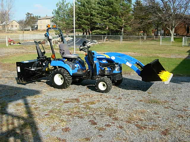

Just info on the Meteor blower.
My unit came with an Electric chute rotator and the motor crapped out after two years from corrosion. After some research I found a better replacement option than paying Meteor over 400 dollars.
The motor is essentially just a winch motor (2000 lb) same as Superwinch uses and You can buy the entire winch unit for under 80 dollars. Drill and tap two holes and it is a direct replacement.
Now I always have a backup on standby for when the next motor croaks.
And then last year the control switch unit died so I simply wired in the winch control as a replacement.
