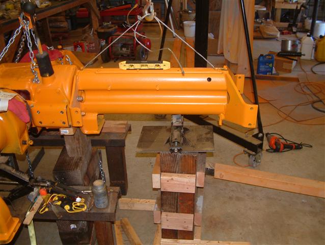

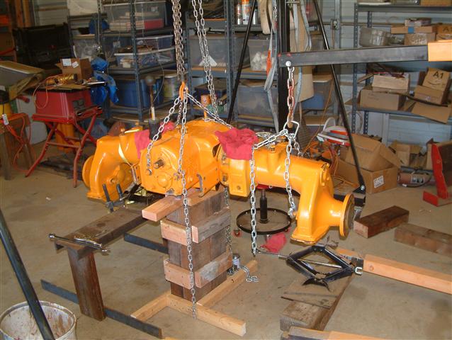

More progress on the rear end reassembly. Got both axles reattached to the differential case a few days ago.
Then the 24" long propeller shaft onto the transmission input shaft. Held on with stout cotter pins. The new U-joints have grease zerks unlike the old ones that were permanently lubed.
Next, the torque tube gets attached to the tranny case via four bolts
Next attach the wheel hubs

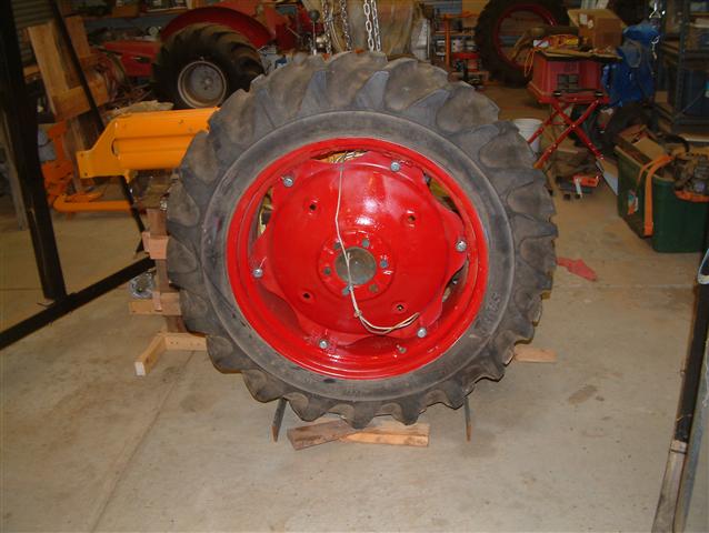

Then attach the left rear wheel
I'm hung up on the right rear wheel because the valv core is stuck and I don't have the right tool to get it out. Ordered a screwdriver type core tool from Amazon. Should be here in a few days. Don't want to install that right rear until I'm sure the tire holds air. The left one is fine.
One of the reasons I grabbed this BF tractor was because the rear rubber is in excellent shape. Paid $1300 for the tractor--the rear wheels are probably worth $600-800 on CL or eBay.

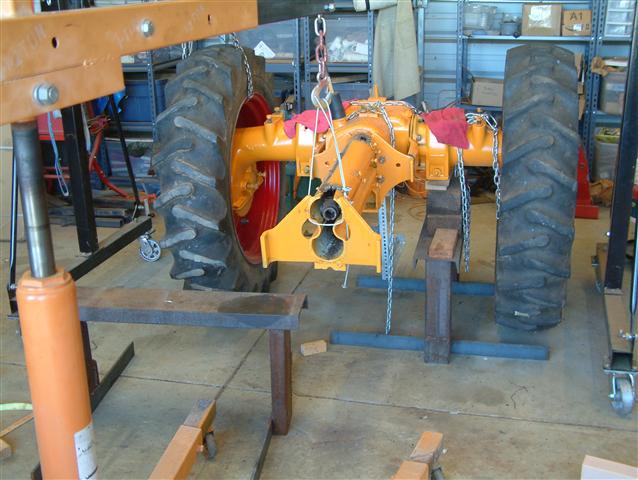

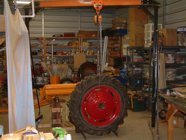

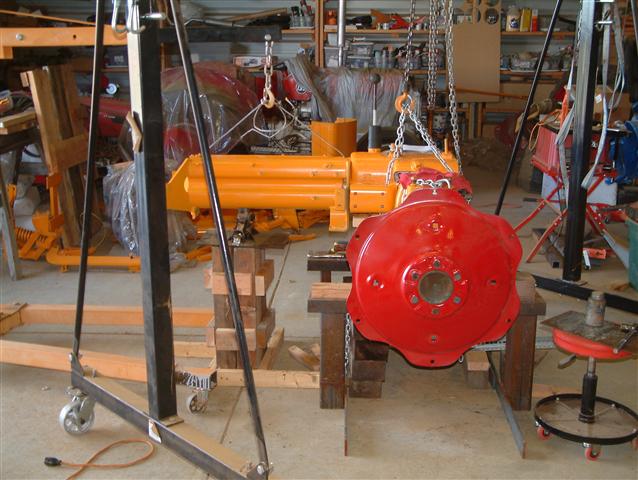

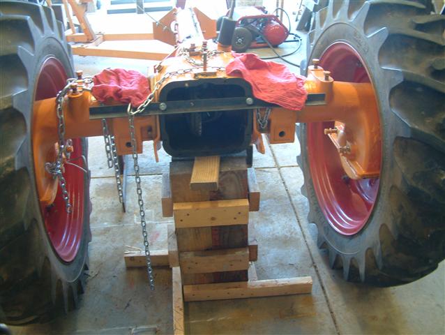

Managed to get more work done (Thanksgiving holiday travel slowed things down in the shop).
The rear end of the BF is back together. The jacks have been removed and the rear wheels are once again on the ground.
With those bull gear axles and no engine weight on the front, you need to support the rear of the tractor to keep it from doing a back flip.

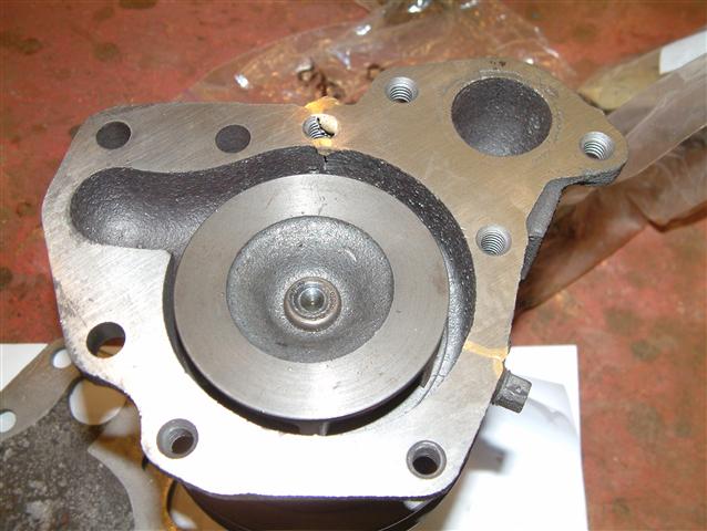

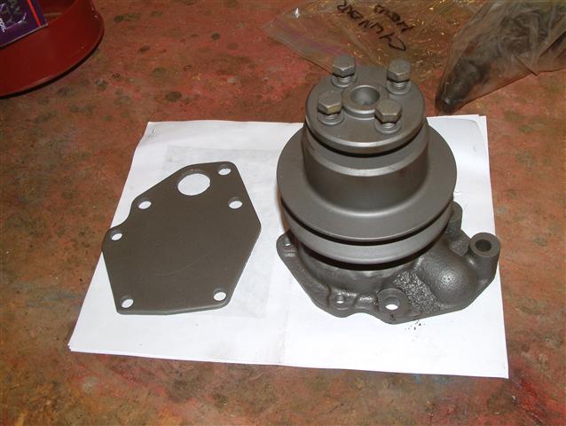

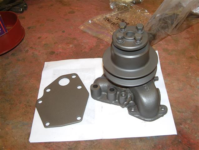

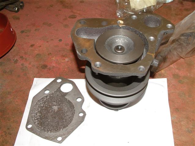

The rebuild kit for the water pump arrived. Problem: the pump shaft is frozen in the bearing and the bearing is rusted to the cast iron pump housing. Couldn't get the bearing out with my press so off to the machine shop. No problem getting the old bearing out, but the housing cracked in half. Not to worry--Ron, the machinist, brazed the housing together, installed the new parts and cleaned up the pump so it looks like new.
DSCF0078 (Small).JPGDSCF0079 (Small).JPGDSCF0080 (Small).JPGDSCF0081 (Small).JPG
Glad it turned out well since I haven't been able to locate a supplier for that complete water pump, just the rebuild kit.

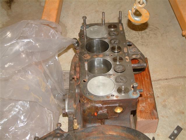

Next step: reinstall the flywheel, attach the engine to the service stand, install the head.

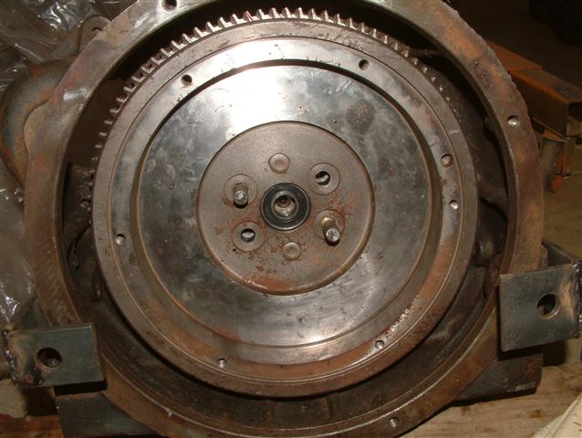

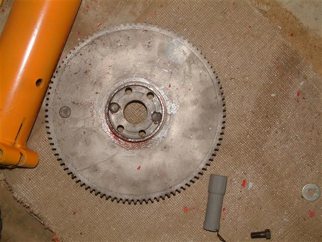

Christmas holiday is over so back to work--flywheel installation.

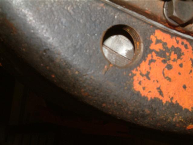

The timing mark is on the forward face of the flywheel (highlighted in white near the 1 o'clock position)

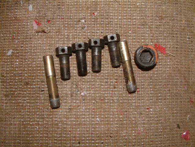

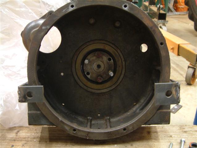

Here are the fasteners--four bolts with holes for safety wires. I made two studs for installing the flywheel by cutting the heads off long bolts. The plastic cap covers the timing hole on the flywheel housing.
The big hole in the housing is for the starter, the small hole is for timing. You can see the large seal between the flywheel housing and the flange on the end of the crankshaft.
The flywheel is installed with pistons #1 and #4 at top dead center (TDC). This sets the timing mark in the right location (opposite the timing hole in the flywheel housing).
Next, install the two studs and slip the flywheel onto them (makes the job a lot easier since the flywheel is pretty heavy). You can see the pilot bearing in the center of the flywheel.
The timing mark now is aligned pretty well with the timing hole on the flywheel housing.

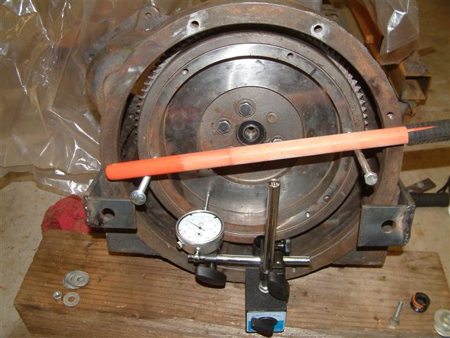

Checking the flywheel wobble with a dial gauge (has to be within +/- 0.005"). The two long bolts threaded into the flywheel and the short steel rod make it easy to spin the flywheel for this measurement.
Finally install the safety wires (0.032" dia stainless steel).
