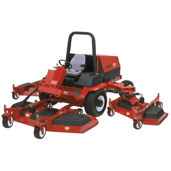

Mosey,
I found what you need: 80 hp, 192 inch total cutting width. Mid-mount offset mowers on both side.
- Rick

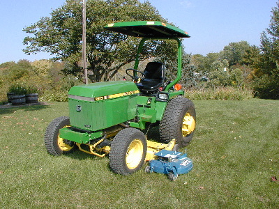

This photo shows the Flex-Deck mounted on the 60-inch deck on my JD 955. It works great!
   / MMOM (Mid Mount Offset Mower) #8
Nice add-on! Is it just my eyes, or just the photo, or are your front wheels dished out on the 955?
   / MMOM (Mid Mount Offset Mower) #10
Both the front and the rear wheels are dished out. This makes the overall tractor width 60 inches which improves lateral stability on side slopes. This is approved by JD. I also have 3 wheel weights per rear wheel (60 lb per weight).
