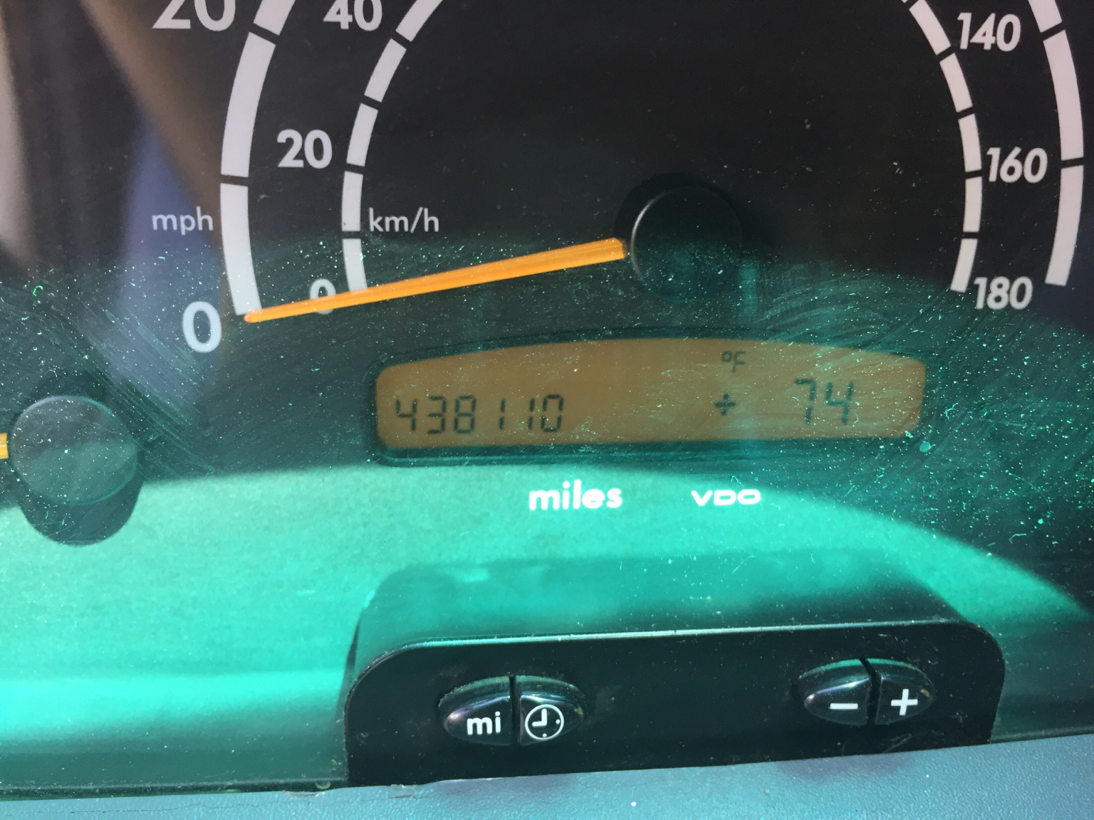

I've recently standardized on M1 0w40 for the Kubota and the wife's VW Passat (gas) ... after I ran it in the van (2006 Dodge Sprinter with a Mercedes 5 cylinder diesel)
Supposedly it was the OE factory fill on the van. Van has roughly 438,000 miles on it and only had one oil change in that time with a different oil (M1 5w40 Turbo Diesel Truck) ... all the rest of them were M1 0w40.

At 250 hours and 15,000 miles there couldn't be any idling time. That would be virtually 100% highway driving, which is very easy on a Diesel engine and its oil. I don't mean to sound standoffish but your numbers seem a little suspect. Are you also implying that you have 420,000 miles on your diesel?
No, I wasn't implying that at all - if you noted my earlier post (before the one you replied to) I stated that I have over 438,000 miles on it:
