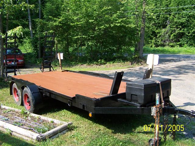

I built one a few years ago using 2 - 6000# MH axles. In NY it takes some paperwork with the state to get it titled, then it has to be inspected at a state inspection center (DMV) facility. They mainly want to see if it was constructed to be safe on the road. They will issue a title after inspection. If over 3000# you must have working brakes on at least one axle and you cannot use MH tires. You have to buy trailer tires. They won't inspect if they see MH tires on it. MH axles are mainly built for limited use and repairing / replacing brakes can be an expensive chore since most items are welded or riveted in place.
