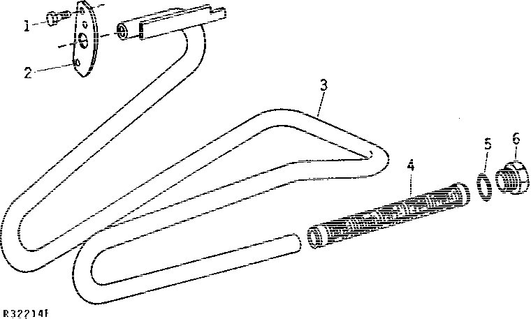

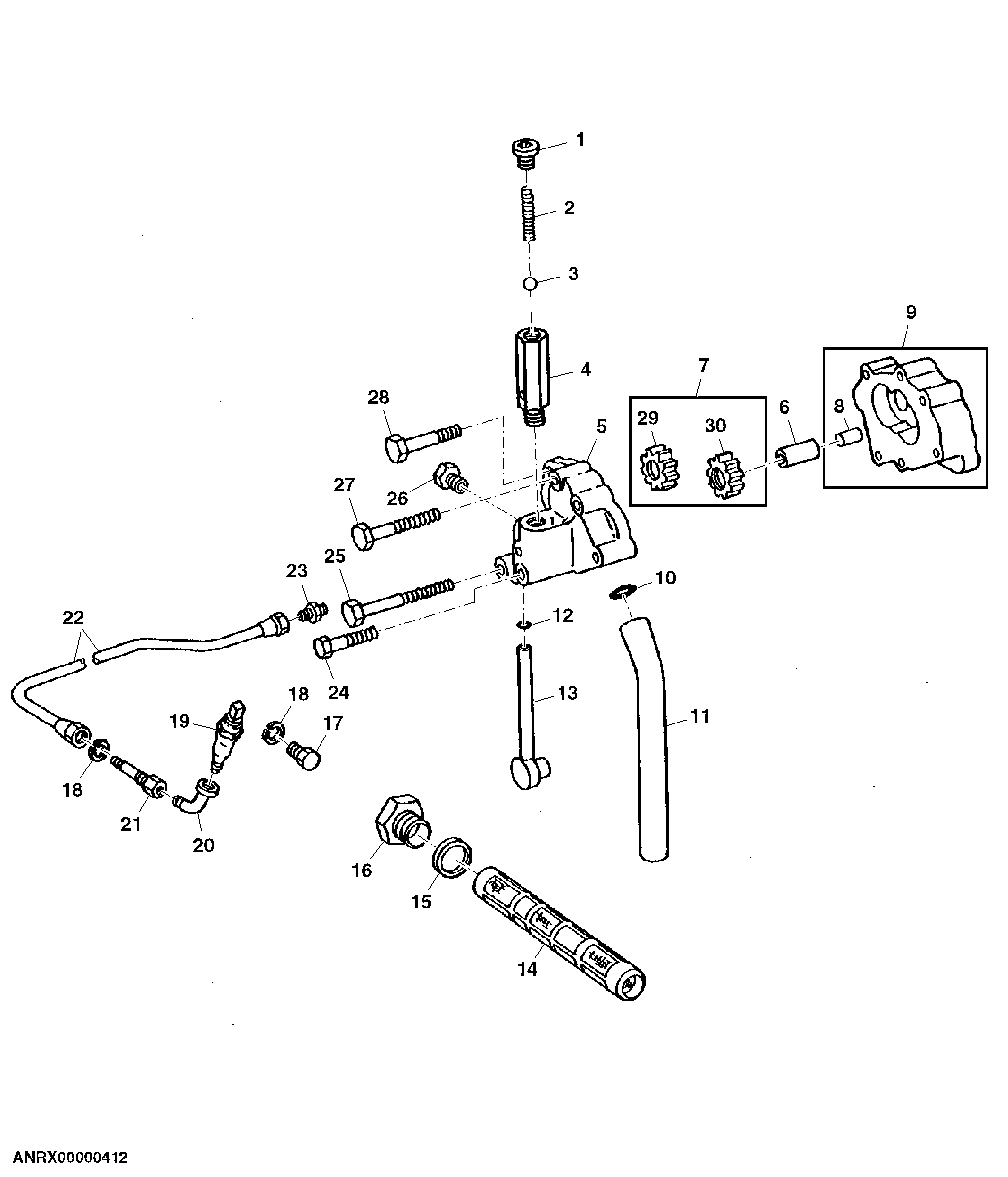

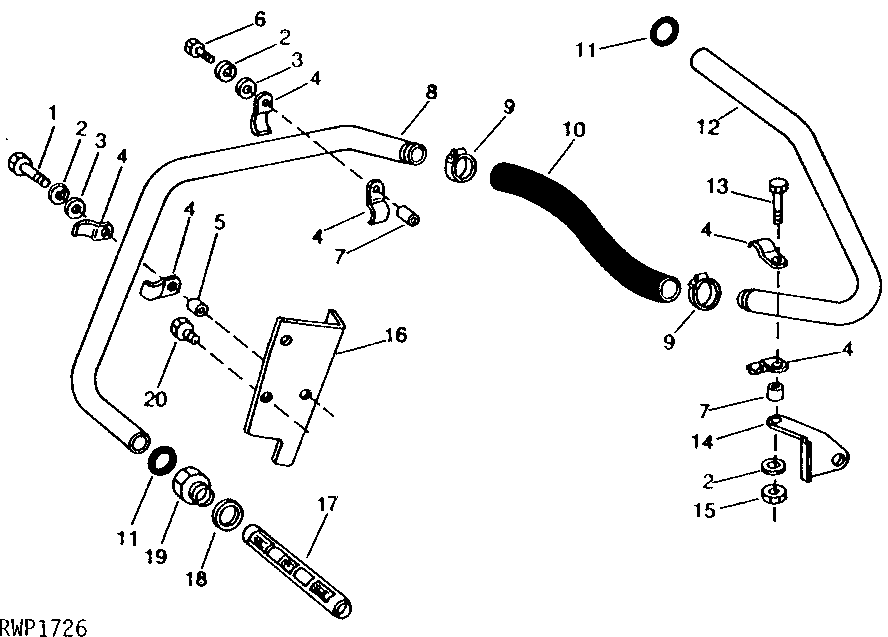

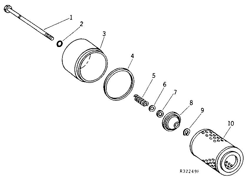

jOHN DEERE 8640
Hi! I'm new to this site! I do own a new Mahindra 4540, and love it! However, I do mobile repairs on about anything diesel. Right now, I have a customer with a JD 8640 that has hydraulic problems. I'm told that I need to pull the 3 stacked pumps that are located on the rear of the front section, behind the filter base. I have no idea what I'm getting in to. I cannot afford to buy a manual for every type tractor that I work on, so can anyone help me with this? I really don't want to open a can of worms that I can't put back in the can! Anyone?

First I would post in John Deere AG Tractor section
Second describe problem and why you think these pumps need to be pulled.
Third look in JD's online parts catalog. I looked, and found these drawings.
I will say I have never seen or worked on this big of a tractor, but from what I saw on JDparts.com:
I would start with checking/cleaning or replacing all shown screens and filters before tearing out internal pumps.
Then, if problem persists (after clean/new screens/filter) dig deeper.
GOOD LUCK!

For the drawings in the above post, (I never know what order they will load):
Drawing 1 clutch pump screen key 17
Drawing 2 Transmission pump screen key 14
Drawing 3 Transmission filter key 10
Drawing 4 Transfer pump screen key 4
