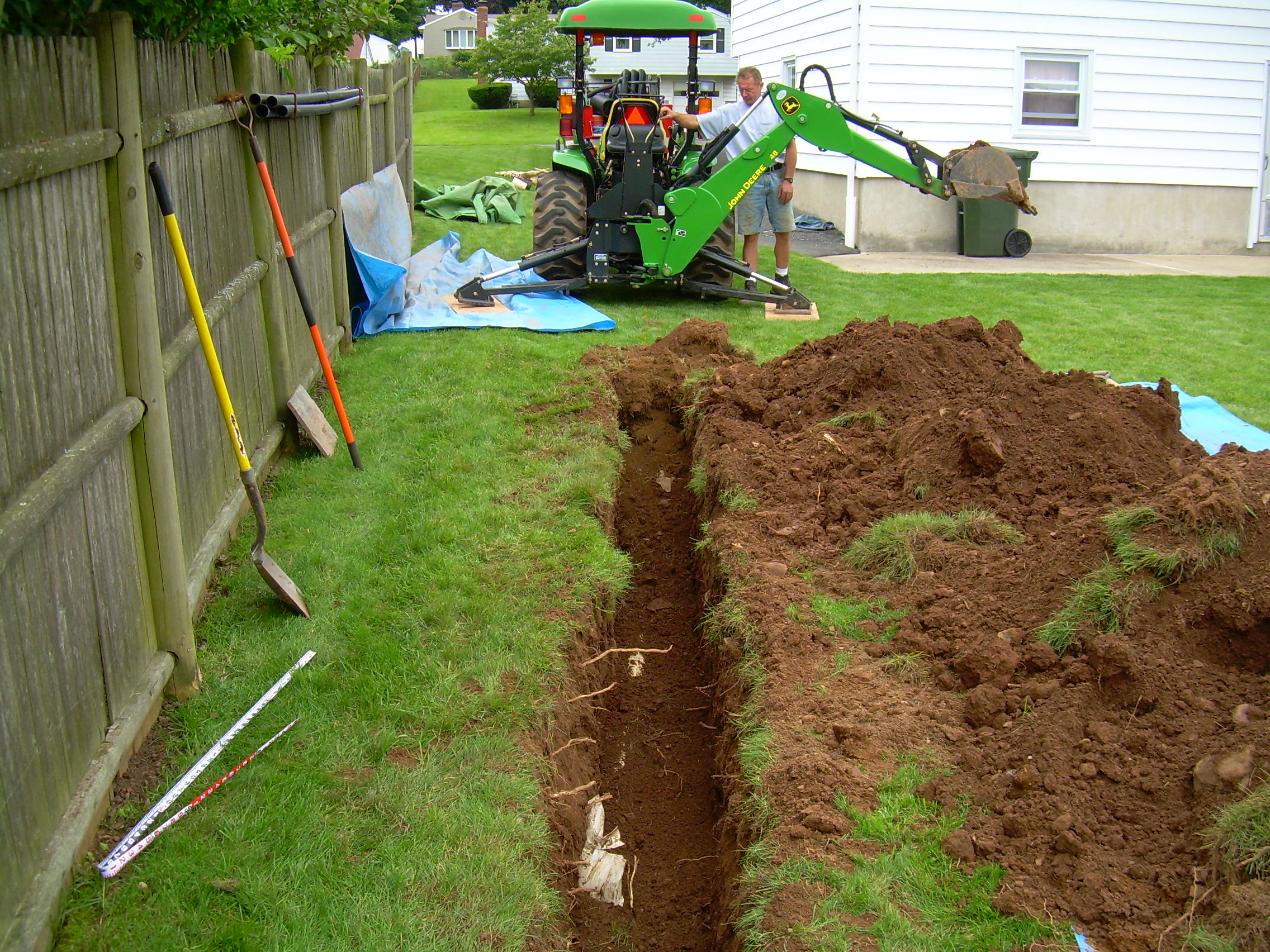

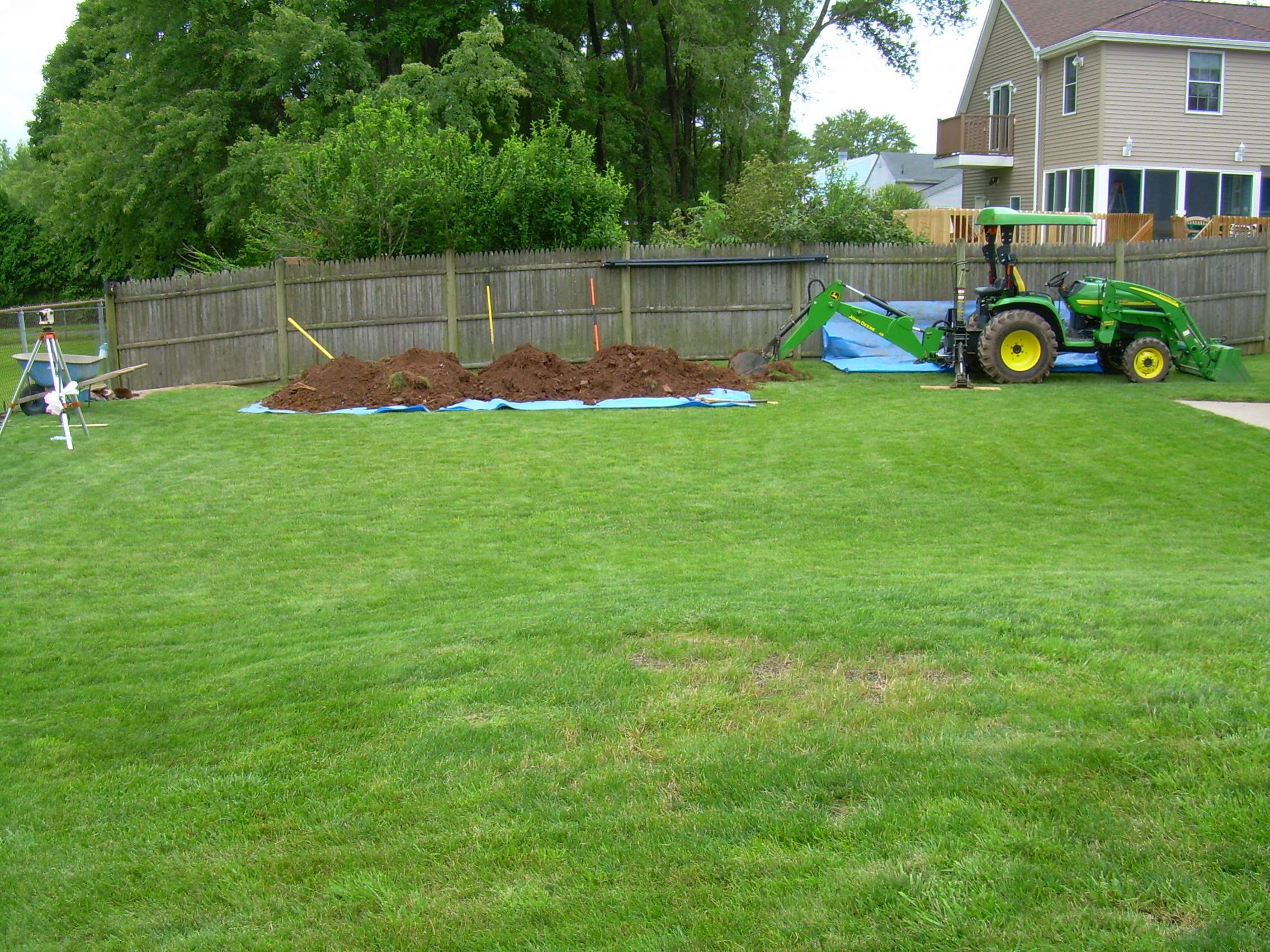

That looks like an old 8 hoe, on maybe a JD 1050? Look at that subframe....
you can see a bit of it in one photo.
Anyway, I have made subframes for 2 of my hoes on 955s, and they
were not hard to make. The hoe is a clone of the Woods 7500, but
this one is a good deal heavier because it has more steel and uses
2 swing cyls instead of one. It is in the same class at the 8, or 48, or 448
from JD. It weighs a bit more than the 48, but it is not bigger.
$2K is a good deal, as long as it has no rust on the cylinder rods, and
the hydraulics work. You can't use his subframe, however.
Here is my 955/PrairieDog, and one of the subframes I made.
