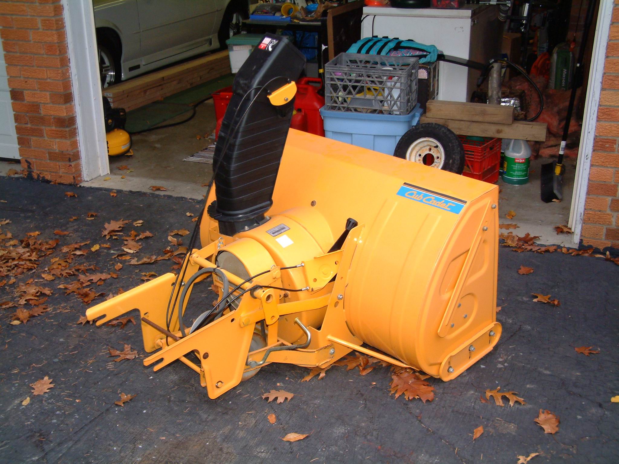

Model 551 CC Snow Blower Drive Belt Problem
I just burned through my second drive belt on my model 551 snow blower. The first belt lasted 7 years, then snapped last week (it looked old). I bought a CC brand replacement belt and it snapped in 1 hour. While installing the new belt this morning I made sure that everything was moving freely in case the first failure was triggered by something getting bound up. Everything moved freely and the new belt (other than being a little stiff -as I would expect a brand new belt to be) went on fine. However, after only about an hour this morning, bang! It snapped in half and was separating in two other spots. This particular application requires the belt to twist 90* in a span of about 9" on either side the blower housing as the belt transistions from the blower drive pulley onto two idler pulleys as it twists 90* again again as it transitions on up to the main drive pulley on the front of the motor. That seems pretty severe for a stiff belt like this, but the last belt lasted a long time with no trouble traveling that route. I wonder if the new belt was TOO stiff.
Anyone got any ideas? Is there a superior brand of belt I should be using or did I do something wrong?
Also, anyone ever hear of a steel or kevlar reinforced drive belt?

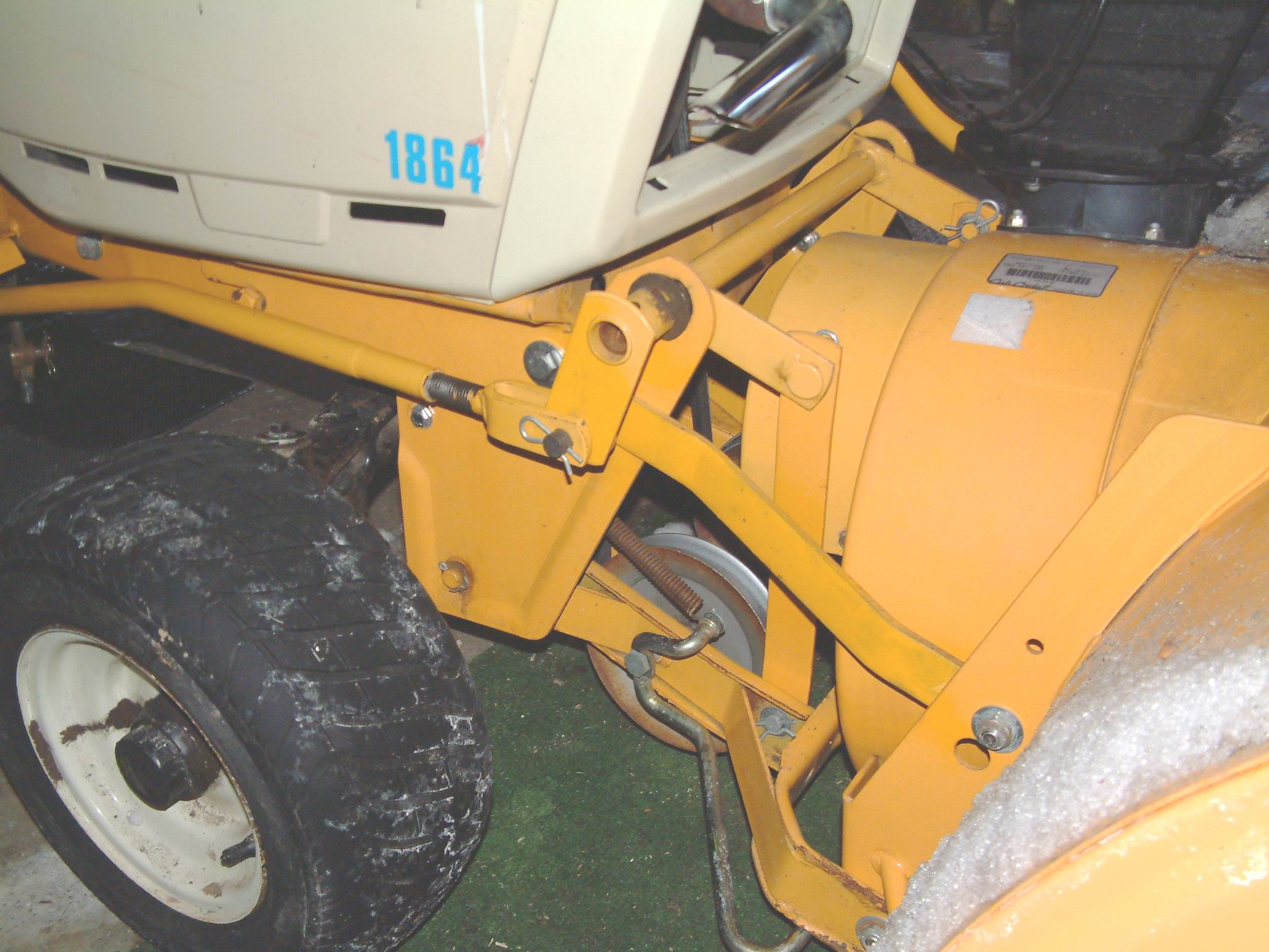

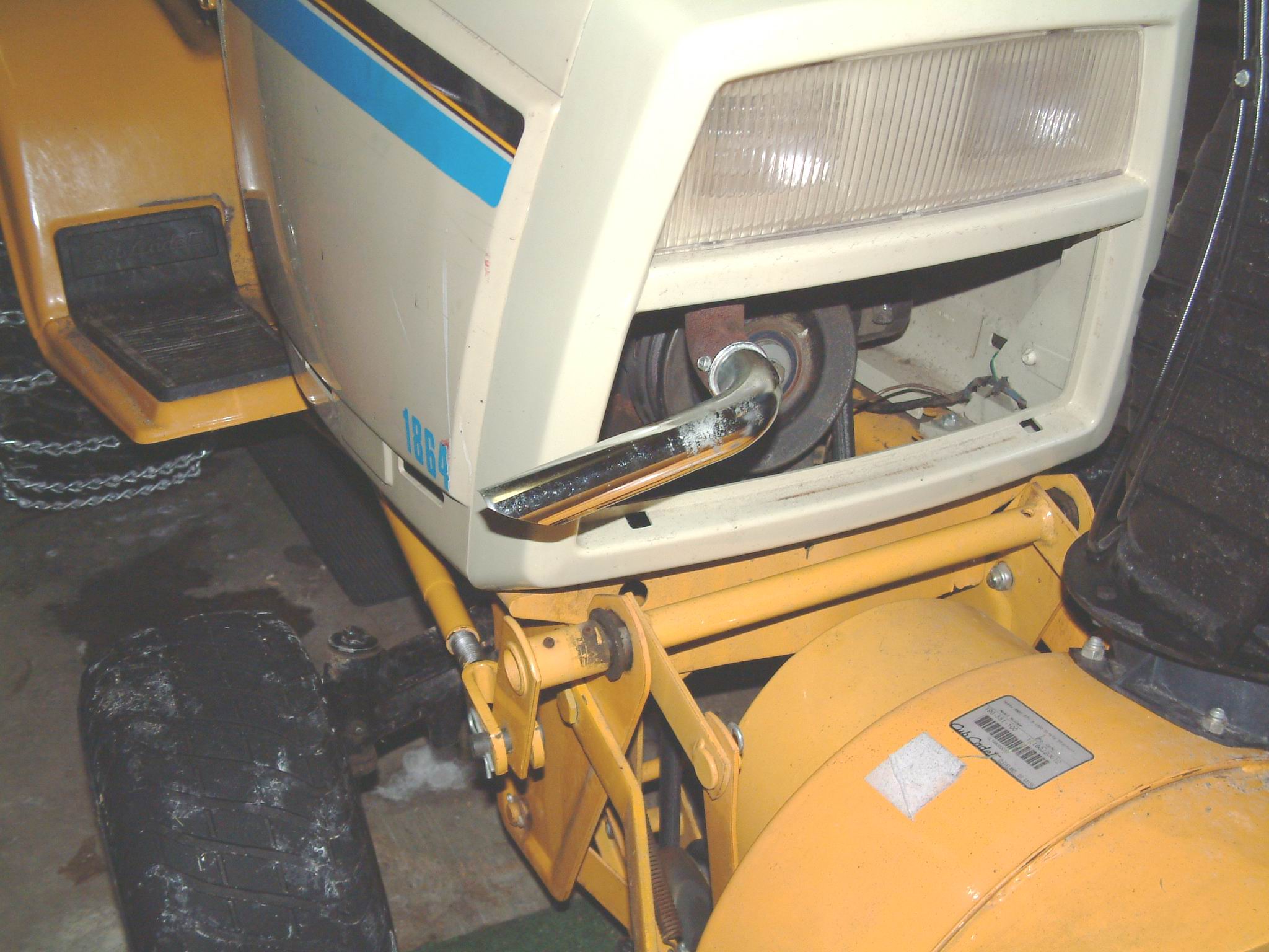

/ Model 551 CC Snow Blower
#18
Well, I found part of the problem: sometime this season (probably when the first belt let go) the moveable idler pulley arm got bent -meaning that the pulley itself is no longer aligned with the main drive pulley on the blower. This is particularly important because there is only a short distance between It's bent about 1.25" board making it impossible for the belt to remain on the idler pulley with the PTO engaged. I couldn't see the misalignment with the blower on the tractor (which explains why I lost the second belt so quickly after replacing it -the blower was still on the tractor when I replaced the belt) and it only became apparent what the problem was after glancing at the blower from this perspective. This idler pulley swivels freely around its pivot bolt and can contact the ground without a belt on it. I remember the pulley getting pinched under the tractor when I lost the belt earlier this season and that's probably when the idler arm got bent (shame on me for not assuming an 800lb tractor MIGHT bend a 3/16" thick piece of metal -and conducting a more thorough inspection at that time). Regardless, this may make my theory about the idler pulley spring baseless, but I'll probably go ahead and install the heavier spring anyway. I guess it can't hurt at this point!
#19
This was my 'fix' for this problem:
The root cause of my problem was indeed the bent idler pulley bracket. Knowing that this type of failure was likely to happen again over time, I welded a small length of angle iron to the idler pully arm to prevent it from bending again (even under the weight of the blower). That solved my problem.
