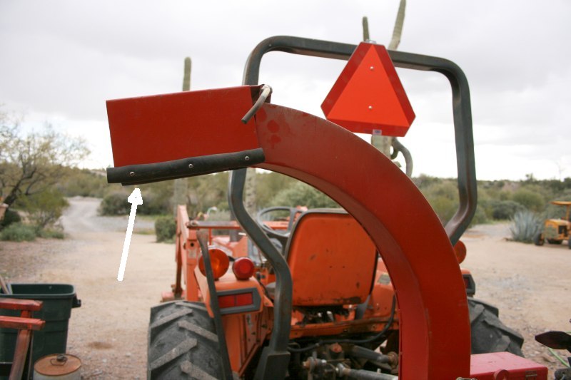

Great ideas for mods! I too have added a small toolbox and just today I added some skull protection. Seems like every time I walk by the chipper, I hit my head on the discharge chute. So I slit some heater hose and screwed it onto the chute.

I like it! Although I've never personally smacked my noggin on the discharge chute, I can think of a bunch places where heater hose would provide some protection.

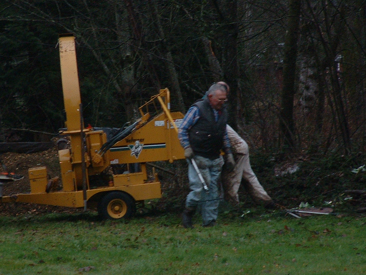

A good idea would be to put on a hard hat, ear protection, and eye protection. I wear those around my chipper when ever I am running it. Branches getting tossed and chips flying are the reason. My chipper chute would be hard to bang your head on though.
PS: That's my Dad walking away in the picture
