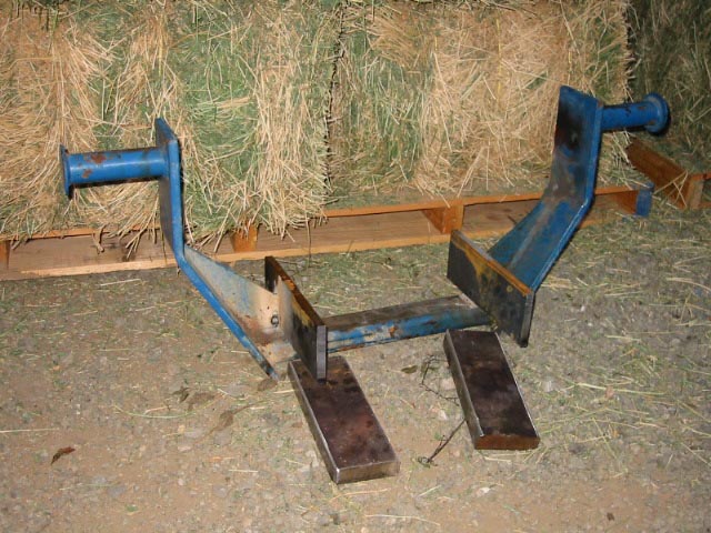

After a bit of a break I started to work on the loader mounts today. I finished the rerouting of the hydraulic lines, drilling of the rear loader brackets and welding and test fitting of all of the rear mounts.
Here is a photo of the rear mounts that I fabricated. In all, the rear brackets weigh 214 pounds, use 32 hardened bolts and are mounted in 20 threaded locations in the frame, engine, clutch housing and transmission. I was quite a challenge to get them all lined up.

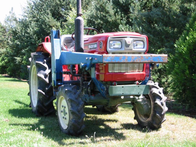

I finally got back to work on the loader project.
The front brackets have been attached to the tractor and the loader frame is fitted to the brackets.
At this point all of the difficult fabrication is complete. Now I just need to clean it all up a little with a fresh red paint job and finalize the hydraulic connections. However, I am going to build a new bucket for it. My narrow gates and rows of fruit trees won't accommodate the 5' wide bucket that came with the Ford, so I will make a 4' bucket this weekend.

#28
Here is the photo

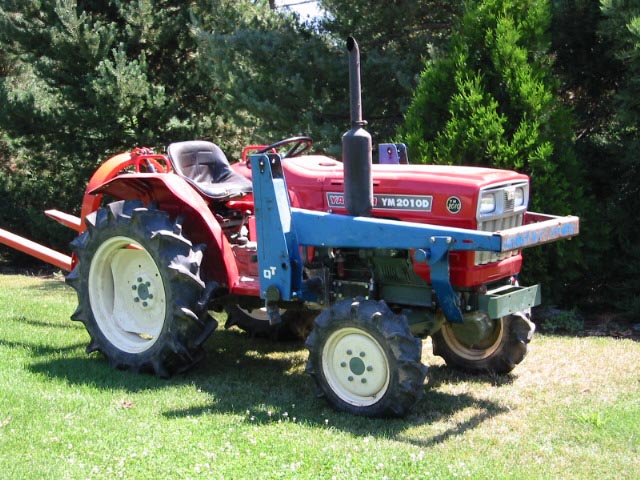

Here is another angle. I will post some more this weekend.
