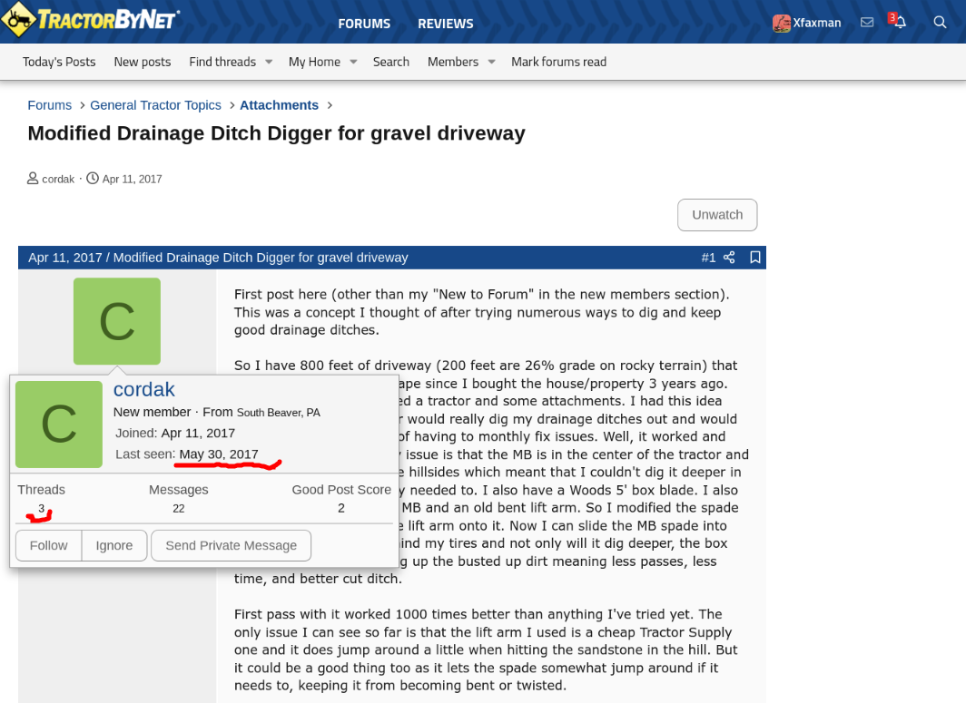

First post here (other than my "New to Forum" in the new members section). This was a concept I thought of after trying numerous ways to dig and keep good drainage ditches.
So I have 800 feet of driveway (200 feet are 26% grade on rocky terrain) that was never in any good shape since I bought the house/property 3 years ago. Over time I've accumulated a tractor and some attachments. I had this idea that using a middle buster would really dig my drainage ditches out and would solve half of my problem of having to monthly fix issues. Well, it worked and surprisingly well. The only issue is that the MB is in the center of the tractor and parts of my driveway have hillsides which meant that I couldn't dig it deeper in certain areas when I really needed to. I also have a Woods 5' box blade. I also have an old spade from a MB and an old bent lift arm. So I modified the spade and welded a chunk of the lift arm onto it. Now I can slide the MB spade into the box blade directly behind my tires and not only will it dig deeper, the box blade will assist in cleaning up the busted up dirt meaning less passes, less time, and better cut ditch.
First pass with it worked 1000 times better than anything I've tried yet. The only issue I can see so far is that the lift arm I used is a cheap Tractor Supply one and it does jump around a little when hitting the sandstone in the hill. But it could be a good thing too as it lets the spade somewhat jump around if it needs to, keeping it from becoming bent or twisted.
