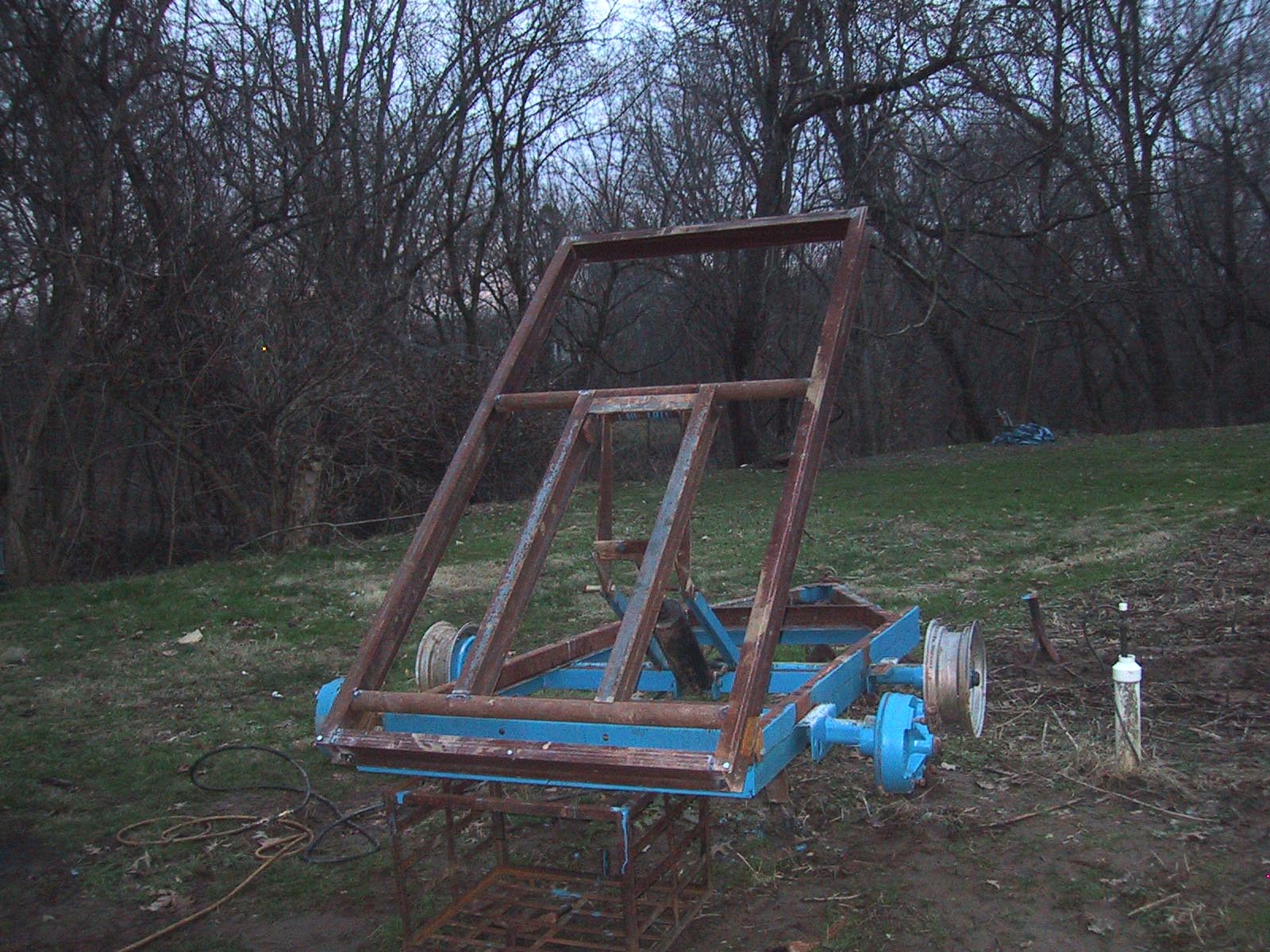

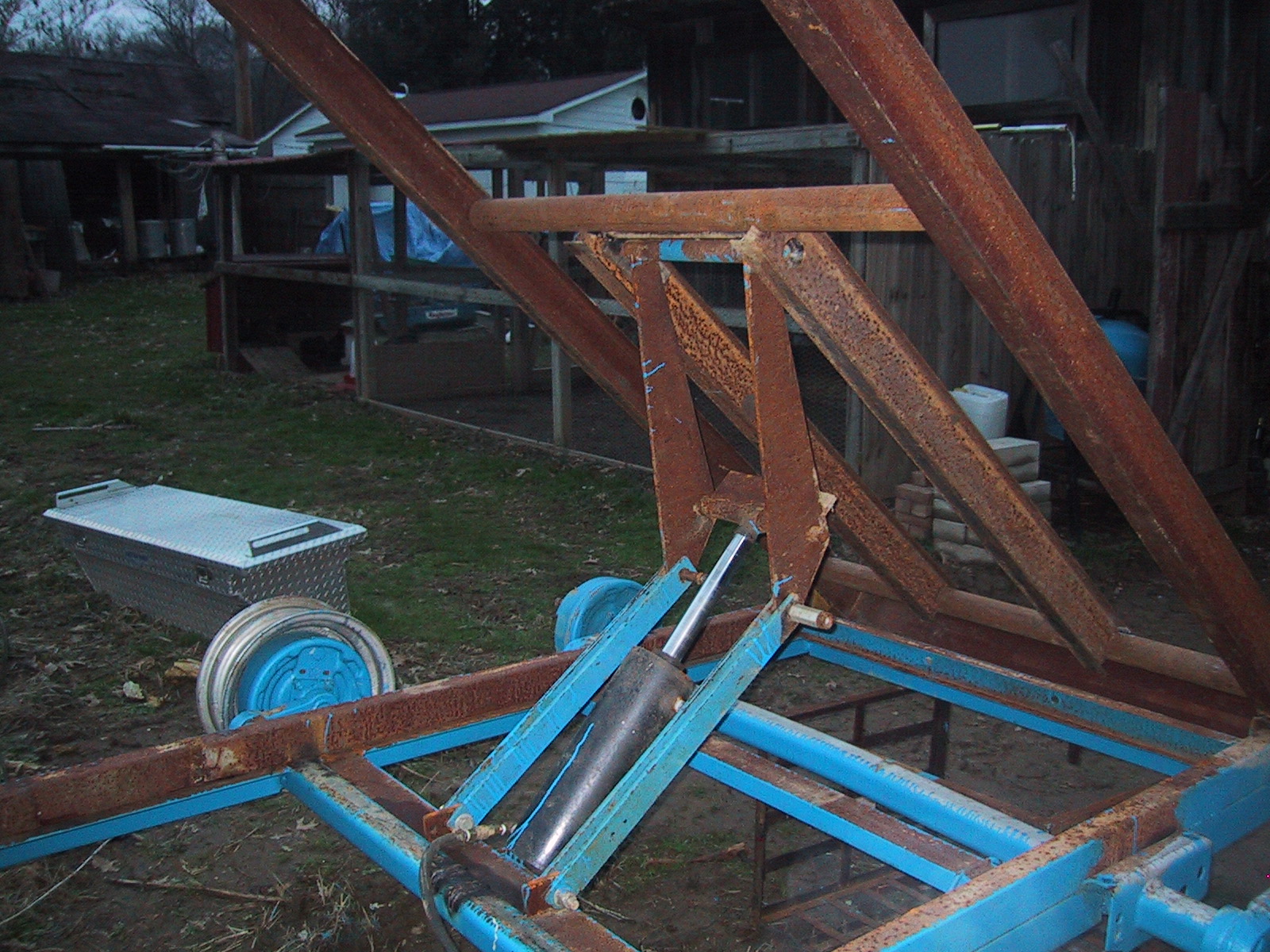

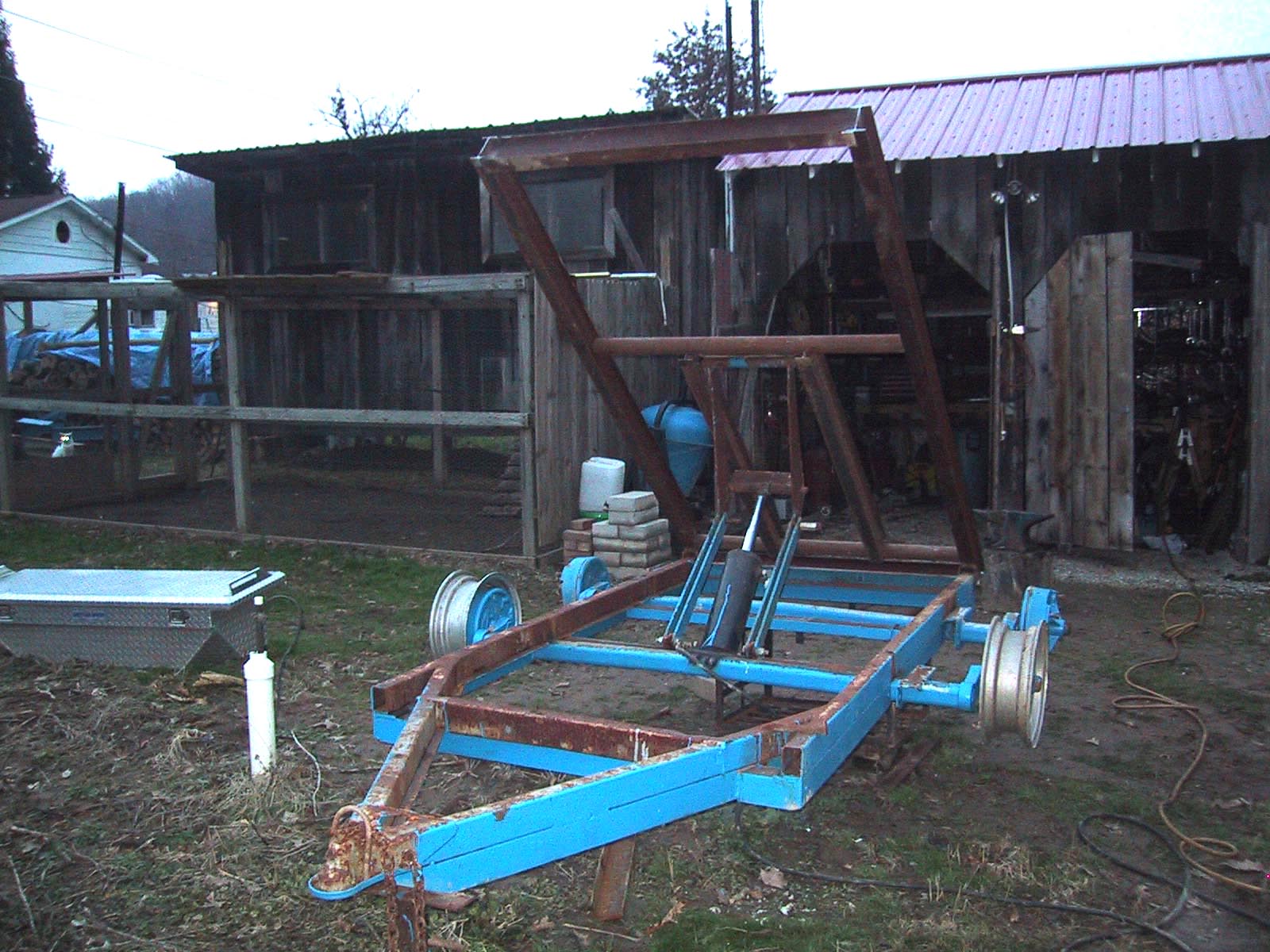

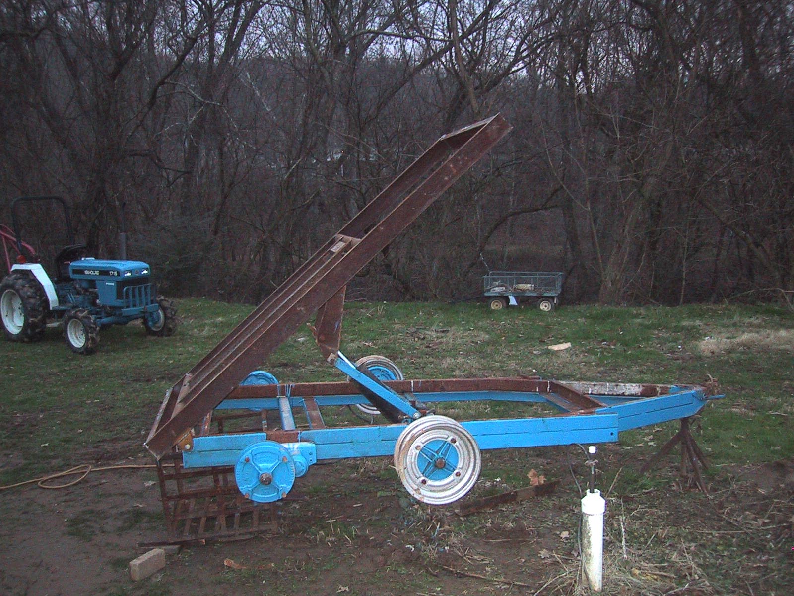

This is an ongoing project of mine.
   / modifiying trailer for dump action? #12
This is an ongoing project of mine. If intersted I can send measurments of mine.

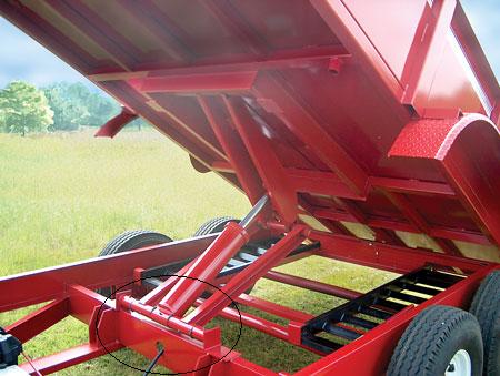

Whatever you decide, remember that horizontal placement of the cylinder requires a big cylinder and beefy hinges, and gives only a limited lift force where it is needed most: when the bed is horizontal. Then when it tips up, the cylinder gets more effective when the dirt is already starting to roll out, which means you loose a lot of speed to pump oil into that big cylinder.
The more vertical you place it, the more efficient the overall design, both mechanically and hydraulic.
Here is my dilemna- my scissor lift trailer will dump its 5 ton load normally with little trouble. However a few times the loader operator has dropped the load piled a little toward the front, or I'm nose down on a hill where I want to dump. The sizing of the cylinder and pump is right on the hairy (cheaped out?) edge of lifting when everything is perfect. So when front heavy it can't get the bed to rise without a little help, I usually use a Hi-Lift jack on a corner to get it going. Once its up 2 or 3 inches it takes off and goes fine.
My thought is if I cut the trailer end cylinder mount hinge off and reweld/remake it a few inches lower it should give it more off the line lift at the expense of a couple of degrees of ultimate dump angle.
Any mechanical engineers out there that can confirm my plan?;)
Can't use a bigger cylinder because there isn't room. I have considered installing a small "booster" cylinder vertically at the front of the dump bed to push that extra few inches to get it going. Cost is a minor issue here and all the extra plumbing into the hydraulic pump.
Below is a pic of a trailer like mine- the large "hinge" circled at the lower front is what I'm proposing to lower.
   / modifiying trailer for dump action? #16
Skyco,
given the geometry of your scissor lift, placing it lower so it doesnt reach as much of a dead end when lowered, would certainly make it easier for your hydraulic pump to punch out the bed from a dead start.
Just use a tape measure to measure the total expansion of the scissor lift, deduct the inches you want to lower the attachment hinge, then lower the bed to that length, to see if you can live with the dump angle, before deciding to cut up a perfectly good dumptrailer... ;)
   / modifiying trailer for dump action? #17
Skyco,, How many pounds of life do you think your appling with the high lift jack??? The reason I ask is a few years back I built a show truck with a air powered lift like yours.. but after putting the finishing touches on the truck it wouldn't lift the finished bed,,, I put a come along on my dear scales and lifted it untill the bed would move on it's own,,, about 200lbs is what it took..
The truck was done,,,frame was all clear coated and I couldn't move my pivot point with out a lot of redoing,,,Sooo to make a long story short I installed a set of struts to help with the first inch or so,,,Struts might not work for you but maybe some short springs near the front between the frames...
Just a thought,,,
   / modifiying trailer for dump action? #18
Skyco,
You can confirm it yourself by making a 2D scale model of each component's profile out of index card stock. Mark your pivot points with a dot then assemble the linkage by pinning all the attachment points together with common pins. A working scale model of the cylinder, since it telescopes as well, will take a little more work on your part. You can then articulate the linkage and adjust attachment points, etc.
