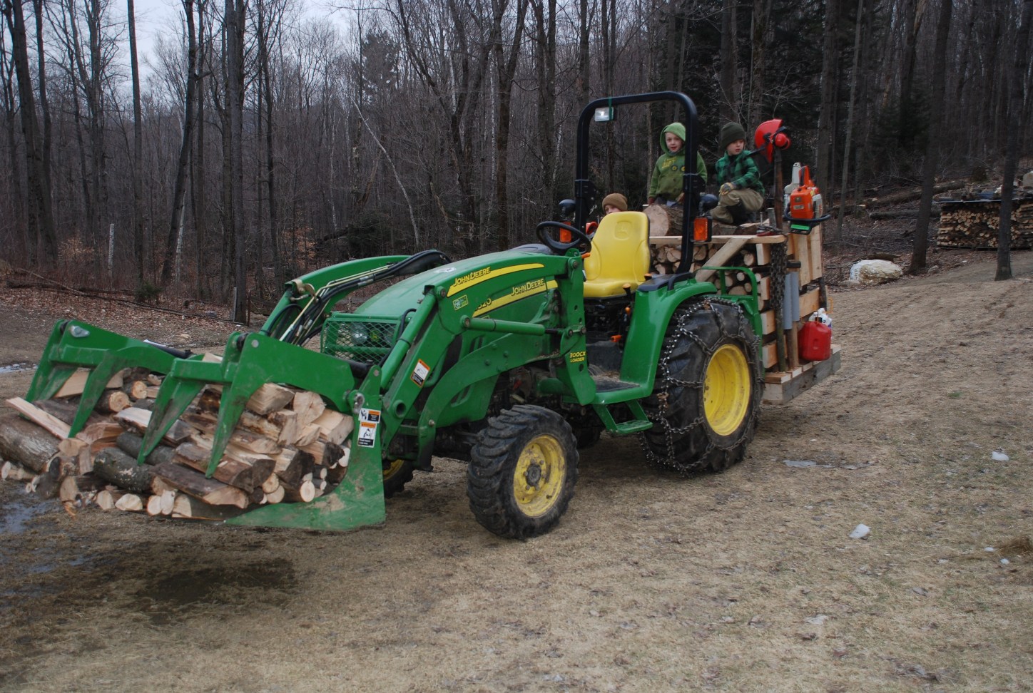

I would like to weld some pins on my FEL forks to pick them up with the 3PH and use this to carry a sap tank in the bush. I have carried a tank on the front (100 gal.) in the past with the forks, but this takes away rear end traction. Also, it is handy to have a loader up there to help out when the mud gets deep. This year we have a 200 gallon (1800 lbs full) gathering tank which would be too much for the forks. I also think I'll get stuck if I put it on wheels, so I thought to try the 3PH. The specs indicate about 2500 lbs of lift capacity, but at how far out? I will be pretty close to that load with a full tank plus the weight of the forks.
Has anyone done this? Where did you weld your pins and a bracket for the top link?

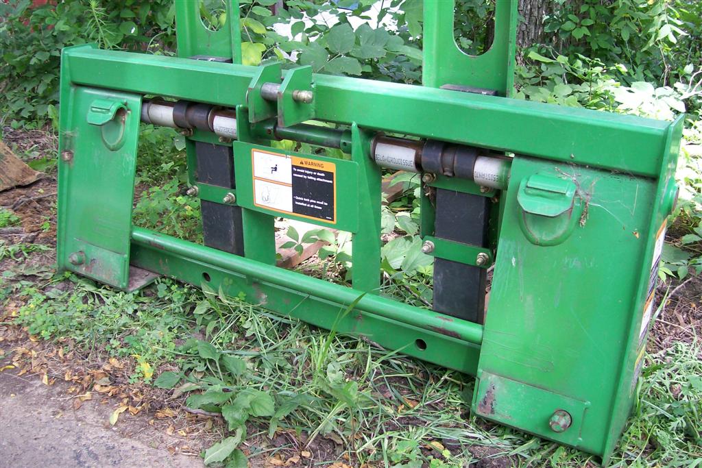

I did that with my JD forks, and pick them up with the iMatch.
Welded two vertical plates at the top to take a pin, and just a round bar across the bottom for the lower hooks to engage. Works slick (as long as I set it off on a pallet as I cannot reach the forks if on the ground)

Well, here is what I came up with. I did a test run today with a woods crate we built. That is 40 cubic feet of green sugar maple, which must run upwards of 1600 lbs. With the riders, forks, pallet, chainsaws, logging chains, mauls etc. the total weight is over 2000 for sure. This was a very heavy lift and the hydraulics were whining a bit to take it to full height. The good news is that this is more weight than the sap tank will be so we're in good shape. The center of that load of firewood is about 24" beyond the ends of the lift arms. Is this where the rated load is?
/ Modify forks for 3PH
You may need to keep a load in the grapple to maintain steerage in the bush....
Agreed. I would not want to drive on level terrain with the 3PH maxed and no load in the front. The front end felt different even with the load. I do not intend to put that much wood on the rear again...this was a test for my welds and such.

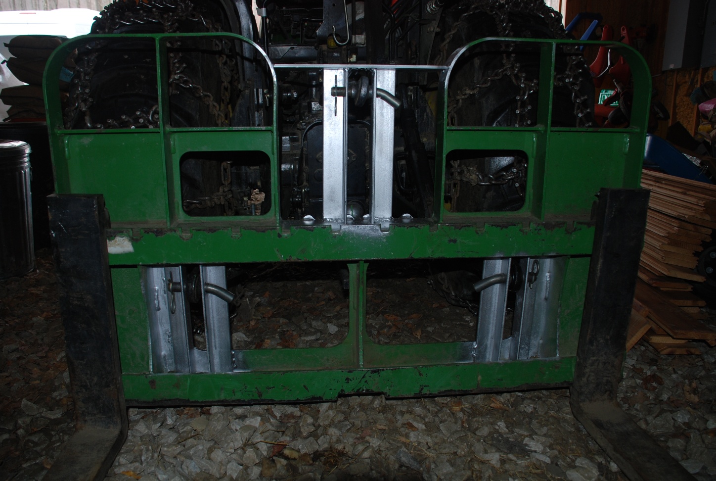

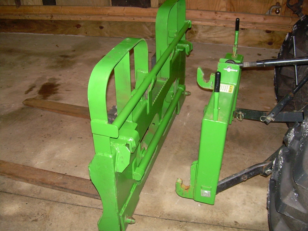

3pt forks are a match made in heaven for something like this application.
For OP that is a far better way to move the tank around, compared to out in front of the loader.
I did mine as well, just a little differently. coupled with a QH and a HTL it's the perfect match. Don't even have to get off the seat to grab the forks.

JB
Looking good there.
Now, add the hyd. top link and go beyond the "match made in heaven" :)
Tilt those forks much easier when backing into a pallet, or whatever.

JB
Looking good there.
Yup I have it now, wouldn't want to live with out it or the QH.

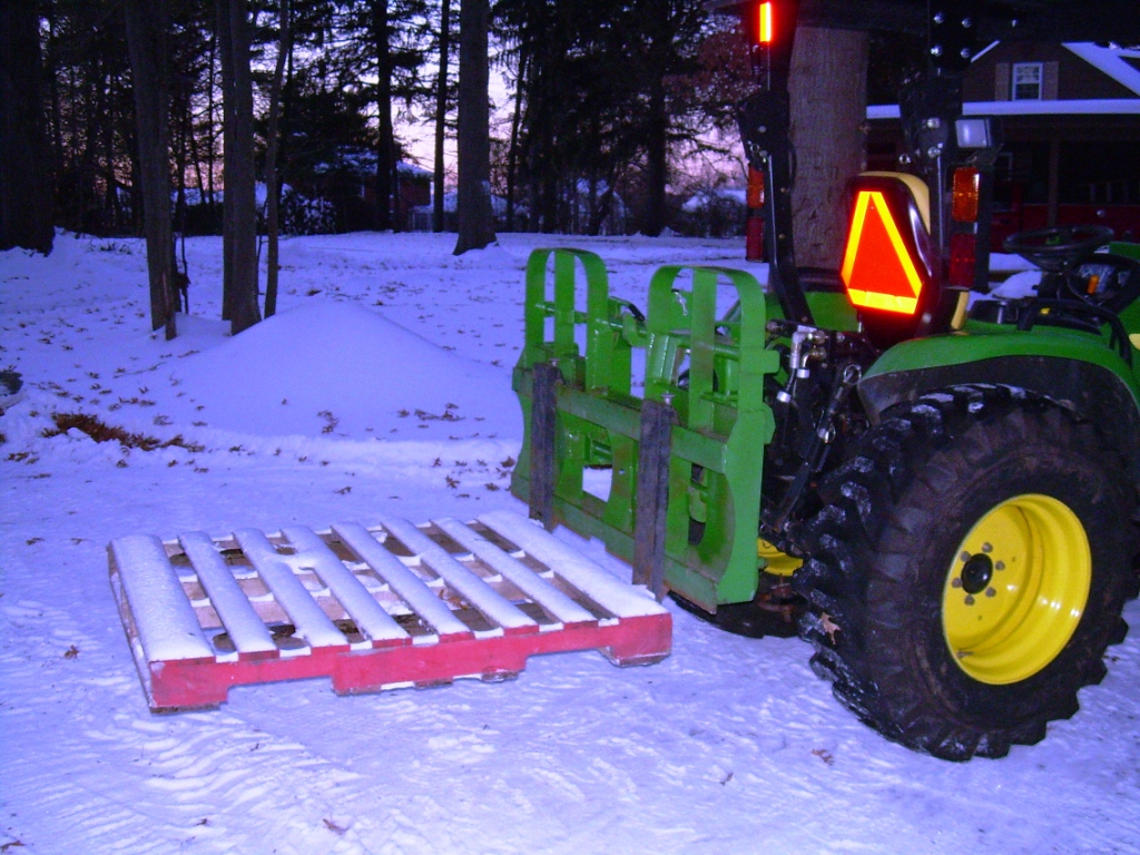

These toys look nice! I wish I could make one with one of the sets of my forks. I would prefer to have a Quick Hitch on the back of my tractor to do it and possibly a hydraulic top link. Put it on the back of my 5085M and it would be heaven, I would say. :thumbsup:
But I do prefer JB4310s the best. Not picking favorites but looks easiest to modify on my forks. If I put a piece of tubing behind the mesh I can get my quick hitch in and then add two more pieces of tubing where the forks are.
Not tubing, solid round bar. You probably meant that but just wanted to clarify.
I found the perfect fit at a scrap yard, the upper is a little smaller than the lower, but mine is a snug as a skeeter's tweeter.
JB
/ Modify forks for 3PH #19
JB
Does it not slide around? But it looks like you got something for the top of the bar, so a possible no?
