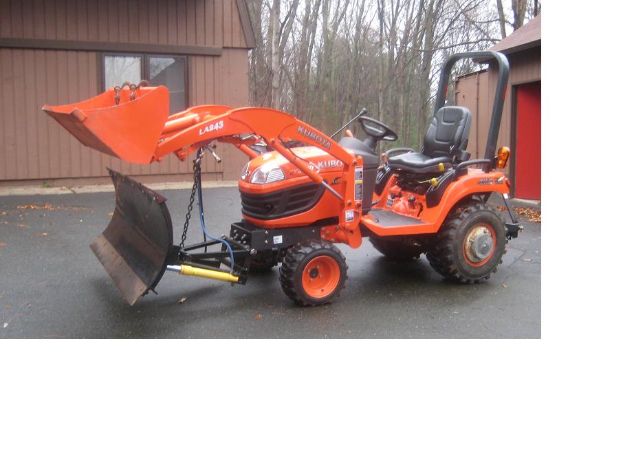

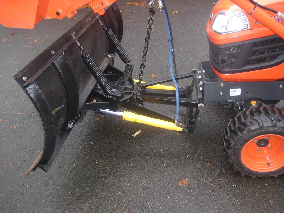

I took a 7' Meyers, cut it down to 67", modified the A frame and made a mounting plate to bolt to the front of the frame on my BX2660. I use the FEL to lift it and the bucket hydraulics to swing it. Also since the skin was rotted I bolted a 1/4" thick HDPE poly face on it. One pin, the lift chain and 2 quick connections and it ready to plow. Only takes a couple minutes to hook up and the FEL stays on the tractor. It works great.
