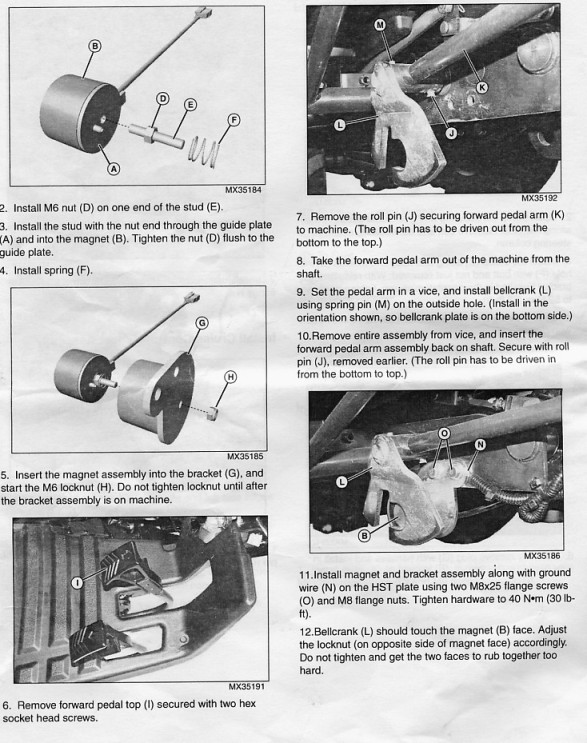

So I'm intrigued by this 2305 cruise control solution. Do you happen to know if it's available as an aftermarket add on? If so, how much is it? I would have to look at the 4105 linkage to see if it's a viable option or not....hmm.
The factory "kit" comes with a bunch of stuff you might not need or be able to use. I don't remember the cost, but the dealer wanted a bunch more in labor then the kit cost, so I put it in myself.
The bits and pieces might be available as replacement parts.
I'll try to attach a page from the manual.

I'm not sure if it will work on the 4105 but the JD part# is LVB24813. lists for 139.00

Thanks for all the replies from everyone...I appreciate the feedback and research. I've checked with two dealers in my area and it sounds like any type of speed control would be a very customized non-JD authorized add-on. Which of course I'm sure would void the warranty. I had the opportunity to demo a 4320 last night and I must say it's a nice tractor. It's far more than I need at this point....and wider than most of my 5' implements. Too bad because they have a very nice price on it. If I stay Green I will probably look toward a 3720 demo they have here.
