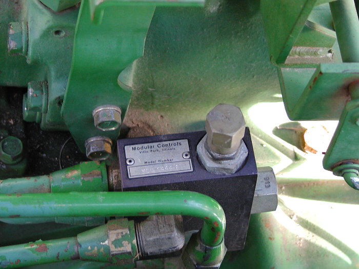

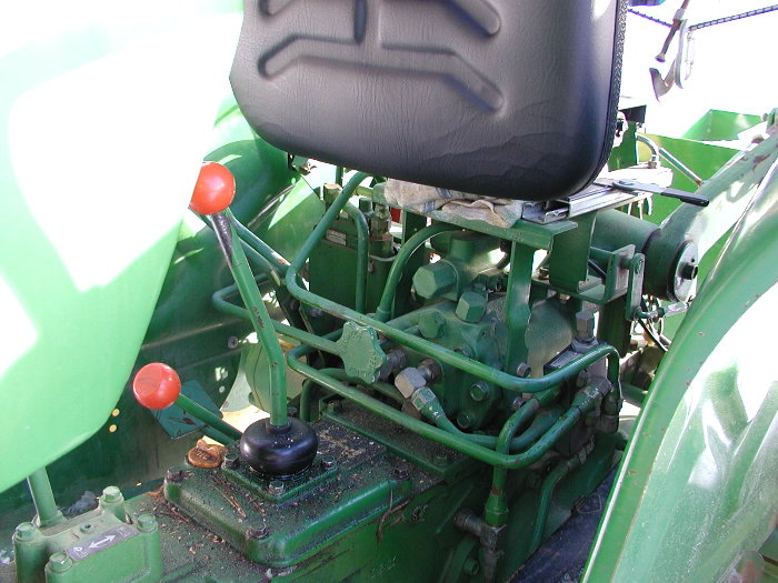

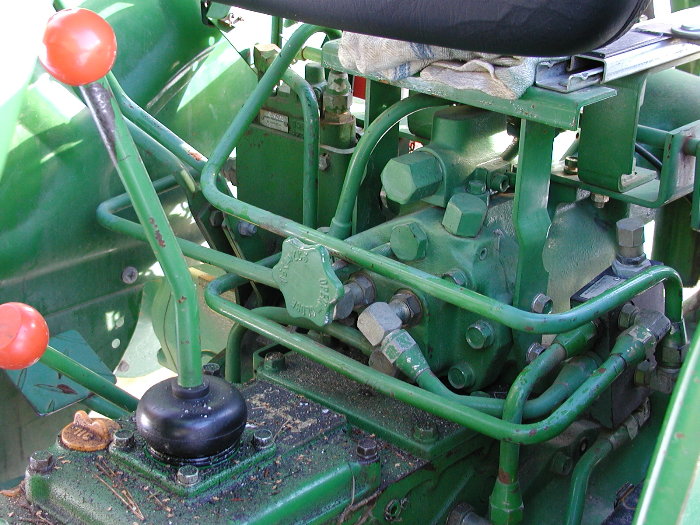

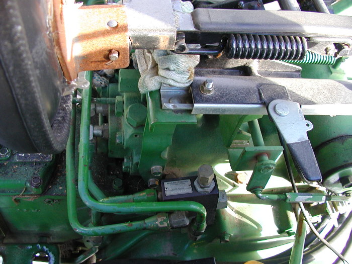

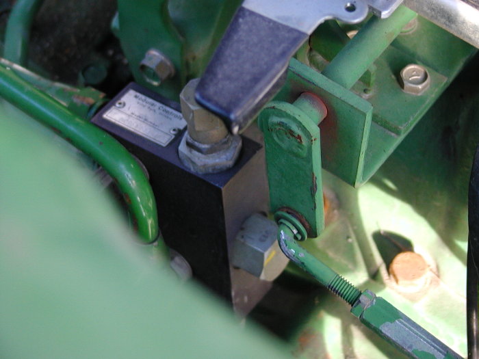

Can you guys help me out with the functions of this control. As you will see from the following pictures it is of course plumbed into the hydraulic system.
Two of the lines comming out of it run forward and feed the power steering.
2 more lines run over to the loader valve control and a 5th line runs into the housing under the seat.
Now, as you can see there are still 2 ports on this control that are not being used. May they can't be used !!!?????!!!
And then maybe these 2 ports can be used to help me add power angle to my snow plow blade. I really have No Knowledge of rear remotes. Is this considered a rear remote or is it just and strictly a part of the power steering system ??

The top cap looks like a pressure
relief adjustment.
The 2 lines that go to the loader are what
u need to tap into for remote.
Take one of the lines from loader valve and
reroute (hydraulic hose) thru your new valve
for remote then back to the modular control.
U will need an open center valve for this.
Which ever valve u want to have priority(sp?)
will be the first one to get flow from modular
control.
So if u want loader to have priority install remote
in return line from loader.
