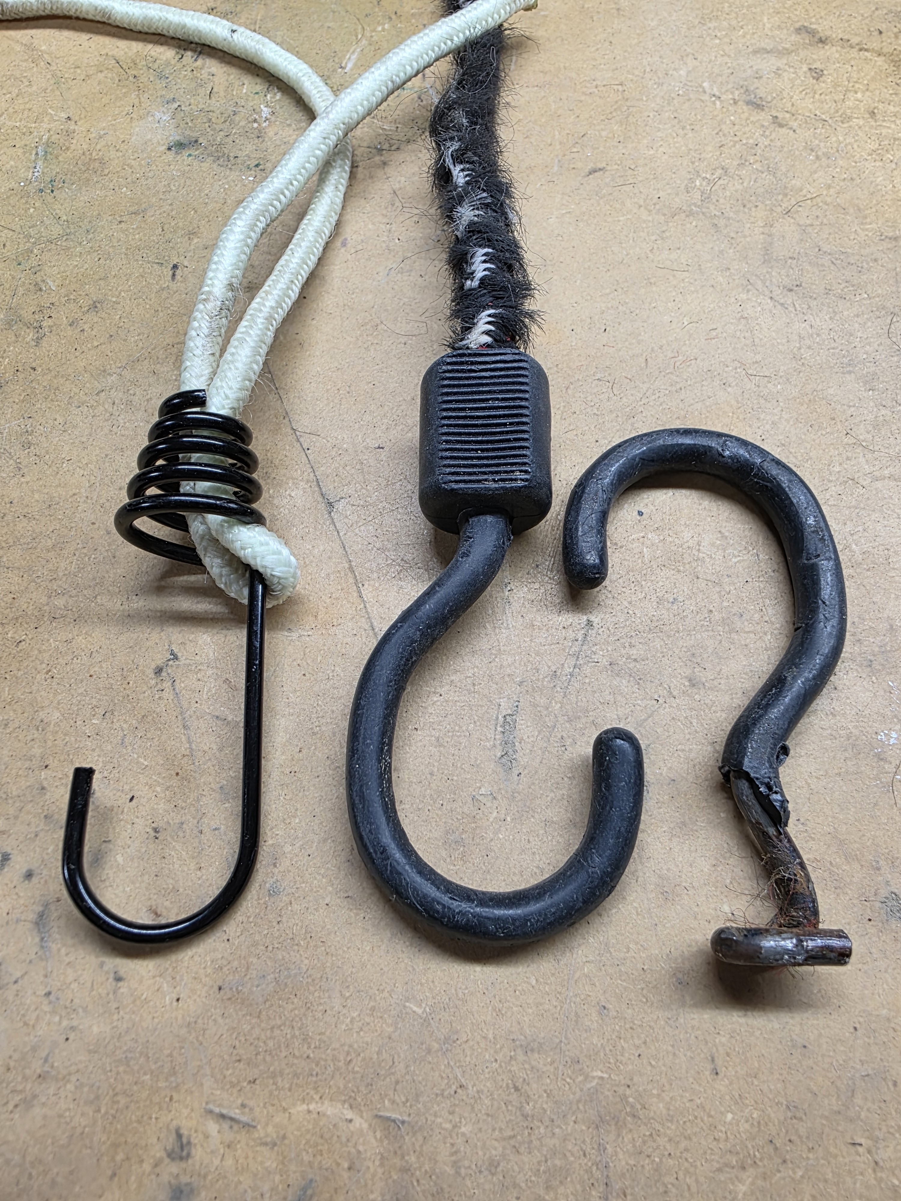

I like to repurpose elastic bungee hooks. I usually buy the one's with wire hooks but had this one around with the heavy molded plastic hook covering where the elastic fastens. It was worn out so I took a saw to it to see what was what. Not worthy of much.
With the wire hook type, if I get a weak spot, I cut the elastic and secure it with a wire staple just like new. I use the poly/wire for electric fencing. I save the old wire hooks and as demonstrated in my photo, loop the wire rope through instead of gate handles for temporary fencing, etc.

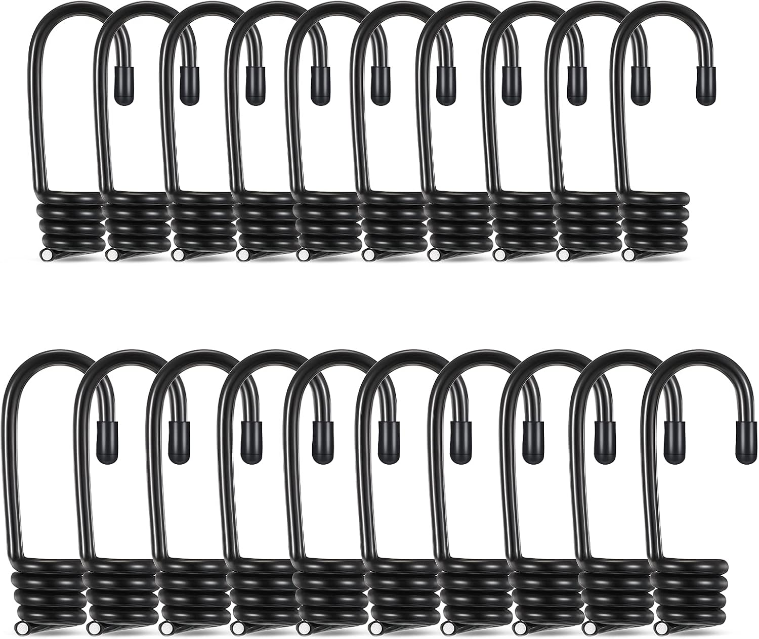

I keep a supply of those hooks around:
Like you, I cut out the weak spot in the damaged bungee and put a hook on either end to make two shorter bungees. I hook them together if I want the same original length.
Bungees used to be cheap as dirt, but like everything else, the prices are going up. Makes perfect sense to repurpose or repair them.
