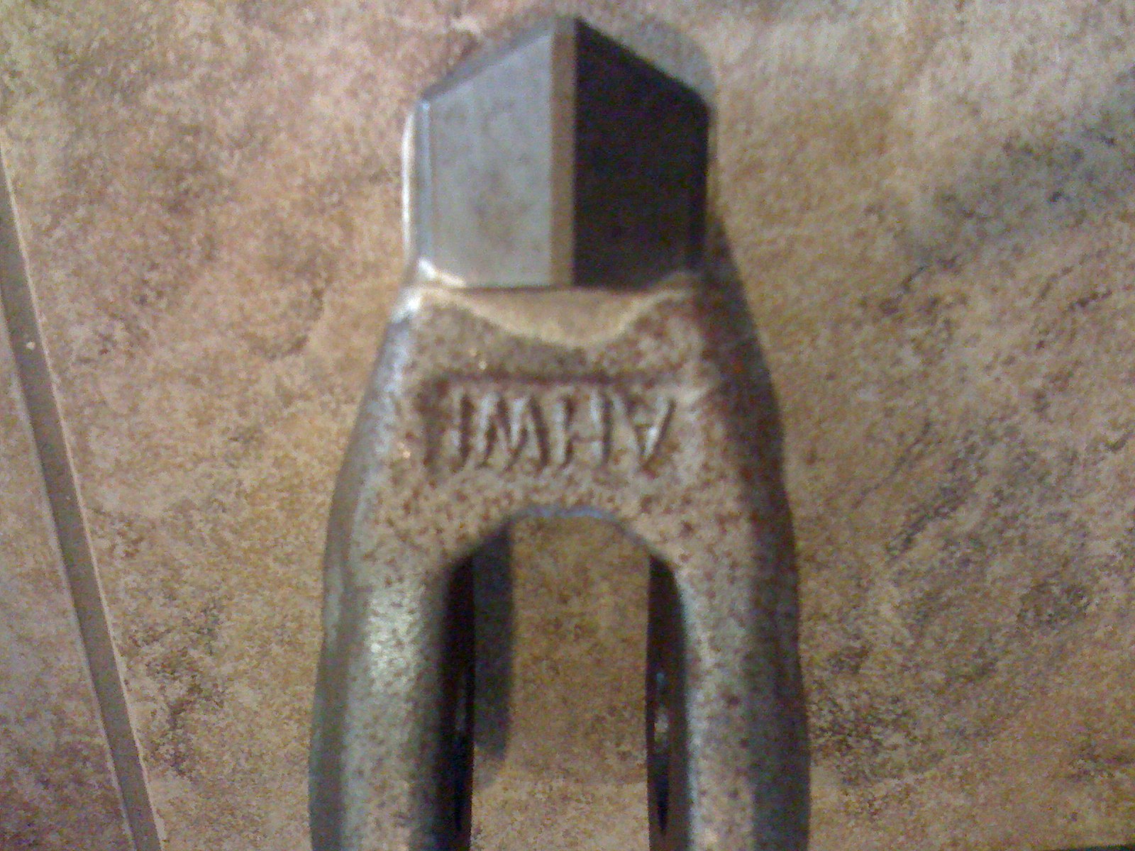

The new rock teeth got here todayn now I get to change out 48 teeth. I'll let you guys know how these things work. i can not get the picture of the tooth to load...i'll work on it
