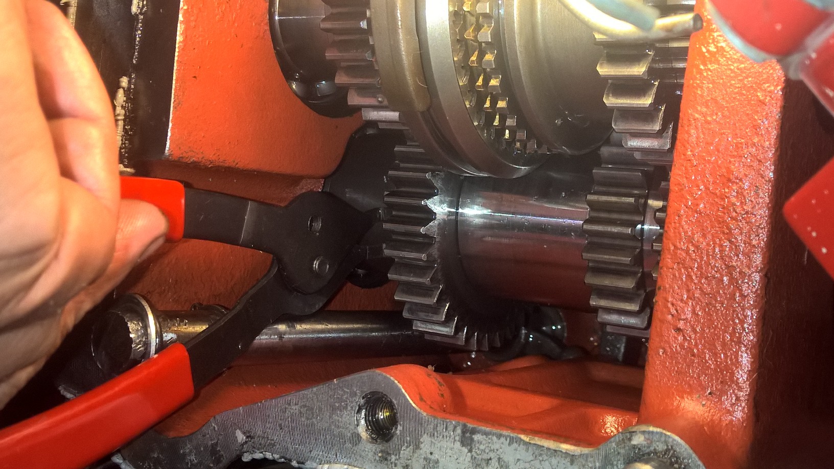

I have the sliding gear, synch shuttle transmission that has the 12 forward and reverse gears. The problem is that it shifts really hard between forward and reverse (not the different gears) and actually got stuck in forward the last time I used it. I can't find a service manual yet online either. If anyone here owns this model and has similar problem, how did you resolve? I can't even find a transmission dip stick to check fluid.

4:roll your main gear shaft until you can feel the snap ring come TDC on the leading gear #34 on the print comes to the top dead center. LOCK TRANS IN GEAR.
Now either use 90 degree snap ring pliers or outward snap pliers with paddles that can release this snap ring. its a biggy no cheap tools with survive...use the good stuff.
5: after you release this most forward snap ring on your main shaft your gear 34 should advance forward. use brass as your persuasion...your internal any these gears will chip with steel hammers so use brass round bar to bring this gear forward toward the front of trans. just bring it up 1/4 inch.
6: go to your broken F-R shift shaft item #11 on the print clamp on with vise grips (broken shafts will vary) so grab toward the top.
wiggle the shaft upward by hand out of its machined pocket lift upward 3/4s of a inch and roll the shaft a little more than 180 degrees more like 270.
SHIFT TRANS INTO NEUTRAL AT THIS POINT.
7: bring the broken shift shaft upwards the shift selector ball #7 is roll pinned on to the shaft 11 and it needs to be brought upward until it is centered in the gear 34,,Now hand roll the main shaft so the the shaft and shift selector #7 feeds inside the gear cog between the trans case wall and gear there's only 1/4 inch clearance here and your shift selector will use all of it rch clearance. half of your selector will be in the gear cog and half will be scrapping the trans case wall as it comes out.
