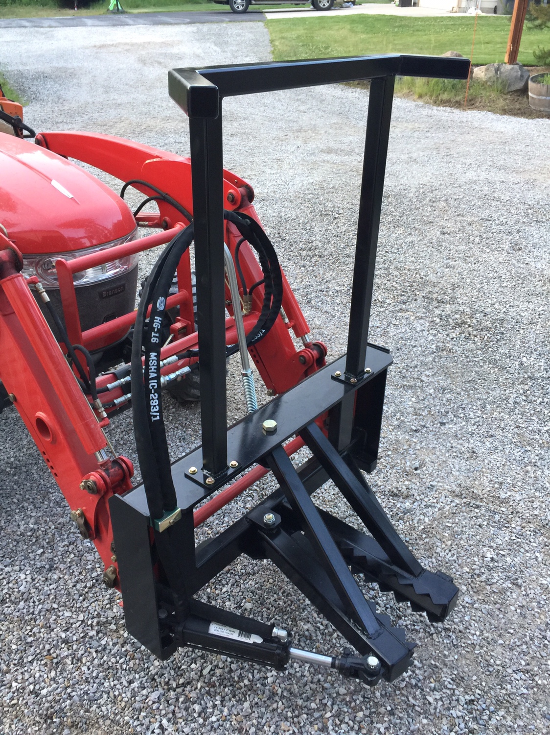

I pluck the saplings and make piles here & there then I come back to cut the stumps off before feeding it to the chipper. You should get a tree puller. It’s a whopper of a time saver and I don’t have to deal with the stubs. Pluck, move, stack! I ought to make a video if you’d like.

Interesting! I do just the opposite - I go in and cut the saplings down and leave about 12-18". Then I go back in with my tree puller and yank the stumps. I would think that I'd get tangled up trying to cut a bunch of root balls off the trees laying in a pile. Plus, it's easier to handle the stumps with the puller when I don't have a bunch of "length" of tree hanging out there.
Just curious - what kind of puller do you have?

I’ve thought about, and tried that approach what you go but quickly found that it isn’t feasible because now I have 18” stumps blocking my tractor from moving around AND making removal of the saplings by hand quite difficult to pull out. Don’t forget that they make “head knockers” (infant widow makers) when they hang up on other trees if you’re cutting a bunch at a time. At least mine are because I have dense stands. I pluck & pile them in manageable groups with the roots facing the same way towards ample clearing where I can chip comfortably. I cut the stumps most at once and toss them in a pile for later pick up then have at it. No widow makers and I don’t have to collect the stumps.
The tree puller is what I built myself.
