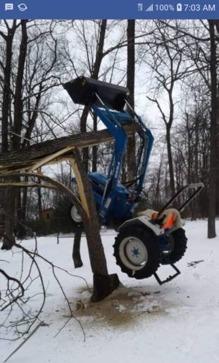

I have a family member who has a tree leaning over his house that needs cut down and wants me to use my tractor to push it away from the house while he cuts. Is there anyone out there that has expierence pushing over trees with a tractor and which attachment will give me more pushing power fully extended at maximum height, the loader ot BH. I know I am the one ultimately responsible so any answer is "off the record" Twould be nice to somehow rig up scales to push against up there but that's not practicle. Any input will be appreciated and will be taken under advisment.

Pushing up high....if you don't have enough push....or if the tree breaks loose at the stump before it's "over center" it can come back on you. Or you can force a barber chair like in nings pic.

No one answered because it is an impossible question to answer. Too many variables with the backhoe.
Even the loader has variables that can make it a crapshooot.
IF the loader bucket is curled too far back....as the tree starts to go over the tractor bucket will simply ride up the tree...then the only "effort" you are imposing on the tree is the weight of the tractors front end. Which wont be much if the backhoe is still on.
The backhoe.....how are you pushing....with the backhoes hydraulics? OR raising it all the way like the loader and backing into the tree?
A backhoe all the way raised and dipper full extend has little push. A lower height and combination of lowering the boom while extending the dipper has ALOT of push force. (think like you are pushing a spoil pile back from the machine). But this is at a lower height. So the backhoe is capable of more push....but the overall effect of leverage is it really more on the tree?
The "most" force is gonna be the backhoe pulling.
And since the loader only goes so high....get a chain or cable HIGHER than the loader can go for more leverage. Long enough to get away from the tree. Plant the outriggers and pull with the backhoe hydraulics. That will be the greatest force.
BUT, you have still yet to answer the simple question of how big the tree is. Sorry...."skinny little pine tree" doesnt qualify as an answer. IF this is a 15' tall 6" diameter white pine a SCUT could push it over and you are here with a big 55hp utility with a backhoe asking questions?
