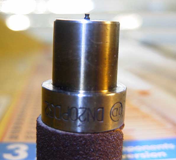

The injector nozzle part number for my Kubota Grand L-3130 D-1503 engine model is #16082-53610 and it is a super simple low pressure (40 Mpa or about 6,000 psi, one MegaPascal = 150 psi) IDI pintle nozzle design with only one hole of yet to be determined diameter.
This makes it much less of a hassle since it does not have multiple holes (making the precise spatial geometric orientation a mute point) and NipponDenso makes an entire series of screw-on single hole pintle injector nozzles in 5 micron increments, i.e. a 150 micron, 155 micron, 160 micron, 165 micron, etc. each nozzle producing more hp and torque as the opening is enlarged.

Attached is a closeup of the primitive low pressure IDI Nippon Denso (Diesel-Kiki) nozzle design.

Commonly, diesels have approximately 5 degress retarded timing to account for a decrease in NOx emissions these days.
However, all you have to do is increase the injection nozzles orifices diameter a couple of microns to add mucho horsepower and gobs of torque, either that or increase the crank injection window a couple of degrees to prolong the injection event.
Installing a new injection nozzle onto the injector with larger nozzle orifices is a super simple ten minute job and works excellent. There is no need to tweak the fuel injection pump or add more injection pressure with either of these methods.
Problem is they both increase the EGT under load, smoke alot more, and violate emissions laws, but the power output increase is spectacular. /forums/images/graemlins/wink.gif
just remember that if you just add a new nozzle tip to the injector body, you really should have this done by someone that can pop test the injector afterwards, else they may not pop at the same pressures and this could cause a bit of lumpiness..
