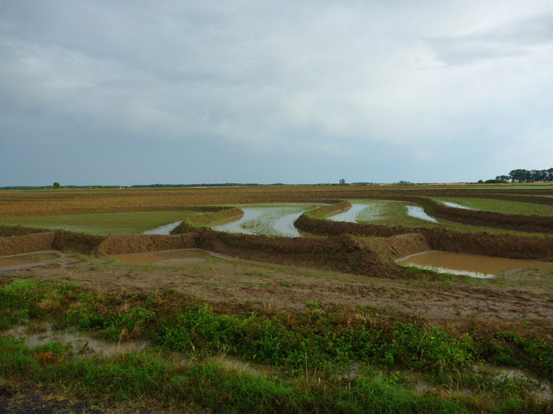

Speaking of rice paddy's, I don't really know what they look like.
I took a picture of what I thought MIT be a rice paddy, when I came across one on an off road motorcycle trip halfway across the country. Is this a rice paddy?
   / More people buying utility sized tractors? and why? How powerful can CUT's get? #49
That is pretty typical of what a rice paddy looks like.
